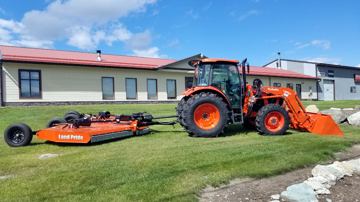

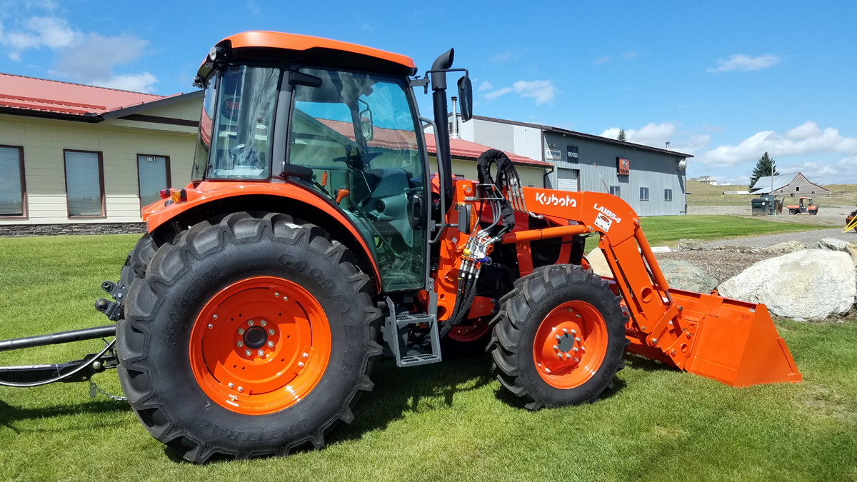

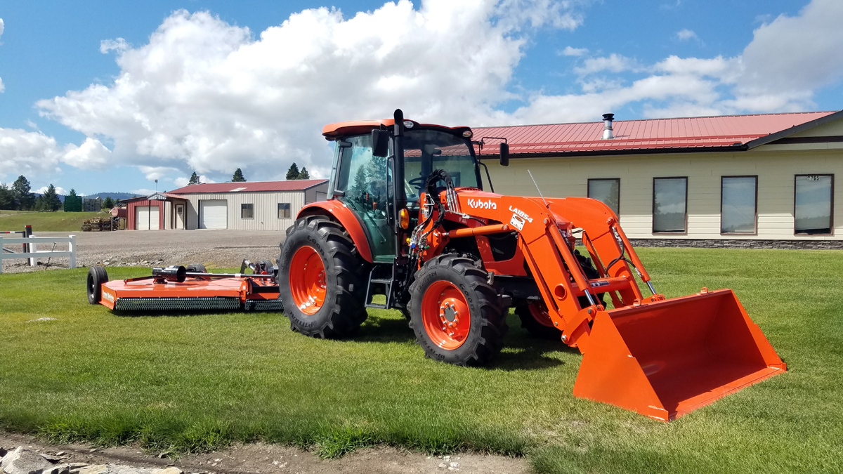

There's an M5-111 outside the local dealership and it's a beast! I'd love a tractor like that but couldn't come close to justifying it for my property and current uses. I've driven an even bigger beast in the form of an M6-141, another tractor I'd love to own but it falls into the same category of being way too much.
This is the M5-111 with a Land Pride rotary cutter .. simply amazing!!
