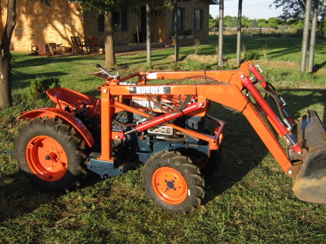

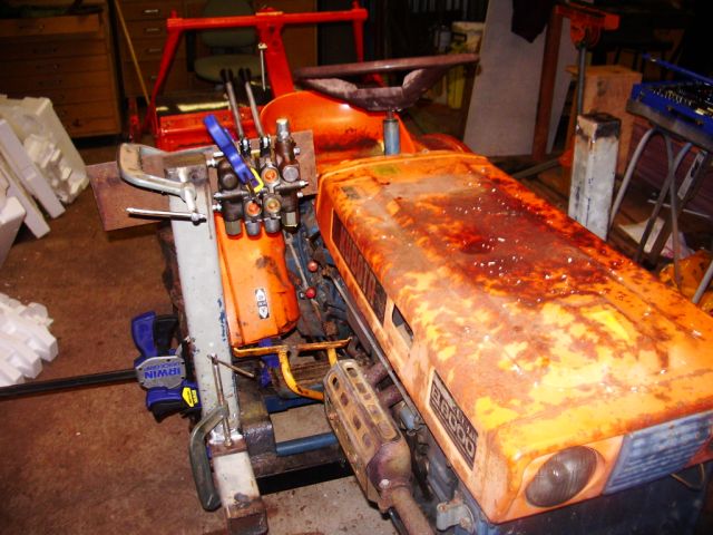

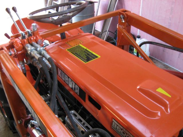

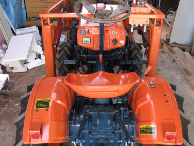

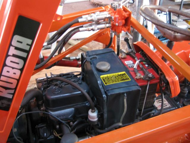

Well its finally finished :). Its taken awhile but the little beast is now all painted and put back together. I think it turned out alright.
Also put new tyres all round. 7x16 on back and 6x12 on the fronts. I previously had rice tyres on and these new R1 lugs make it run soo much smoother:p
I think it looks pretty sweet with all new decals. Now all I need is a new steering wheel!
Some pics attached along with a before shot!
Cheers John

That is some fine looking craftsmanship, everything came out looking spot on!
Well, except for that steering wheel you mentioned. It's really not doing any of your hard work justice :p

Topgear I have to say that thing does look good. How much weight is the bucket able to lift safely? I am curious you have really done a great job on the bucket and frame attachment. I am curious about the weight and height. Again looks good. handy

Hi Guys
Thanks for the kind words and thanks for everyones help earlier on. I couldn't have done it without the help and advice from this list.
Regarding lift weight about 200kg lift capacity. It handles full 44 gallon drums which was my goal. However I need the weight on the back which is pictured in one of my earlier snaps in this thread when lifting around this mark.
I'm keeping my eye out for a new (or newer steering wheel):D
Cheers John

Rob
B6000DT / B7100DP /B8200DT/L225/Globe PTO Chipper/Lewis Backhoe/huxley TR66
Nov 22, 2009
679
9
Leafy England....
yep, i used compression fittingson my install , work just fine with not a sign of a leak anywhere.
you can just see one of the connections in the bottom of the pic below, thats the hydraulic line going onto the 3pt hitch, i just cut a small section out big enough to allow me to get the two hydraulic lines and fitting connected up.
also replaced the twin bucket rams for a single item,also works well with no probs at the moment.
rob
dookanooka
B6000
Oct 25, 2009
25
Australia
Very pleased to hear I don't need to braze, thanks for the tip, it'll save much pain!
Nice loader there Rob. It looks like they'll help me putting all the hoses on it too. The 'P' I notice on the control valve. Mine has that too. Should that then go the side closest to the 'P'ump and the one opposite on the rear side going to the oil reservoir I guess.
thanks,
Ben
