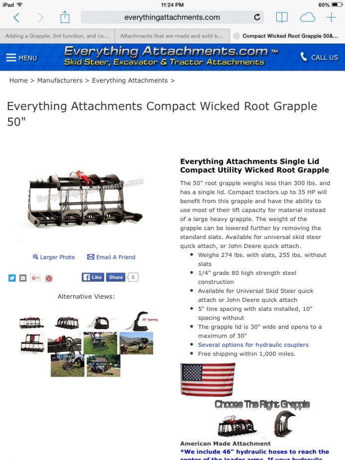

I've been looking at a few models everything attachments has, they seem pretty heavy duty with a lot of thought into their engineering. Prices aren't too shabby either. I'm thinking the 54" would be perfect, price is $2k
http://www.everythingattachments.com/wicked-root-grapple-by-everything-attachments-p/eta-wrg-cmp.htm

I would look at everything attachments's single lid 50" grapple that is designed for the compact tractors. It is approx 100 lbs lighter, which can be significant in terms of adding capacity. It is extremely well built, and has taken some serious abuse. We wrapped a chain around the grapple to lift over 1500 pounds last week with no problem.
