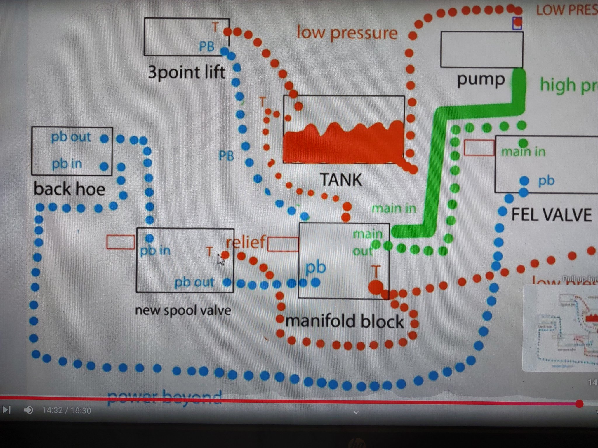

I have a L3901 DT and added Summits 3rd function and rear remote kit a year or so ago, but now bought a backhoe and need to hook it up for continuous flow. So that means I have to run new lines somehow. All info that I have found show adding 3rd function and/or rear remotes after having lines run for backhoe. From what I understand the backhoe should be last in line but all I have seen show it differently. ( not last in line )
I have searched and searched, watched videos etc and struggling understanding the entire system.
That being said, something TheOldHokie wrote struck a chord. He said "The T port on the Summit 3rd function valve can be used as is for the power beyond feed to your remotes. Its the exact same setup as Landpride OEM."
I have the valves on the rear of the tractor, with a P and T port plugged ( other end goes to 3rd function IIRC ). So can I connect the backhoe to plugged the T
port and it work with no issues? Where does the other line go? ( apparently the T will feed the backhoe, so need to know how to get it back to the tank line ) Apparently since it runs through the valves in a open system it will never be dead headed?
I do realize I may be ( probably ) completely misunderstanding this, I am ( was? ) quite mechanically inclined, but just cannot wrap my head around this

There is also a video showing the backhoe first, before rear remotes/3rd function. Wouldn't this make the downstream stuff not work since the backhoe ( apparently) is a closed center system? Downstream stuff would work if I disconnected the backhoe and then connected the 2 lines, right? And the backhoe is not last in line as is repeatedly recommended
9,169
4,777
Assuming BH77 its a simple two hose change.
  1. Disconnect remote valve power beyond hose at tractor outlet block and connect to backhoe supply.
  2. Connect backhoe return to tractor outlet block.
When backhoe is not mounted the supply and return lines MUST be looped together

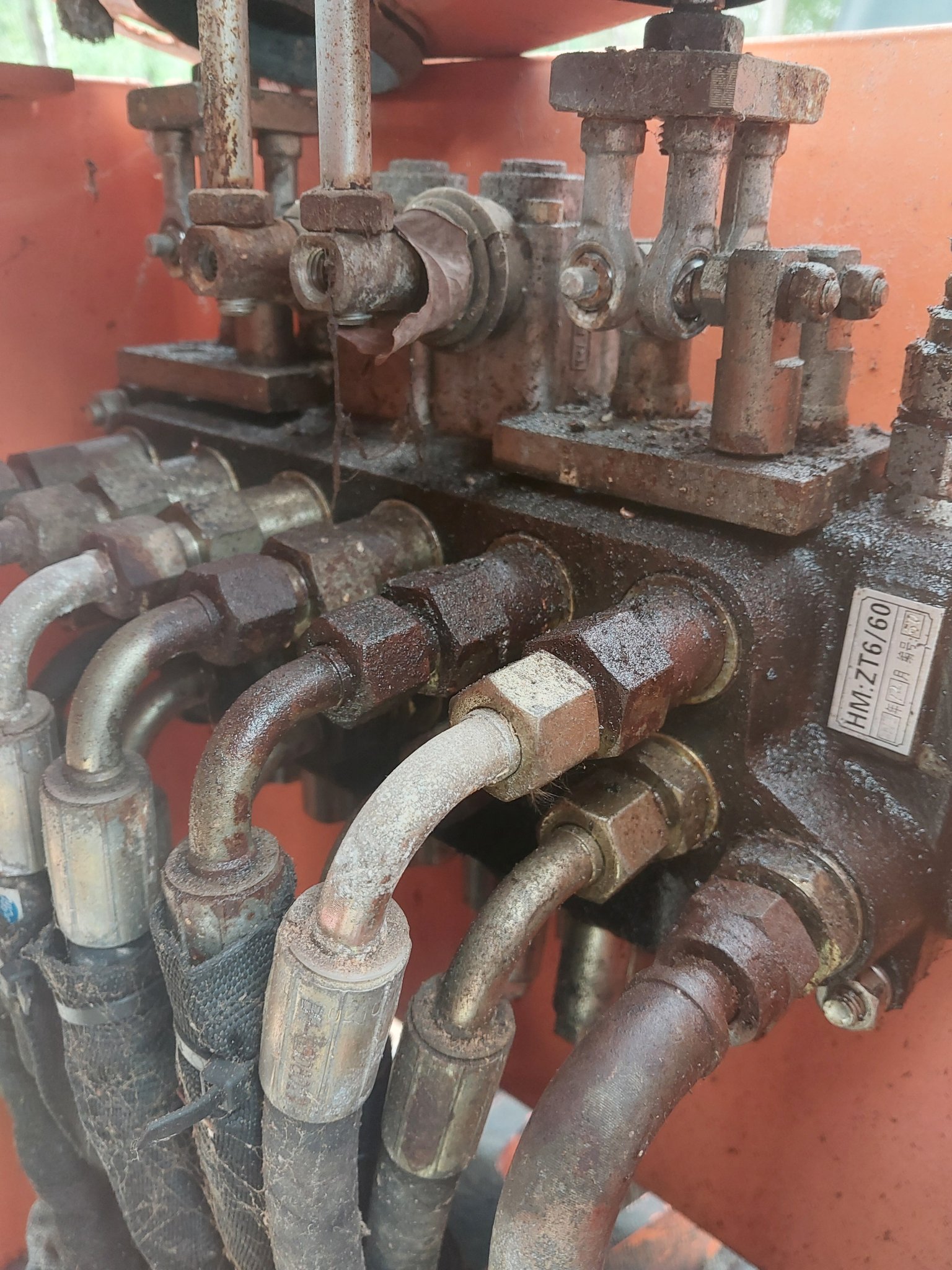

Unfortunately it is not a BH77, it is an aftermarket backhoe. I have no idea if they work the same, maybe bh77 is set up for open center system? I have no way of finding out if this one is. It also has ( currently non functioning) pto pump on it, so assuming it's not open center )
9,169
4,777
Then you need to identify the connections to the backhoe valve.
My guess is almost surely open center without power beyond abd connects just like a BH77.
9,169
4,777
I don't see any markings like P or PB. Can't find info in a search for HM:ZT6/60 either.
Look at the hoses going to pump and reservoir. One hose from pump and one hose to tank is my bet. Since its self contained wirh its own pump there is no need for a separate power beyond circuit.
If you are going to use the tractor hydraulics those two hoses will go to the tractor as I described earlier.

The hoses have been disconnected from the pto pump by the seller, years ago. There is one hose coming off each side of the valve, one with a male quick connect at the end, the other with a female.
miket1
Kubota L3901
May 10, 2024
47
49
Texas, Arkansas
One connection on the pto pump is open, no hose. I am sure the pump has gotten dirt or water in it and is bad. I wasn't concerned about that since I planned on using the tractor connections
9,169
4,777
Like I said, open center with pressure IN and TANK return connections. Thats the same as a BH77 and you would plumb it the same as a BH77.
