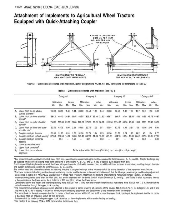

Actually its the hitch that doesn't fit the implements !
While it's CAT1 to mount onto the tractor, it is not CAT1 on the implement side.
Cat 1 is 26" spread on the lower arms. ... QH05 is 28" to 32" depending on how it's actually measured.32" is a CAT2 width.
What you really need is a 'proper' Quickhitch that is CAT1 on BOTH tractor AND implement side,WITHOUT any adapters or bushings or other bodges.
Yes, someone makes them, maybe SPEECO ? Sadly the sellers seem to just look at the tractor side of the hitch.
I'm sure someone will post a link to a quickhitch that IS CAT1 in, CAT1 out.

What are you talking about????
A QH05 is 28" center to center so 26" inside to inside .
So it's CAT 1 not CAT 2
