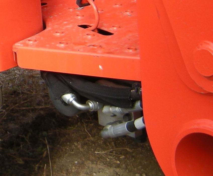

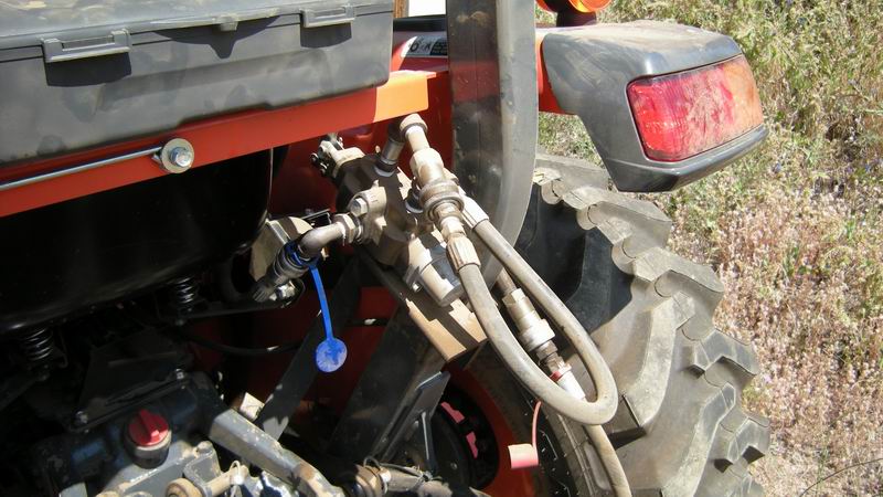

In the photos attached you can see what I got for $500 from the dealer. The two quick disconnects and hose. Another photo shows the hydraulic block that feeds the FEL control. The two hoses that have cloth jackets are the ones going back to the rear quick disconnects. One of them comes from the OUT side of the FEL valve, the other ties back to the manifold block. Most likely the drain line.
So $500 bought me a long piece of hydraulic hose and a couple of fittings. I'm hoping others have done much better.
The third picture is what I have now - it cost about $200 for another couple of sets of quick disconnects, and a valve. If you need more controls, you just need bigger valve blocks. I can still plug my backhoe hydraulics in series with the valve.
