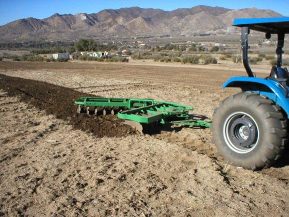

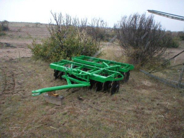

Off set or tandem? Light weight or heavier? What size pans? 3pt or pull?
I have an old JD-Kielfer 8' offset pull disk with 22" pans, in soft soil pulling axle deep there are times that it will stop my 75hp tractor. This disk weighs around 2000lbs. My thinking is that you should stay with a 6 footer, but lots of variables to consider that can change that. ;)
