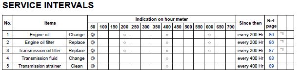

I know this question must have been asked a 1000 time before but....Which is the correct recommendation for servicing the transmission....Change the filter & clean the screen.....but what about the fluid ??? - Thanks
UpNorthMI
May 12, 2020
850
566
Up North, MI
The normal transmission fluid replacement is 400 hours, the filter should be replaced at 50, 200, 400 etc hours. When you replace the filter you will need to top of the transmission fluid.

Pre BX23S models called for trans fluid change at 50 hours. The manual for the BX23S only calls for a filter change at 50 hours. I changed my fluid anyway since theres only a couple gallons in there. Cheap insurance! I notice your screen name.....must be a lever gun guy?

Again, Your service manual says filters only. Never heard of a vehicle manufacturer recommending changing the oil so soon or just filters only but the fine folks at Kubota do. Plus, we are talking about transmission fluid verse engine oil, big difference.
I only changed the filters and topped off with the correct fluid at 50hours, per the manual. Just did the 500 hours service a couple weeks ago replacing fluid and filters.

I believe the question at-hand is WHY Kubota would change filters at 50 hrs but no longer require fluid as-well.... as they did with previous models.
I think the reason is: With the use of Super UDT which is a longer-lived fluid due to it’s synthetic make-up there is no reason to change the fluid so early in the tractor’s life. But the manufacturing process introduces the possibility of gasket-material, machine-filings, and other debris which may have circulated in the early-life of the tractor which the FILTERS will catch. Changing those filters removes the possibility they might be overloaded and gives the tractor good filtration until the next scheduled change.
