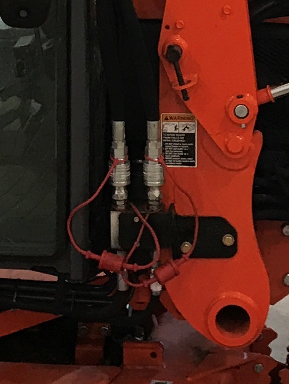

I got the 3rd function remote on my tractor when I bought it. I use it for my snow blade that has 6 positions on it. The picture included is what? Diverter? Power beyond? I don't know, but what ever it is, is it possible to make hoses to run from it to the rear of the tractor to run a rear snow blowers rotation/deflector? Or a hydraulic top link, etc? I know nothing about hydraulics so any help is appreciated. The size of the connectors on this diverter are bigger than any of the others on the tractor. Anyone have a guess as to what size they might be? FYI, I have the cab model.

So far so good. Now to wrap my head around the functions I will get by doing it this way. Currently the controller for the 3rd function has two buttons on my hydraulic control handle. The top button angles the snow blade to the left and the bottom button angles it to the right (no levers).
So to use this on a Hydraulic top link, I would need both hoses connected to my top link, correct? One button will extend it out and the other button would retract it??
If used for a rear snow blower I couldn't do both rotation of the chute and angle the deflector. The way I see it, I could only do one of those functions. Either top button to turn chute to the right and button to turn the chute to the left.
Or, deflector up and down with each button.
Am I correct on the way I see this?
Thanks

Yes, that's correct. Personally, I would hook up the lines to be able to rotate the chute on your snowblower. That's the one I use most.

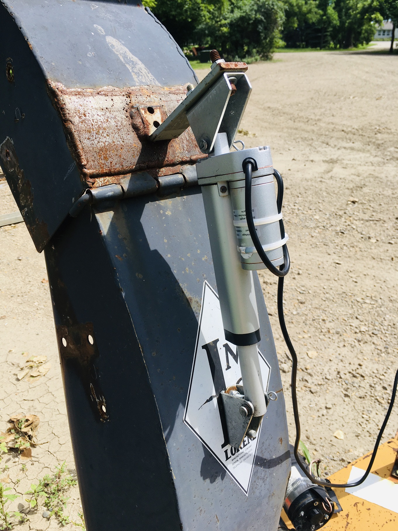

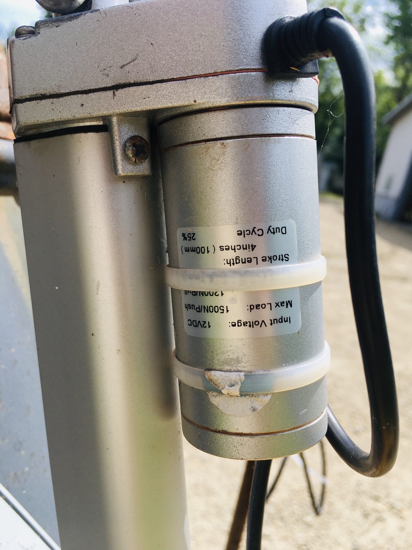

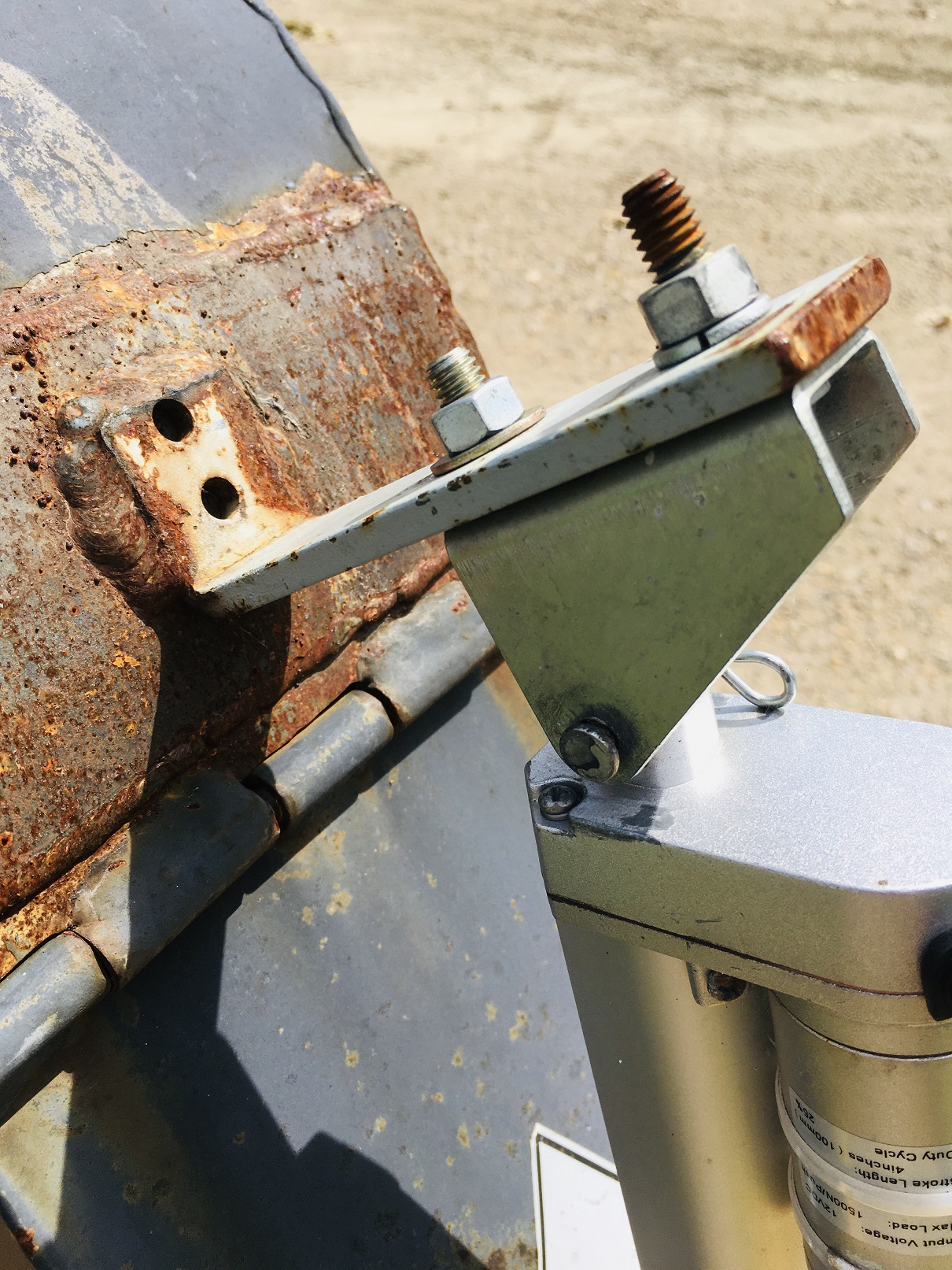

Here's a few pics of my setup. I need to sandblast and repaint my 30 year old Lorenz blower.
The actuator stroke length is 4 inches and mounted so that the chute deflector is at full up and down at each end of the actuator's movement. The actuator also has it's own limit switches so that you can't over extend or retract it. I had to add that taller bracket onto the chute that the actuator mounts to so that at full extension the actuator doesn't bind on the chute itself. My cord stand with the spring keeps the actuator wiring in the clear as the chute rotates from side to side. It's a very simple install and electrical hookup.
