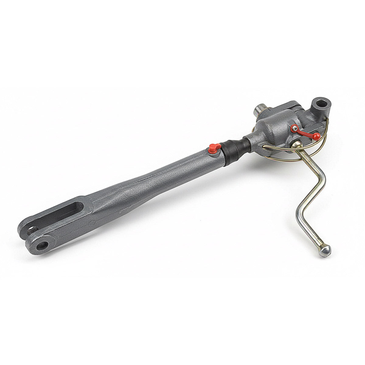

Hello,
First time, recently traded my JD 950 for L2610, everything about the new Kubota is great. However, I really miss the hand crank on the JD 3pt leveling arm, a small device I always used when pushing snow with the back blade. Question looking for an aftermarket piece or recommendation that would be similar to the JD one - any help out there would be GREATLY appreciated.

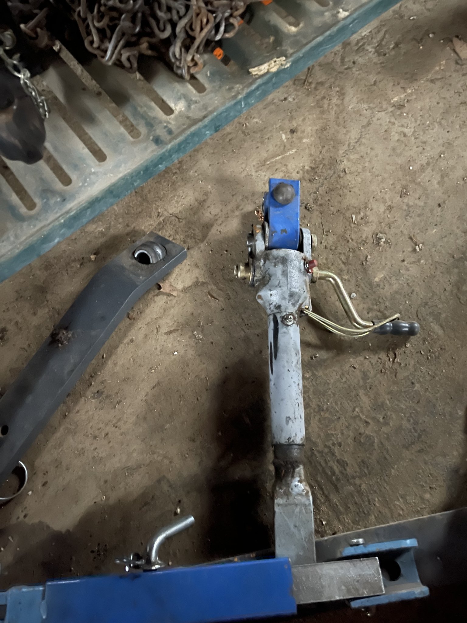

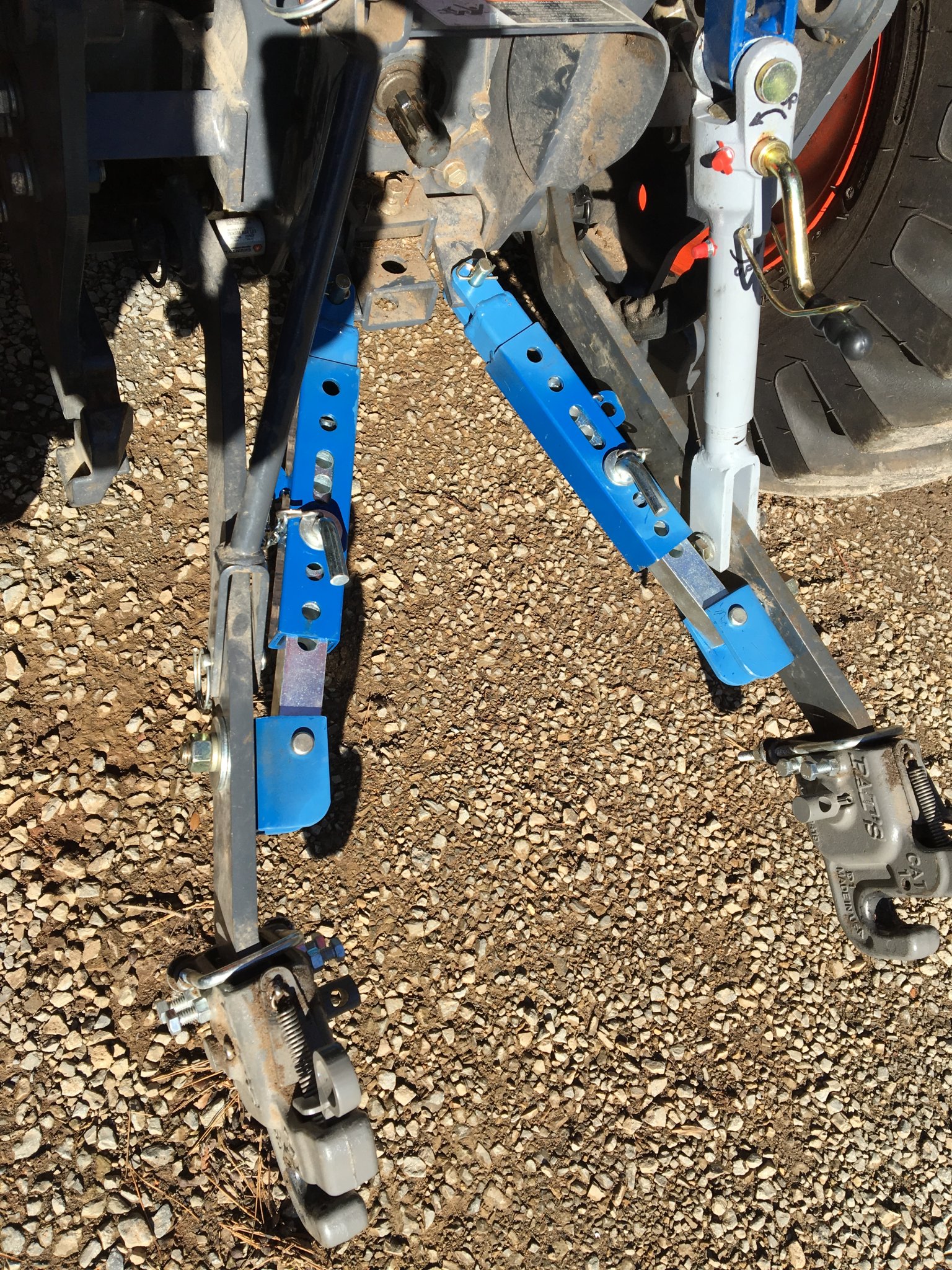

Upgraded leveling box , sway bars and Pat’s quick hitch on the B26 first thing. Nothing but joy. Note extra part from sway bar used to connect top of leveling box.

Can you show the upper attachment of your leveling arm?
I have been wanting to get one from Weavers but the top attachment will not work on my LX2610.
Thanks
I will. BH is on now.
if you noticed I had to use an U link(blue) that was extra from the modified sway control bars to connect at top. Weavers should have a similar piece available to make that connection. Just have to be mindful of overall length.
