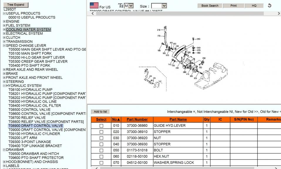

If you go to Kubota Illustrated Parts list: https://apps.kubotausa.com/illustrated-parts/
and enter L295DT, it list all the levers and what they do.

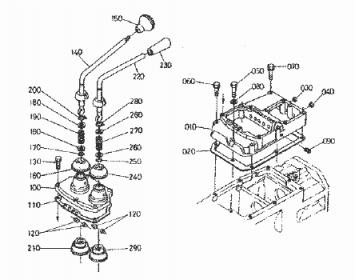

Are you talking about these levers?
If so, the left lever is the main speed control.
If so, the right lever is the PTO speed control.

Thanks for the link.
Definitely not the PTO (speed) or the trans shift levers. The levers I am asking about are the ones that control the lift/lowering of the 3-pt hitch. Located to the right of the operators hip. I looked up the link earlier on my phone and only saw one link, not two side by side. I'll revisit the link with a bigger screen.

It appears that the 2nd lever is the draft control lever. I could not find the raise / lower lever for the 3-pt hitch.

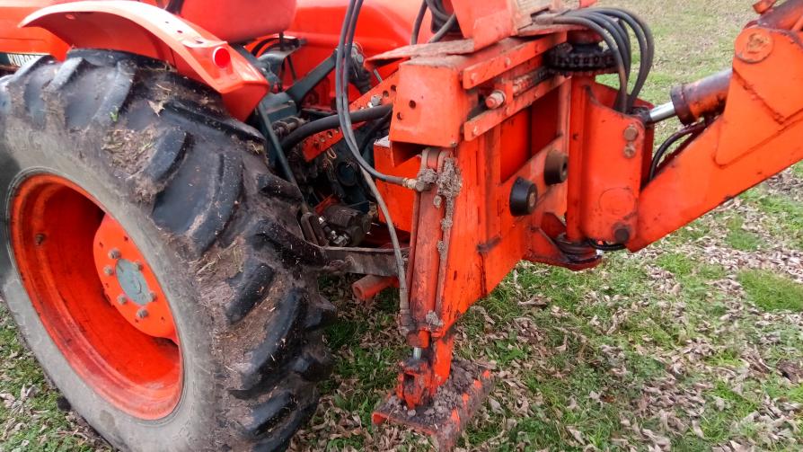

You don't have the BH mounted up right to the three point.
A properly mounted three point BH will not fall as the top mount stops it.
Also if you have not done so make sure you have the reinforcing plate on the upper link or you'll break the top of the three point right off.
The part that is either missing or not hooked up is a 4th link that goes from the top link down the unit to lock it in the upright position.

I did not see your message until after I left Texas. I sorted thru the photos I took while the BH was still attached and only found one image that partially shows the attachment of the BH. I am not following your 4th link and where it mounts.
I will say that once I cleaned off the draft control label and kept the lever up when I was moving the tractor, the BH did not begin to droop (excepting for the BH boom linkage itself due to badly leaking cylinders on the BH boom. I am not planning on reattaching the BH until after the tractor is sold and the tractor/BH needs to be loaded on the buyer's trailer.
