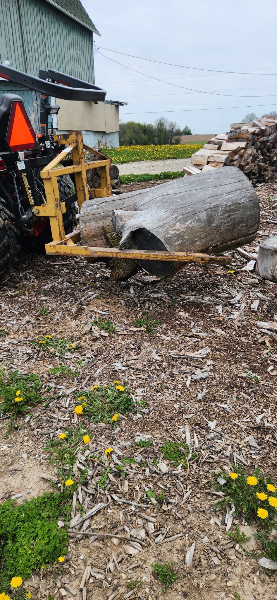

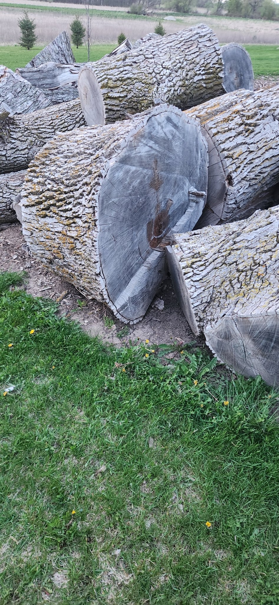

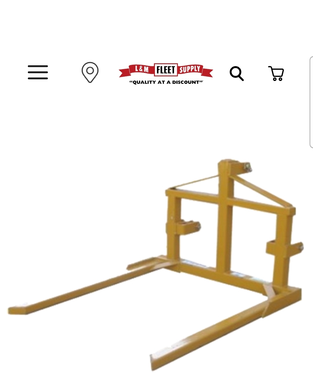

At the moment I can't justify loader forks........or think I'd have a lot of use for them after this project........even though I read once you have them you'll wonder why you didn't gry thrm sooner.......and no I don't want clamp on or amazon forks.

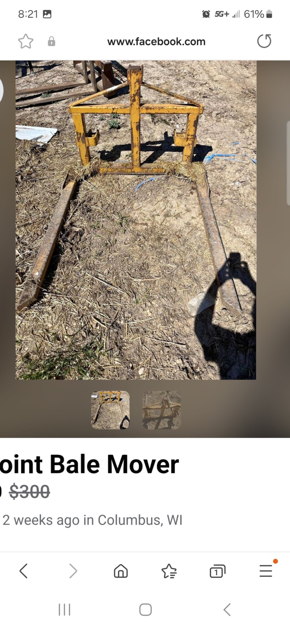

I found a 3 pt bale mover for cheap on marketplace. It's the same concept as forks or a carry all for the 3 point but the forks don't slide. They're about 50 inches wide.
I had a tree taken down a few years ago and cut and split all the limbs, now I'm to the trunk and need to move the pieces under the splitter.
I was thinking of using the bale mover and getting underneath to move the pieces. I did the samething where I use to work but with pallet forks and a skidloader.
The company that took down my trees had a b series Kubota so I'm sure my lx2610 can move the pieces, and honestly I'd feel better with weight on the back than up front.
Does this seem like something feasible? Or should I save up for real forks?
Any other ideas or uses for 3 point forks?

I do really get a lot of use out of my FEL forks. I’d spring for them even if the budget is tight. Actually my budget IS very tight right now, so I sold my back blade and grading scraper. Never for a moment considered selling the forks.
Forgive me if this is obvious, but you could “noodle” (cut in half or quarter longways) the pieces where they are to make them smaller and easier to lift in to the bucket.

I'd wait to find actual pallet forks. The ability to adjust width is what makes them valuable.
I kept watching FB and found a pallet fork frame/mount. New, no forks.....$150, it was for a mini skid steer. I cut the mount off and made the mount frame for my tractor. I had a set of forks. Don't use them much, but I have them. I prefer grapple in most cases.

Some other potential use for 3 pt forks could be to put a pallet on them and use as a platform or the base of a carryall. Depending on how you want to use you could even put sides on the pallet so you have a a little bed of sorts to carry / haul whatever. From that standpoint you could put weight it in and use for ballast too when doing loader work. I think there are some options there.
Personally I think it would be easier to get pallet forks on the loader under a chunk of wood as you have a little more ability to rotate forks forward and backward and up/down. On the rear, if you have a traditional top link, only way I know of to adjust the rear forks would be with the turn buckle adjustment. I am not sure you might have to tilt down to get under the log and then tilt them back if want to slip them back and haul without them slipping off.
Anyway I think adjusting the forks on the rear might not be convenient with a traditional top link. JMO.
Also the forks on the back would be fixed so you would be stuck with just the one width setting.
Actual pallet Forks on front you can normally move forks in / out allowing to use a variety of different pallet sizes to use or adjust to whatever picking up.
Front forks might have a little more versatility in terms of different use cases. If taking on / off a lot,hard to beat convenience of SSQA.
I think sort of depends on how you want to use them / frequency. Both have their place IMO.

Those were all thoughts I had too about the width adjustment and being able to to dig down to get undersomething.
I thought of getting a wooden crate and making a door or removable side for hauling whatever or putting a sprayer or water tank on a pallet.
Pros and cons to each but your advice helps.

I offered the person 150.00 cash as these go for 50, 100, 150 at auction. They said okay, but now I'm waiting on their realitive to get back to me on a time and place. So see what happens.

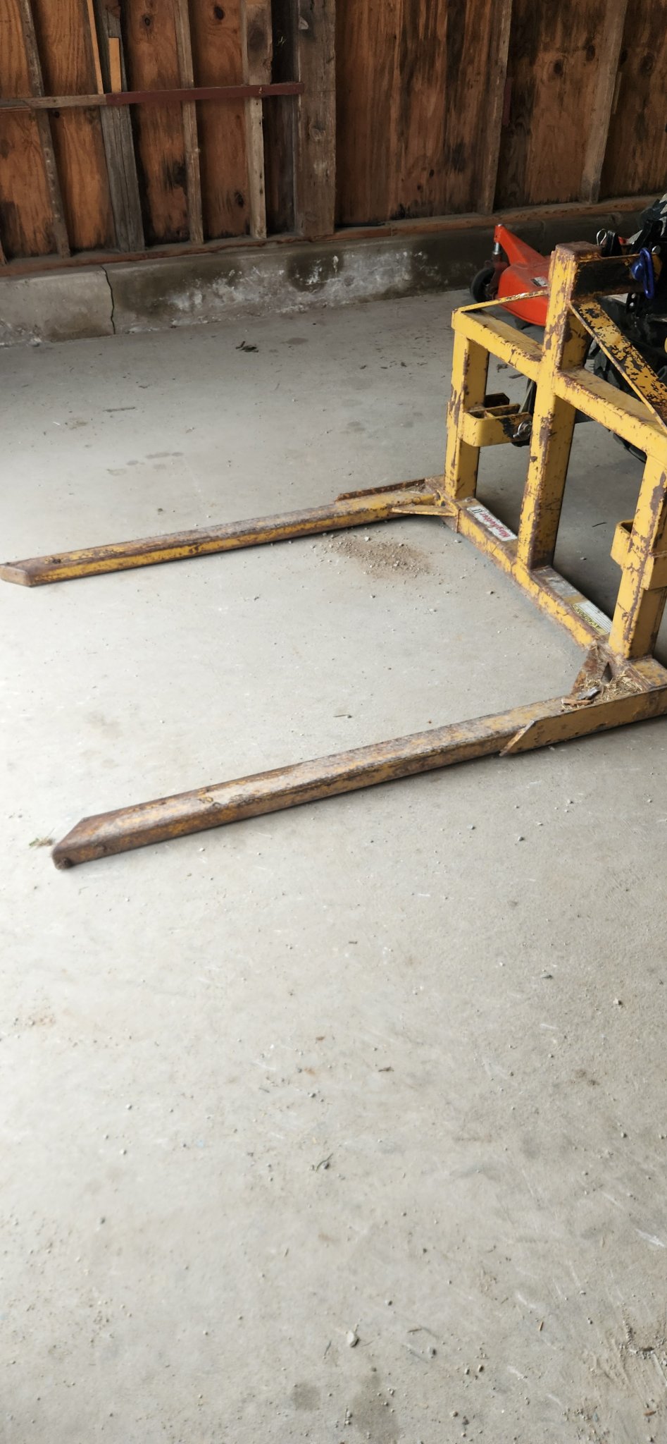

View attachment 127593 View attachment 127594

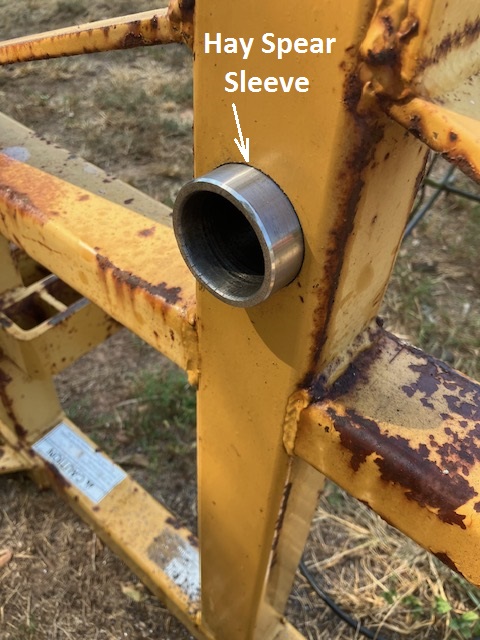

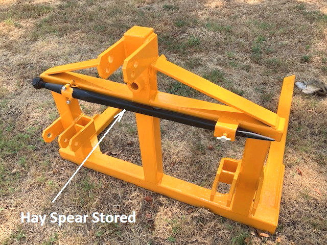

I have the same bale carrier. Use it with a box I built for a 'carry all' at times. It is a ruggedly built hay fork...so you can use it to pick up some pretty heavy items (logs, etc) and not damage it.
I wouldn't use it in 'place' of forks on a FEL....but it does have other useful functions.

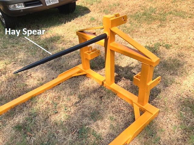

I added a hay 'spear' to mine to facilitate quicker engagement with hay bales and to make it more secure when carrying bales (they can't roll off sideways). It is removable....for when I want to use my carry-all.
View attachment 127610 View attachment 127609
Great idea with the spear and looks like a factory option.
