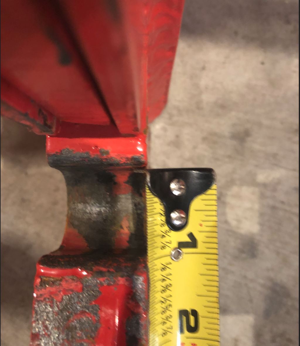

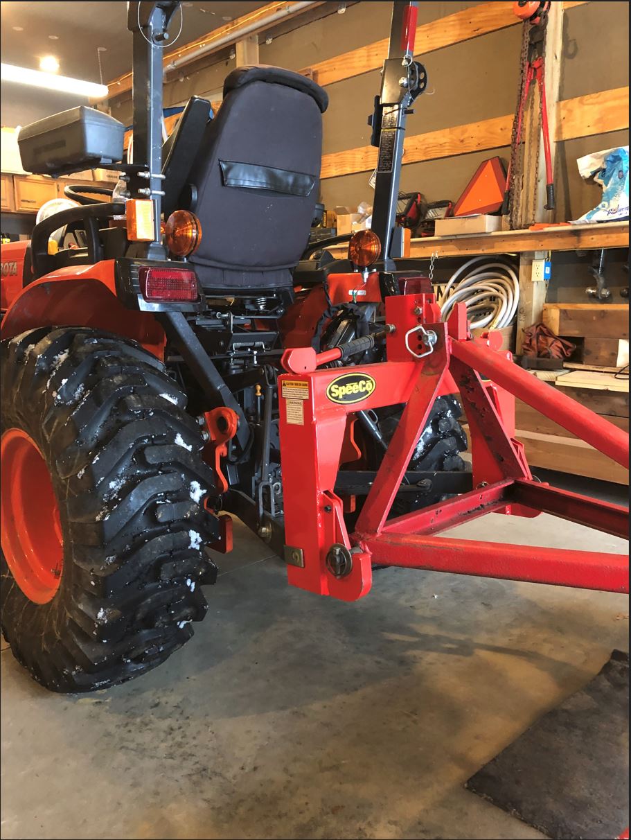

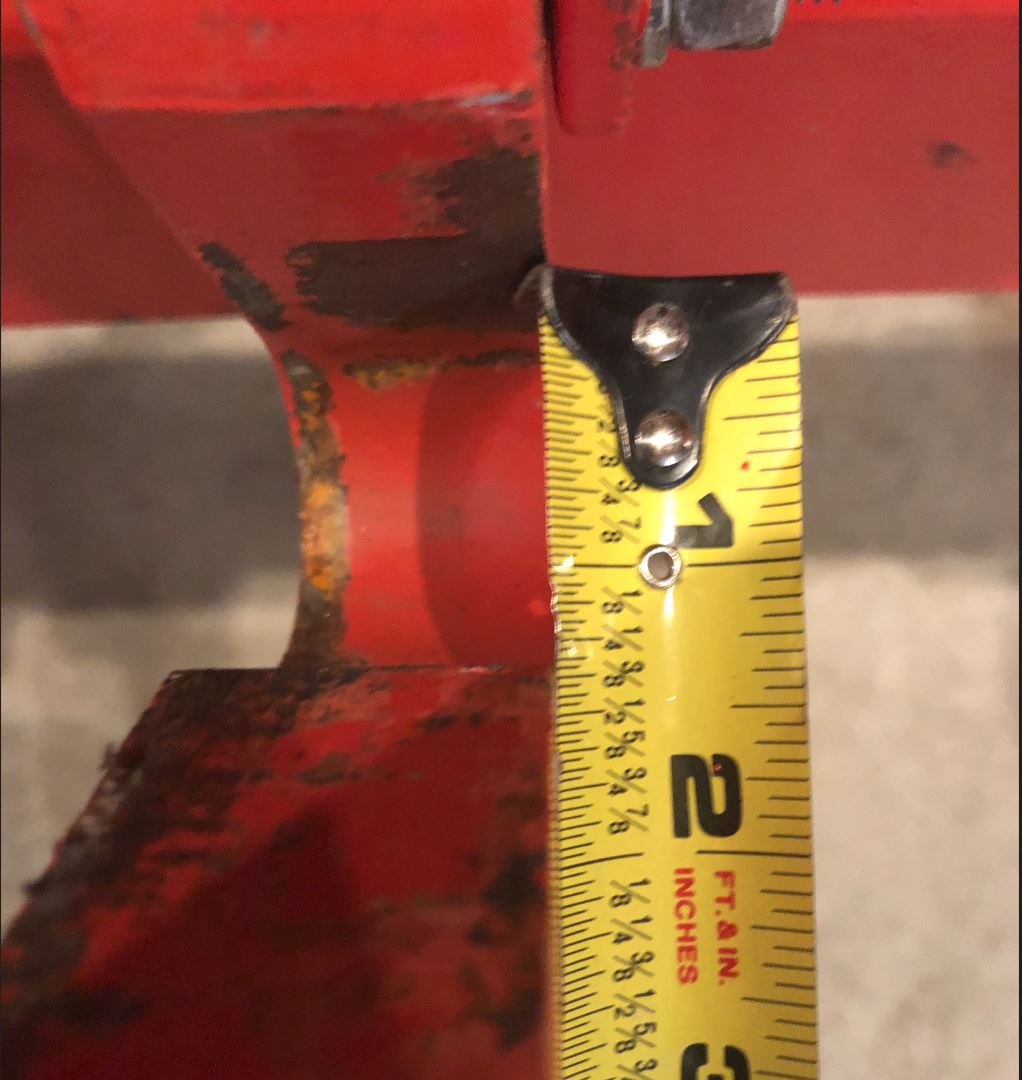

OP- take a look at the Speeco E-hitch. True Cat 1. Very little movement in the bottom cradles. The E-hitch can be had for somewhere around $225. Mine has worked great.
Bottom hook
top hook
