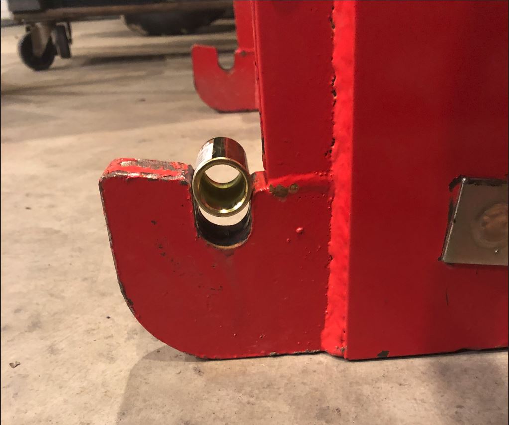

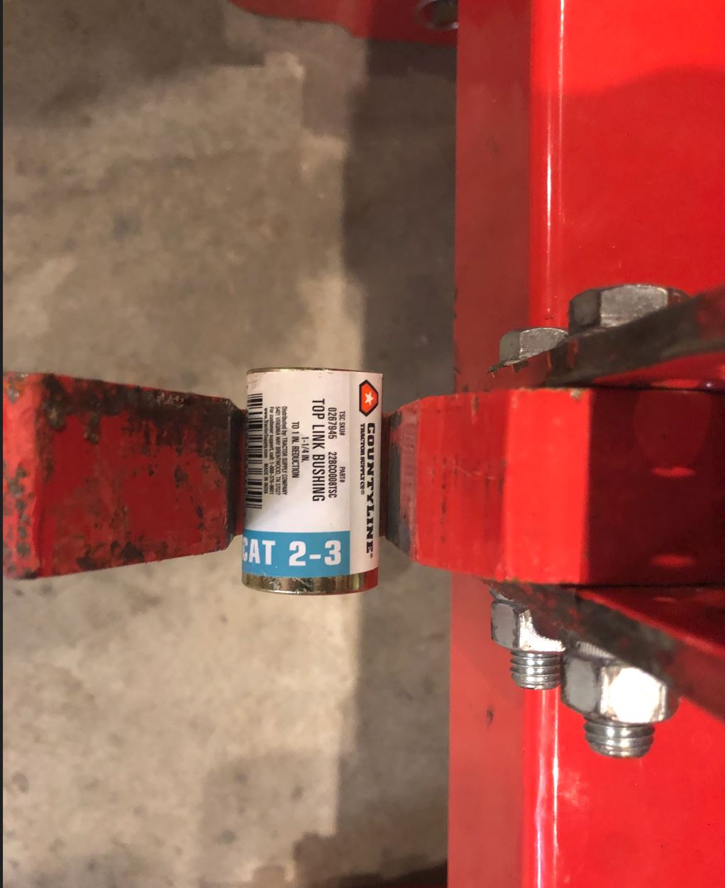

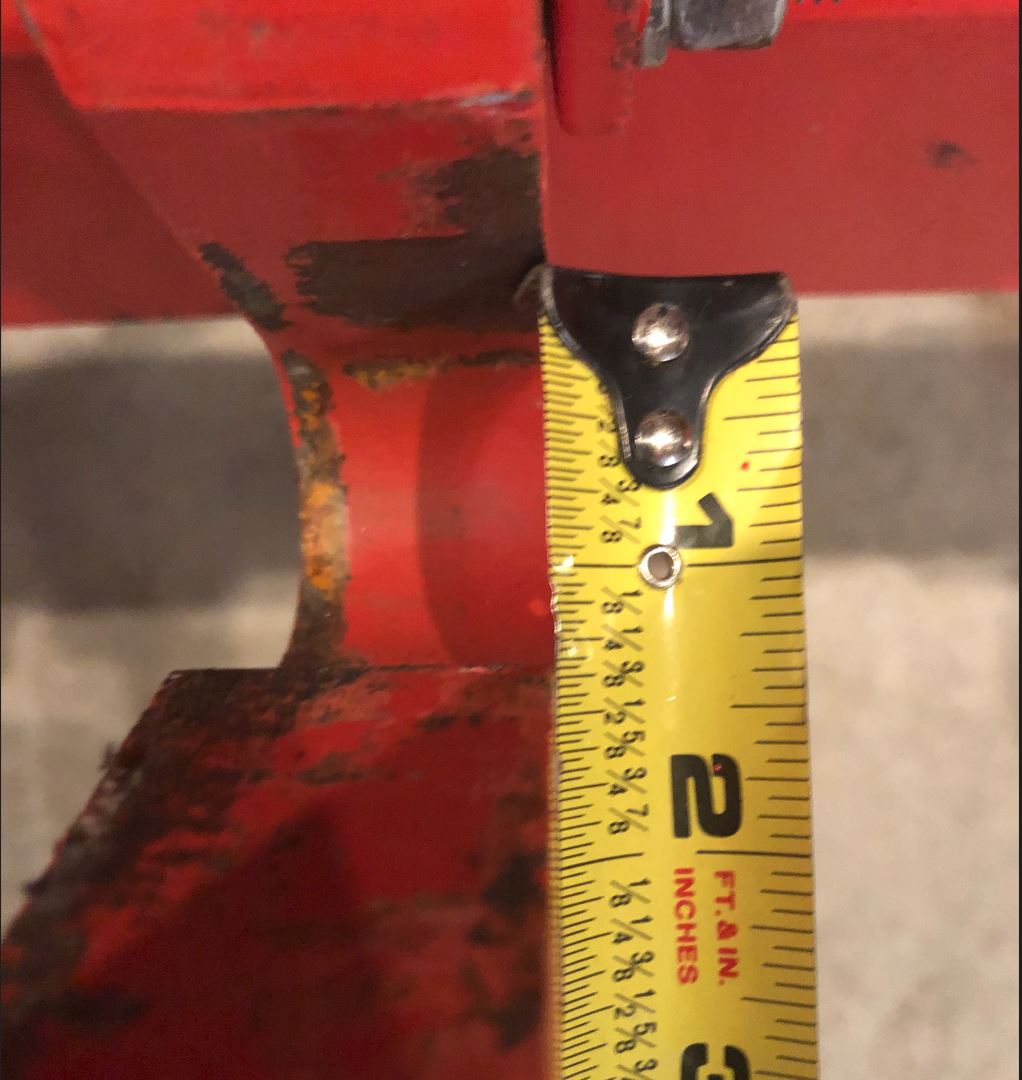

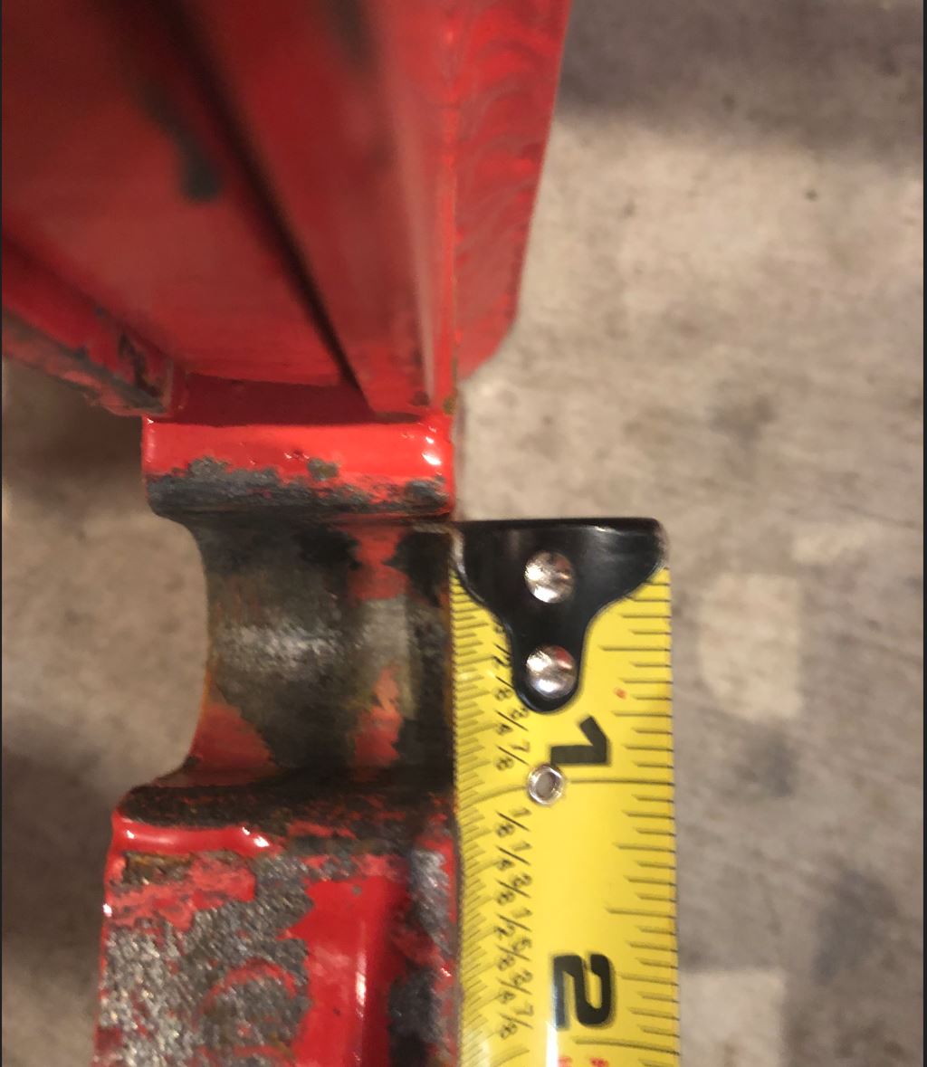

Maybe this will help... speeco e-hitch
Top with 1-1/4" bushing
top hook measure
bottom hook with 1" bushing...doesn't fit
bottom hook measure:
There isn't much "slop" at all with standard sized implement pins. The handles aren't great but, what do you want for $300 in this economy?
Perfect thank you! I ended up calling EA today and got same answer. 1 3/8 inch for the top (for both e hitch and the black normal one with bushings), so a cat 2 pin of 1 1/4 or cat 2 at 3/4 will fit. The bottoms I think are 7/8, basically both top and bottom have an extra 1/8 play in the hook. I'm leaning towards getting it for $320, but still weary of the slop. I've seen the land pride QH15 and it seemed pretty right with the bushing. You don't have any concerns about it being loose at the bottom?
