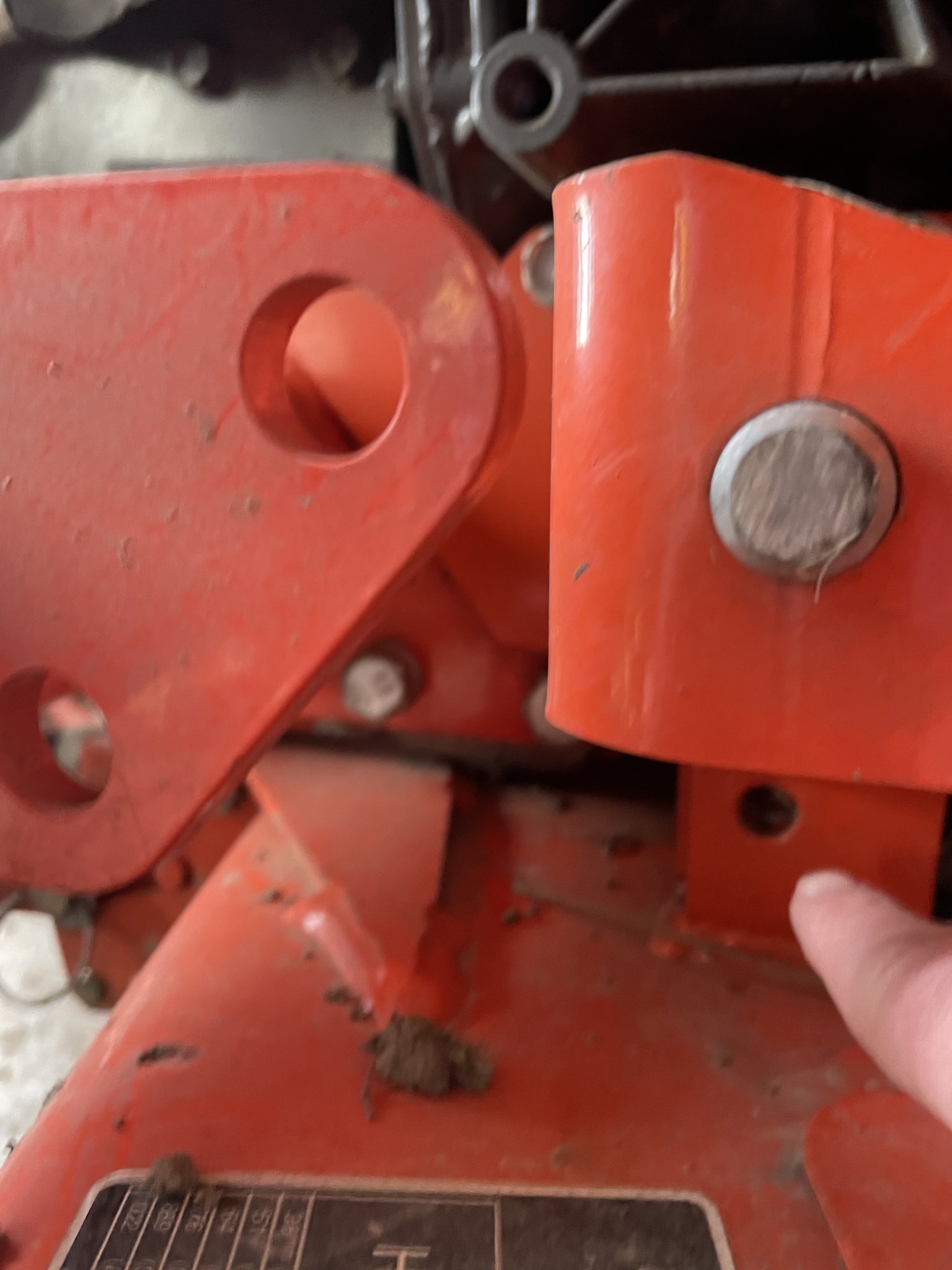

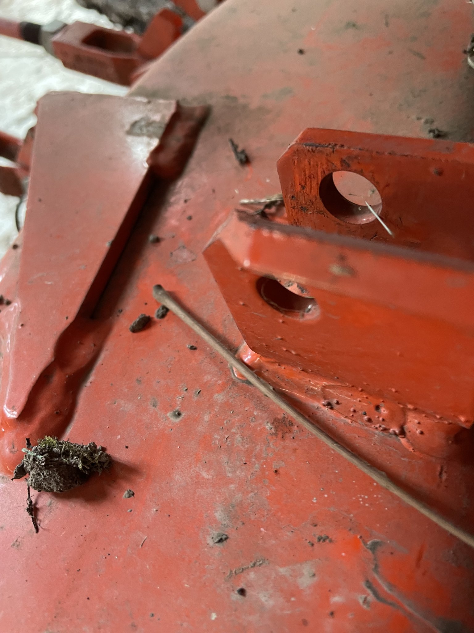

First check your manual(s) but then look at you deck does it have a u/v bracket on the front on each side see pick below (should have a pin hole? If so run it too very top and see if it aligns to a hole…check and see if manual suggests pinning the deck up from that location.

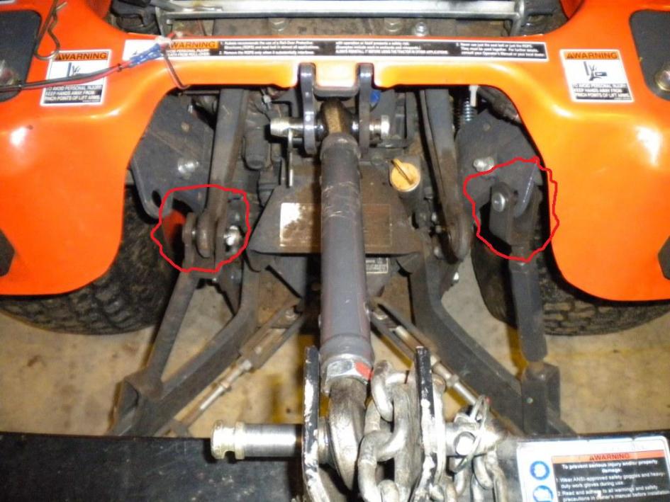

Skeets- the BX tractors have little “tabs” to pin/hang the side lift links to, but don’t know if the same applies to the B’s.
You should have them on your BX2360 because I do. Just don’t know if you have them on your B.
Disconnects the side links from the rock shaft, etc. They just hang from the tabs.
That would keep the 3PH up and let you raise/lower the MMM.

Okay, now that you've clarified your need, I have a BX2380 and there are holes in the rear frame that allow pinning the 3 point up.
The problem is that it involves disconnecting the lifting arms, meaning you'd need to somehow jack the attached weight box up far enough to allow making the connections.
That's the only way I can see it working for you.
