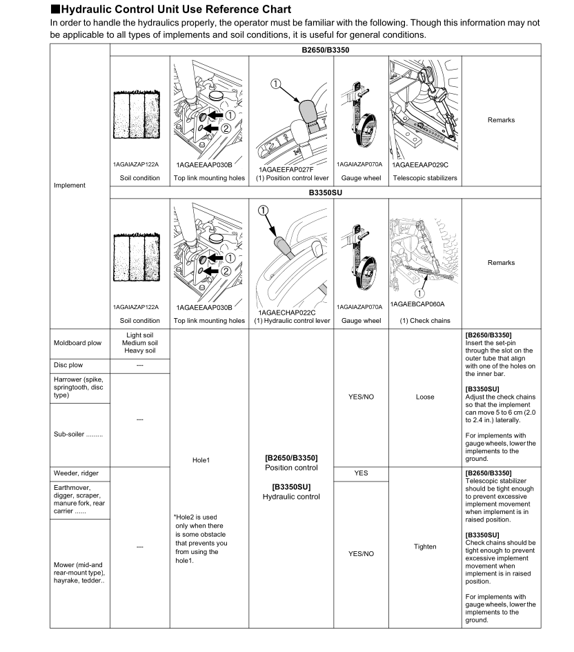

My B2650 operator's manual has a section that describes when to use the oval holes on the stabilizers to allow for play on certain listed implement types. The sway looseness needed depends on the implement, some need serious play. Listed are a few, like moldboard plow, disc plow, subsoiler...
Not sure if your BX23s has the Hydraulic Control Unit Use Reference Chart in its manual, I'll take a screenshot of the chart in B2650 manual.
Note the Telescopic Stabilizers column...
EDIT I noticed the [B3350SU] sections have stabilizers (link arms?) that look like your BX2506 kit?
This is extremely helpful in that it shows a clear example of where "loose" and "tight" link arms are appropriate.
