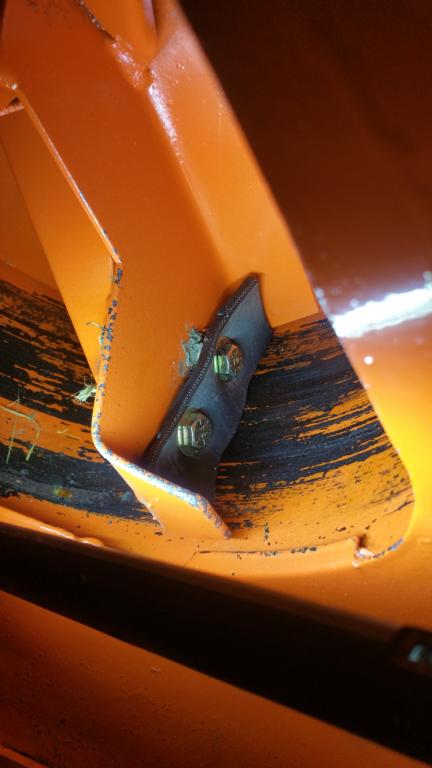

Also, make sure the right and left augers are 180 degrees out of phase so they don't both dump the snow load into the impeller at the same time.
Sent from my SM-J737V using Tapatalk
May want to rethink that. The augers in the two pictures below are arranged to dump the snow into the impeller at the same time. With them being out 180 out it seems they'd bat the snow back and forth between the augers.
Kubota's seem to come from the factory with the augers in phase like your examples (mine was as well). When I rebuilt my blower I turned them 180 degrees out. I noticed with them in phase the snow would pulsate out of the shoot with each rotation of the auger. With them 180 apart the snow smoothly flies out of the shoot in a continuous stream.
As someone else suggested, add paddles to the impeller arms to squeegee the wall. I used old sidewall from an ATV tire. Mine throws wet snow 30+ feet.

But have you actually checked where the impeller (rotating fan) actually connects to its shaft. Put a wrench to the set screws, etc.? Depending on how it's fastened....it can slip if something isn't properly tightened or something is missing in order to hold it fast to the shaft under load. If the snow isn't being thrown out the chute properly it would appear that the impeller isn't rotating fast enough under load. Our B2650s have ample power for a properly sized blower.

The fan shear pin appears to be broken... The fan looks to be rotating out of phase with the inner shaft. Look at the white snow marks compared to the fan. They should be moving in unison.
If hard to tell while moving mark the components, run, stop and compare position.

I agree the fan is not running backwards, but is an artifact of the camera frames per second and the the rpms the tractor/blower happens to be running at.
Fan (not auger): Can you verify both the shear bolt (20) and the bolt (19) that holds the fan drive hub to the main shaft are both 1 piece and not broken?
I'm also wondering if the PTO clutch is slipping when under load.

Notice the third photo, the correct side of the fan blades show wear and not the backside. To me this helps vindicate the camera just can't record that it's spinning the correct direction.

From your pictures and comments it appears everything is operating as designed and it is the snow/ground conditions that are the cause.
I have a BX with same style blower. It has the same issue blowing heavy snow when the ground isn't frozen yet. What works for me is to muddle my way thru one complete pass first, engine at full speed, creeping in low range. Once I have a path I then take half width passes (sometime even less than half) at faster ground speed(hi range). I've found this forces the snow into the augers, minimizing the snow building up in front of the blower. Once the ground freezes I no longer have the snow build up/pushing problems.
(I had to remove the chute guard to ease cleaning out wet snow chute plugging)
It seems ridiculous to only clear 2 ft of snow at a pass with such machinery but it still beats a shovel (I have approx 400 yards of driveway, in the woods, no place to push snow) and the BX is used for much more than snow removal.

I agree they look to be intact. Too bad it wasn't something so easy. ;)
If you think technique is OK, which I'm assuming it is based on your prior experiences with a snow blower, don't rule out the possibility of a faulty PTO system.
If the PTO clutches are slipping when under load, the speed to the blower would be reduced hindering its performance.
Yes, this is a long shot, but sounds like you're open to all possibilities.
Any chance another forum member is close buy that could try the blower on their tractor or have a another blower for you to try?
