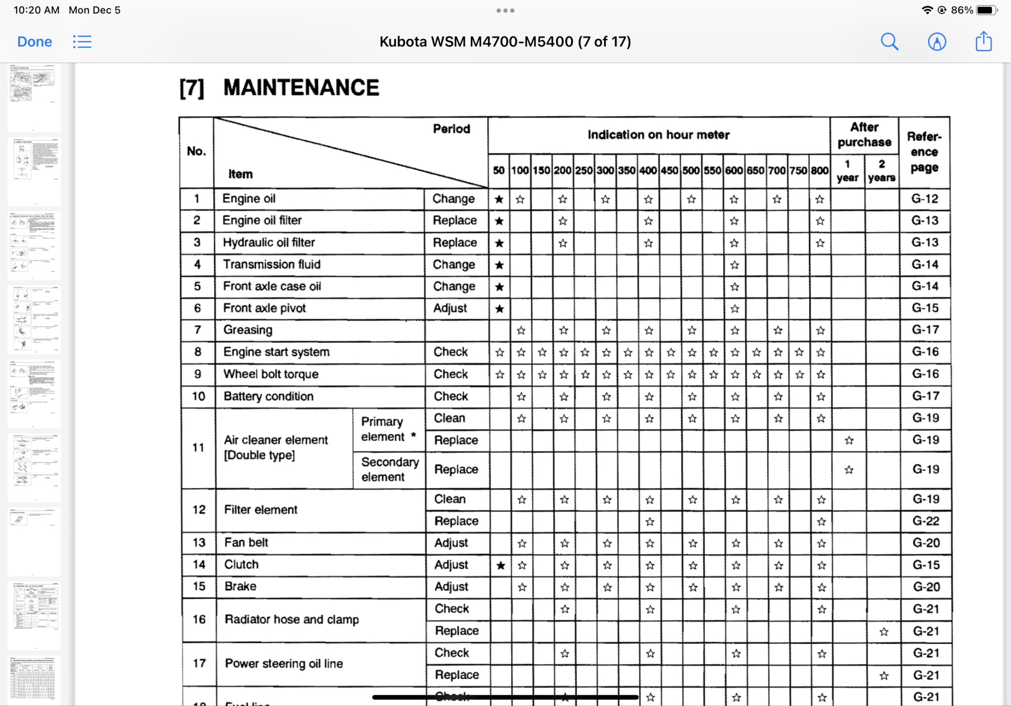

Kubota published the following for my model: (note that the filter is only recommended every OTHER oil change…. I change it each time tho’…can’t see running fresh oil thru a dirty filter or keeping a 1/2 qt of dirty oil in-service.):
