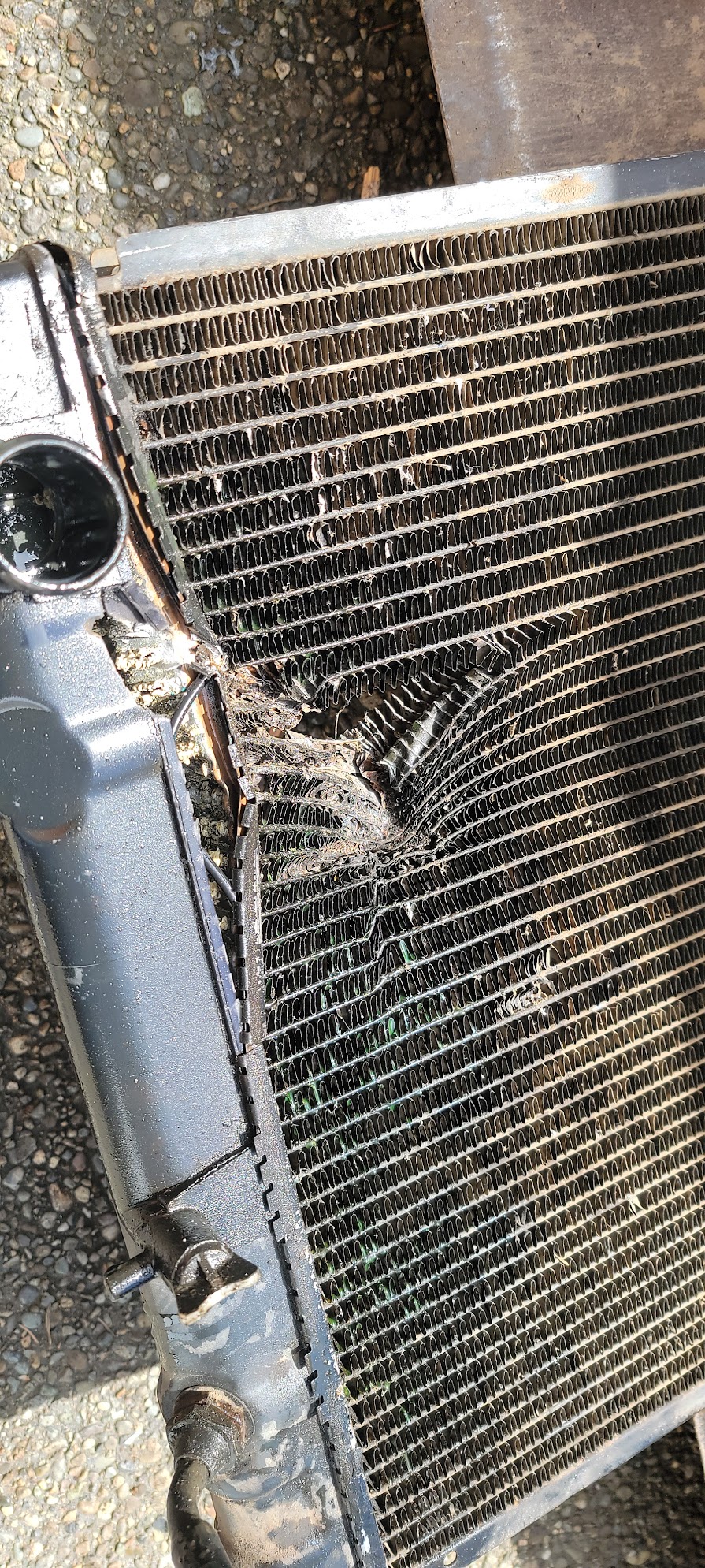

I have a 1994 L3300. It's old and tired but serving me well enough for now. This weekend, I had a mishap with a hidden T-post - it was deep in some brush and bramble, and even though I was leading with the loader, managed to puncture my radiator as I was backing out (I think my loaded pushed it down, then it tilted back up enough for the front axle to catch it and direct it straight through the fan shroud and through the rad).
So I started looking around online, and, the part number appears to be T0070-16000. $1100 or so is a lot to throw down though.
I was hoping to see if any alternate Kubota (or any, really) radiators would fit. I don't push this tractor hard at all (no plowing, no snow removal, maybe a couple hours of use per week in the summer, mostly mowing fields).
I found TC020-16000 which says it's for the L3400 (among other models). I however can't get any good photos of this radiator, so I can't begin to tell if it'll fit. Dimensional-wise it's just a little smaller and a little less fins per inch. The main inlet and outlet appear to be in the correct spots, but that's all I can tell. This one is appealing cos I can find several versions of it online at various shops, for $250-$300!
If that one wont work, does anyone know any others that may fit? If I have to pony up $1100, well, so be it, but, I'd really rather not right now if I can help it.

I did a bunch of reading and searching. I don't think TC020-16000 will work on my L3300 -- the OEM radiator has a ~9/16ths outlet on the bottom, next to the drain plus. I didn't follow it back to where it goes, but, I'm assuming plugging it wouldn't be a good idea. TC020-16000 doesn't have any fitting for that.
However, I did find this:
It's a bit taller, so, I'll likely have to do some work on the top mounts to make it fit. Width it matches though I'm not sure if the bottom mount positions will precisely line up. But it does have a 9/16ths lower port. So, I bought that. I think overall the cooling performance of this may be lower than OEM, but, for my use, I believe that may be alright.

Well, the cheapie I got from Complete Tractor didn't fit. The listed dimensions were pretty far off from reality and it wouldn't fit, unless I wanted to give up the side panels and hood.
I ended up ordering a new one from Messicks. Overall after taxes and shipping they were the cheapest at $920. Oof.

Well this is slightly annoying. The new rad is exactly the "correct" part number, but, the mounts are noticeably shorter - about 1/2" compared to the original from the tractor. So, I can fit them into the bottom mounts, but, they're too short to reach the top mounts.
But, it's installed. It feels secure _enough_ to call it good enough I think.
New battery also installed. Going to swap in a new starter after work tonight, then fill up the cooling loop and try to get it warm tonight/tomorrow to make sure everything works.
