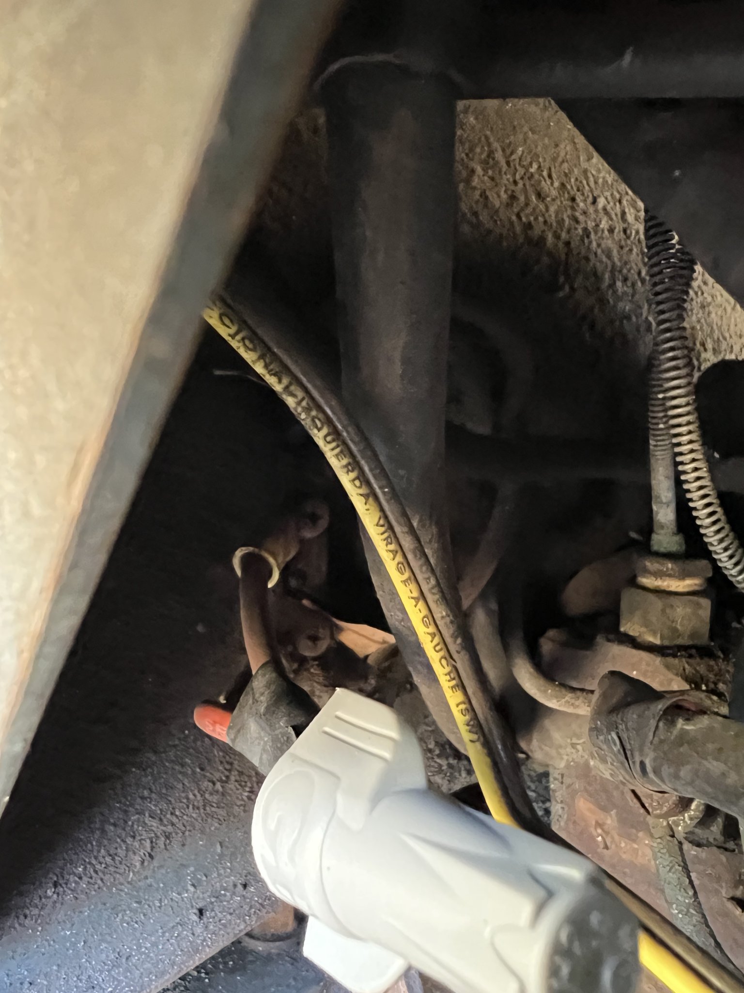

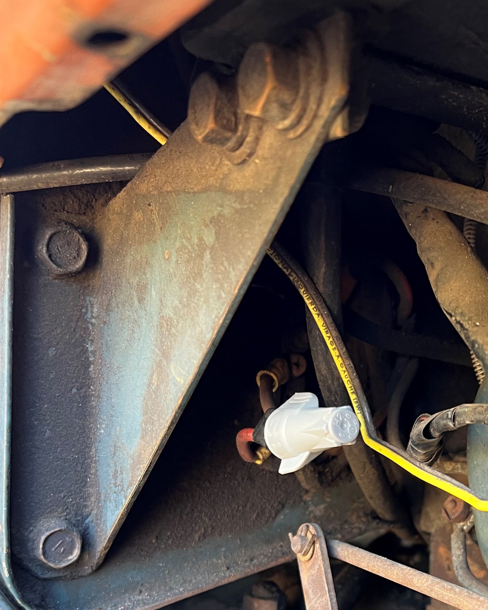

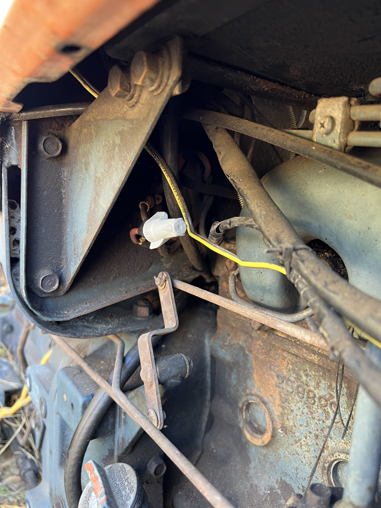

Judging by the wire color and size, I'm wondering if the part that was removed was a fuse or Fusable link?
It would help if you zoomed out for the pic, and said where it is.
10,750
2,557
If that was a fusible link that was removed .......... you need to replace it!
As for getting hot - resistance, is what builds heat. Hot is a relative term, a wire will get warm/hot when a good amount of electrons flow on it, but the heat should not be such as to burn/melt anything. If that fusible link WAS there and burned, there is something else wrong that you are bypassing at this point.

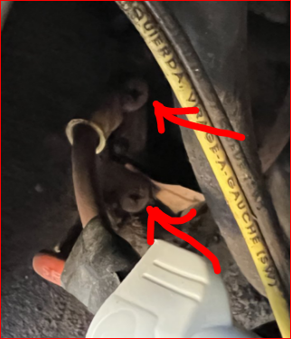

Looking at the picture - those two ends - do they terminate on those two screws?
If it were a fusable link how would I know what kind to get?
Yes. One wire goes to one screw and the other wire goes to the other screw. I don’t know anything about fusible links. How do I get the right kind? Thank you so much for your help.
