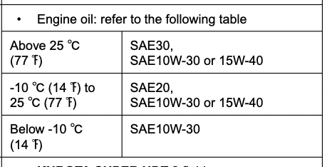

Hi All, I tried searching and couldn't find anything on the forum. I'm curious.. living on the east coast mid Atlantic. I'll be using my BX23S for some snow removal in temps below 32 deg F. Most of my use would be spring through fall. Has anyone had any issues running 15W-40 below 32 deg? I know Kubota says 10w-30 below 32...or am I fine running 15W-40 all year round?

Virtually all automotive engine OEMs recommend a 10W or lighter oil when ambients are below freezing. That has been the engineering standard for 50+ years. Given the all season performance characteristics available with modern oils there really isnt any good reason to deviate from that standard.

I called the dealer that sold me my L3301. I live in northern MN and we have had mid 20s in the mornings already. I asked if I could use Rotella 5w-40 and he said I shouldn't and I should use 10w-30. I have read that so many people use Rotella 5w-40. My manual doesn't list that weight as an option. Are people using 5w-40 even if it's still under warranty?

I think the warranty question is a great question, why use a grade of oil that is not recommended by the manufacturer. I have not deviated from the recommended 10W-30 for cold climate use.

Thank you all for the feedback...I ended up calling several dealers in the tri-state. All recommended 10w-30 for NJ. I think the Rotella T5 10w-30 is looking good.. its a synthetic blend...and Wally world has it for $27 for a gallon. Where as Kubota conventional is $43 here.
