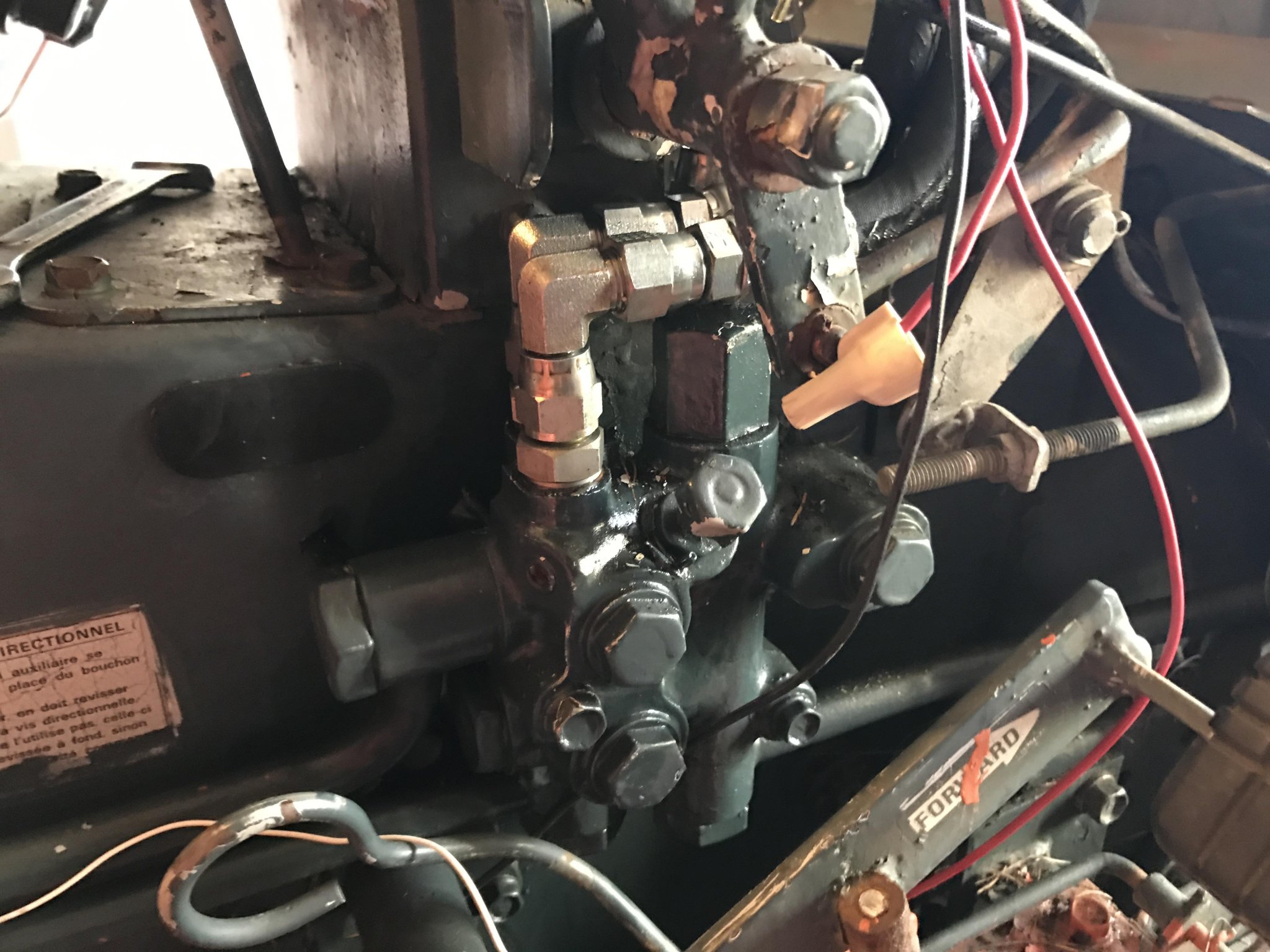

The directional valve opens hte power steering, when it's capped off it's closed so there's no flow. I used hydrualic steering from a JD 318 and piped it in. It works very well.
This is the 8200, I'll get the 7200 shortly.
11,279
6,329
That makes no sense to me. I'll wait for the pictures of the B7200 plumbing. Is the PS on the B7200 OEM or retrofit?
In the pictute of the B8200 there is no loader connection - just the PS.
In any event it really does not change the process for testing loader operation.

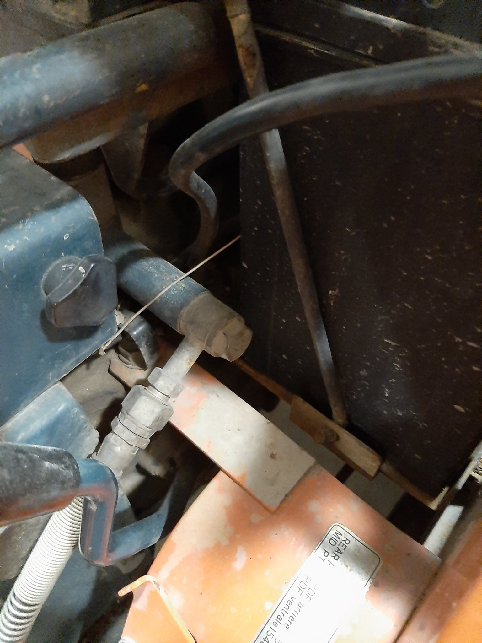

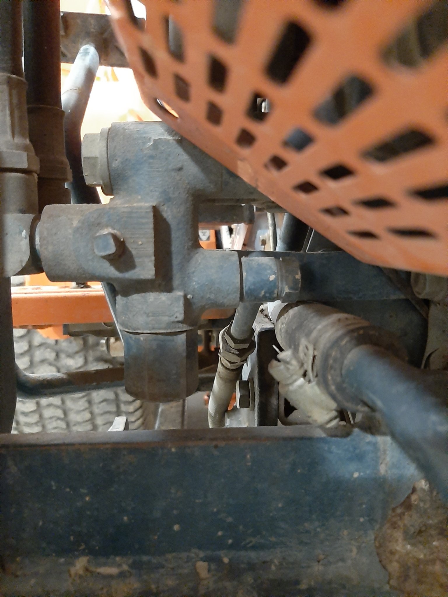

Here are some reference pictures from the B7200 that I sold. OEM power steering.
Perfect!!! Do I have this right?
The PS flow divider bolts directly on to the two remote outlet ports in the hydrailic outlock block with banjo bolts. It has two ports for the loader supply and power beyond returm just like the standard oitlet block. It also has a third outlet that supplies the priority flow to the steering cylinder.

I believe you have it correct! This is going back almost 40 years since I installed the power steering kit. From what I remember the kit came with another block with longer banjo bolts. I did this about three years after I bought the tractor.
One thing I remember is that the dealer (to my disbelief) had cut apart both metric and imperial 90-degree fittings for the loader hoses. They then brazed the male metric halves to the imperial sections so imperial hoses could be used. When I installed the new block, I tapped the threads out to 3/8" imperial so I could use the proper 90 deg fittings shown in the picture.

I got a better look at the 7200, and it's not like the 8200 for hydraulic blocks. The hydraulics come from somwhere near the fuel shutoff/filter on the side, I havewn't traced them down yet.
I can look into it further, i'd like to get to the bottom of it, but i can literally hear the fluid bypassing in the bypass in my spool relief valve next to my hand.

The B7200 outlet block is real simple. It bolts to the pump and has two ports on the side. One is pump out to the loader and the other is pressure return to the 3pt. No PS ports.
It also has a built in pressure relief valve that protects the pump and limits maximum pressure out and a selector valve that selects the flow path - straight through (no loader) or side ports (loader installed).
