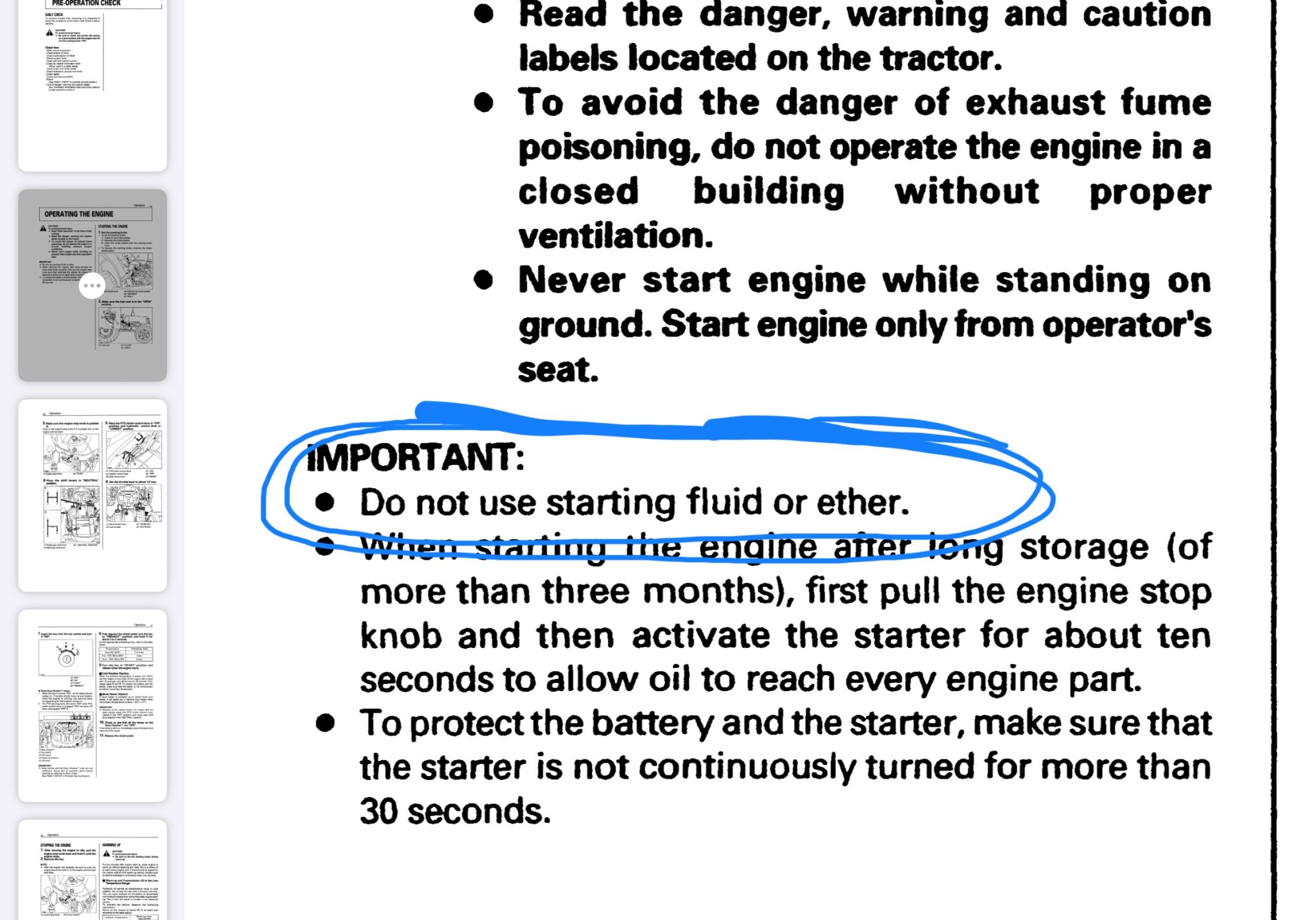

There’s a Reason Kubota Owner Manuals warn against using ether / starting-fluic.
