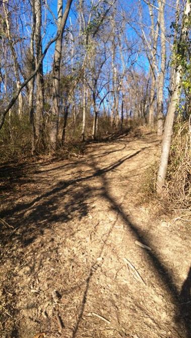

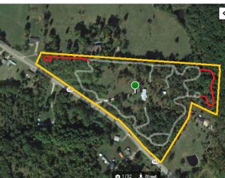

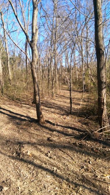

besides having it saved & sharing with all of you guys this is a great way to share my improvement on tractor skills with the toothbar & the land.
remember: all of this is being done with just a B2601 & a toothbar! then bush hogging over it.
the pictures are just from the last couple of weeks & do not show all of the trails marked just what i snapped from this go around.
yellow is property lines
white is trails made/pictured
red is still to do!

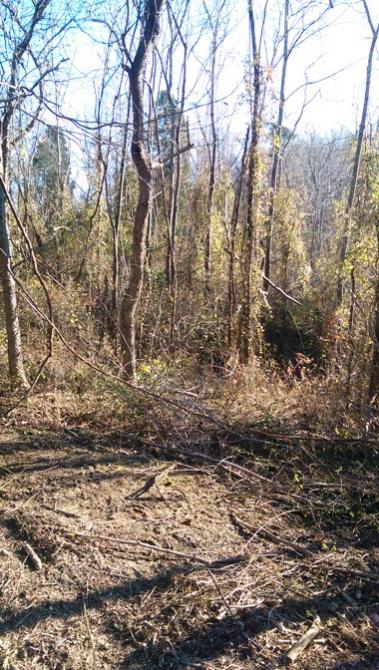

the stumps are not on the trail... thsoe are where my other project is going on of cutting down dead trees.
on the trail cutting, that toothbar has allowed me to uproot or cut through everything in the path.
sapplings & young trees up to about 2"... ive been able to shove them right out of the ground.
briar bushes & scrub it either up roots it or cuts it off & then i run the hog close over it & its taking it down to what you see.

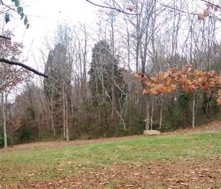

on the powerline right of way in that one picture there are 2 stumps that i found from years back. gonna take the grinder to those.
what the guys here have taught me on the toothbar is if i KNOW its there/too big to push out... i go up to it & dig the teeth in to the dirt & curl the bucket a few times to loosen it up. then back up & go at it again & so far ive been able to push everything out.
granted i am picking the directions im going by trying NOT to kill any trees.
this has also allowed me to transplant a couple of good sized maples & redbuds!
not sure how video would work as im closing in on a mile of trails right now & they typically take me & the wife 30 minutes to walk.
maybe i could do a video from the tractor next spring when im mowing?
red is still to do!
