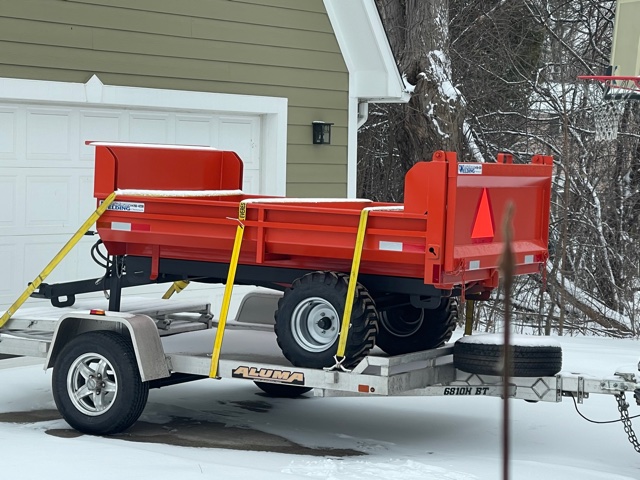

I've got many plans this year for clearing a few areas and also for tidying up many downed trees. In an effort to be more efficient I invested in a small farm dump trailer to fit on the rear drawbar of my tractors. This is a 2 Ton trailer that the manufacturer says is really capable of at least 3 Ton. I ordered it in an 8' x 5' single axle, they are also available in 6' length and / or with 4 wheels. Empty weight is around 700 lbs for my 8' long with single axle. I'll probably remove the tailgate for most of my woodland use and will add wooden side boards so I can load it full of roots or timber, looking forward to a fast empty using the rear hydraulic remotes on my tractor, main use will be on my L3200 and L3901. Most of my loading will be by grapple or by hand when I can get it deep into the woodland areas where I'm working.
Just need to get the weather to cooperate a little so I can get out to start my work.
Unlike the road dump trailers this just has a cylinder and 2 hoses, wheels sit under the dump bed.
Trailer is just about the smallest one made by Berkelmans Welding who manufacture from 2 ton to 20 ton farm dump models.

Very nice dump trailer!
At first look I thought that with the axle that far back, you would have a lot of tongue weight if loaded fully, but then I realized you will be pulling it with your tractors, and it is not meant to be an on road, highway-speed trailer.

My need is all on property with 350 acres of mainly woodland to manage. Several factors were important, ground clearance to get over rough ground, minimal width with wheels under the dump bed, trailer is roughly same width as tractor, important when traveling narrow wooded paths and tracks. I often have to travel nearly a mile to get to open ground where I can burn roots and brush, trailer will greatly help, I’ve been using a similar sized high sided utility trailer but it lacks ground clearance, wheels stick out and hit trees and when I get to where I’m going I have to unload it. Looking forward to the dump feature to save time and effort.
It may get a little use with sand and stone to support a couple of track improvement projects.
I was worried about tilt of the trailer relative to the clevis mount on the tractor drawbar. This is the first tractor drawbar trailer I have ever purchased, I did not realize that the clevis mount swivels / rotates on the trailer hitch end so the tractor and trailer can have totally different camber in off road use. I am always learning however that totally solves that worry.

2 Ton Dump Trailers
6ft. or 8ft long 5ft. wide inside dimensions.
64” x 84” long without hitch, Removable hitch is 42” long.
2ft. front, 1ft. sides with pockets for extensions and 24” tailgate.
60 cubic foot box.
Self locking and unlocking tailgate.( We no longer stock the barn door tailgate but can be special ordered.)
2 pins to remove tailgate.
10 gage floor and sides.
10 gage front and tailgate.
Side heigth without board extensions is 41”
Removable hitch.
16” x 3” hydraulic cylinder 5000 dump capacity.
3000 lb drop leg jack
Removable trailer Jack
Trailer weighs approx 700 lbs.
12” Track Chief 8 ply tires on 5 bolt spindles. Tires are 26” tall x 12” wide.
Optional 12 volt pump
Choice of colors, Kubota Orange, JD Green or International Red
Trailer weighs 700 lbs.
