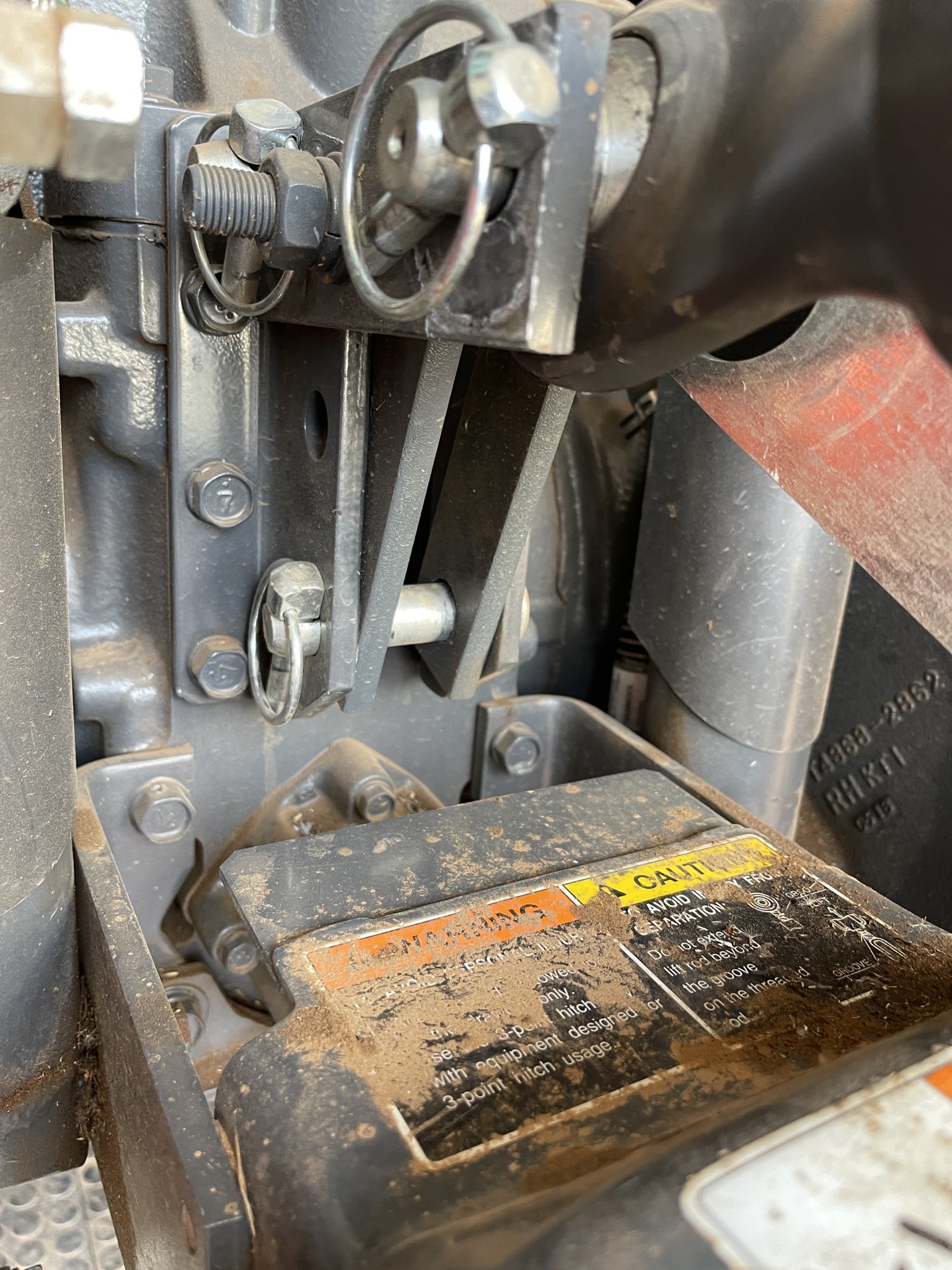

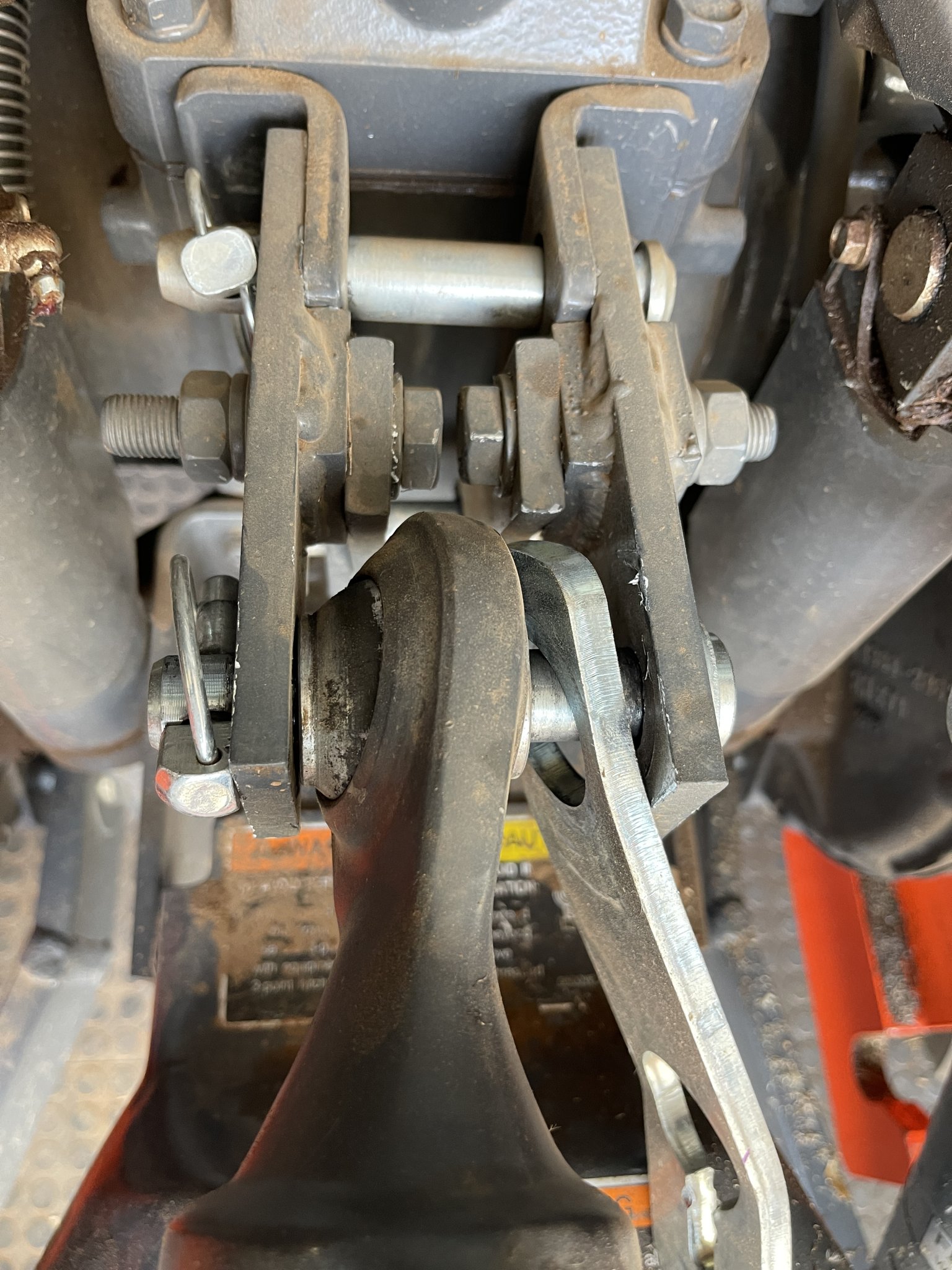

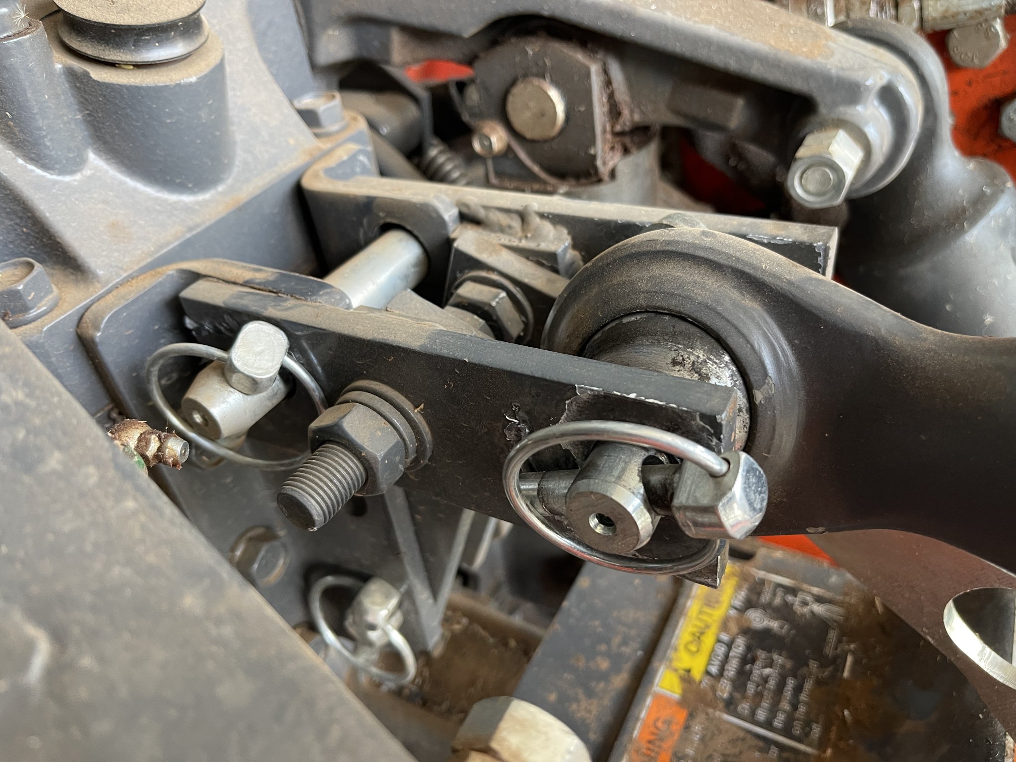

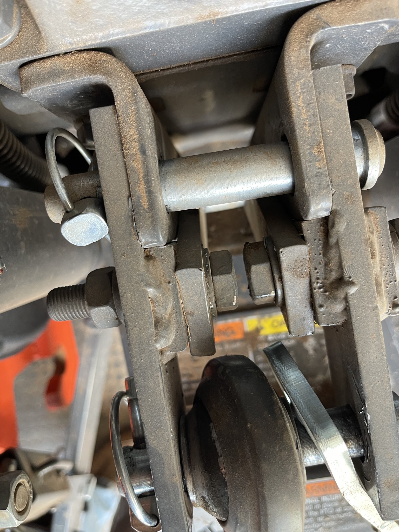

I had the same Issue. Here's my go at it. The horizontal pieces are 3/8x 2" flat steel bar. The diagonal pieces are 3/8 x 1.5" steel bar. Nuts and bolts are 1/2 inch. 7/8 drill bit also needed for the hitch pin holes. Put this in roughly 18 months ago seems to be holding up so far. Did a bit of welding but that's not required.

I had the same Issue. Here's my go at it. The horizontal pieces are 3/8x 2" flat steel bar. The diagonal pieces are 3/8 x 1.5" steel bar. Nuts and bolts are 1/2 inch. 7/8 drill bit also needed for the hitch pin holes. Put this in roughly 18 months ago seems to be holding up so far. Did a bit of welding but that's not required. View attachment 116814 View attachment 116816 View attachment 116817 View attachment 116818
That looks to fill the need. The bar on the right, whats it's purpose?
