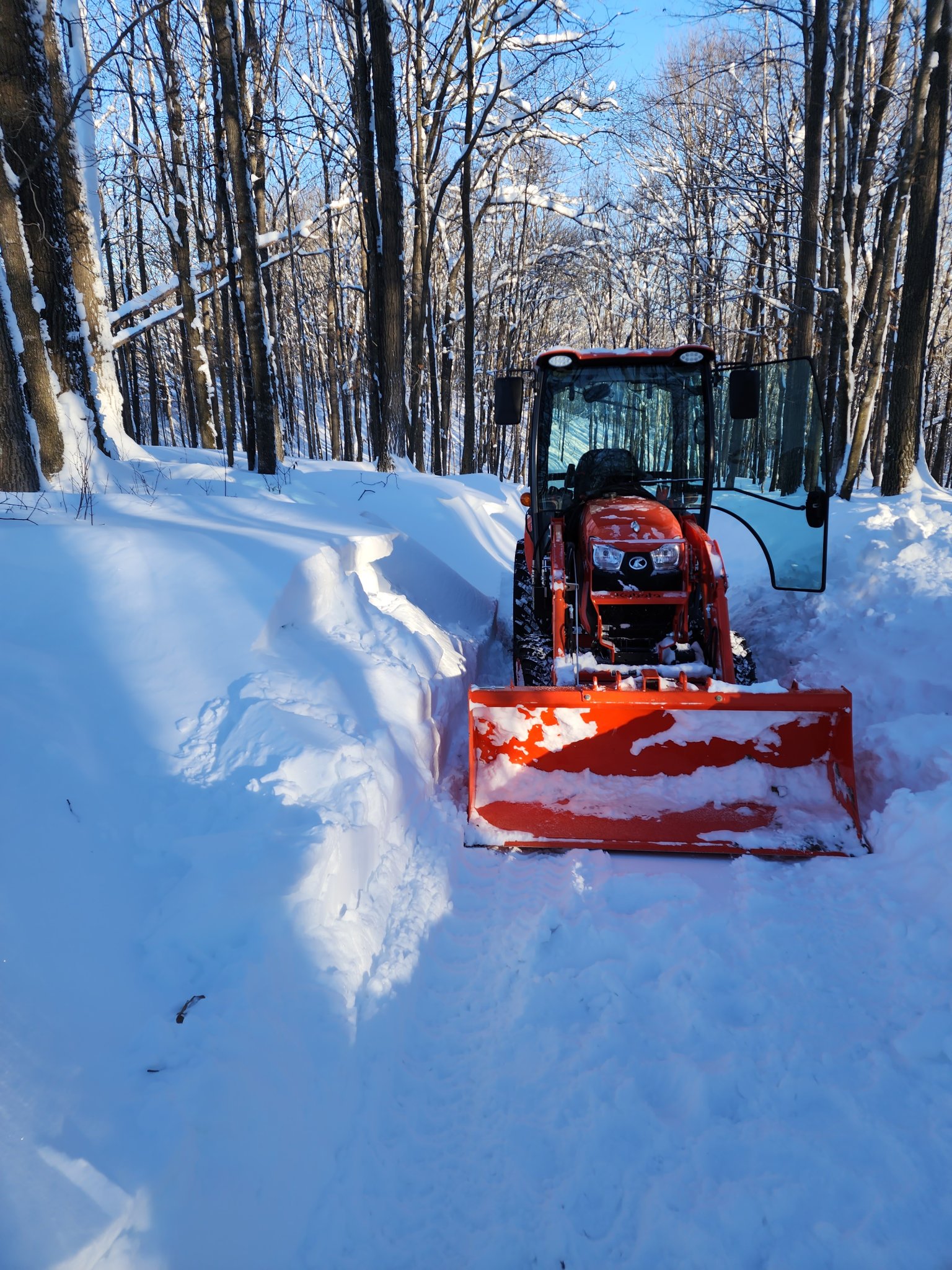

I have a LX2610 Cab with R14's bought new in 2022. Moved some serious snow and never needed chains. Or studs.
R14s are good for snow... if that is what you have.
Not they could hurt anything. . but your fenders.
