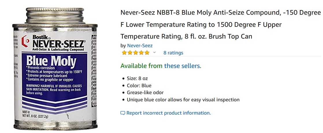

The Three Bond 1901 is an anti rust anti seize product using Moly.
From Three Bond's web site..
1901, 1910
This is a grease-type galling-preventing lubricant that uses
molybdenum disulfide as the base.
It has a low coefficient of friction, high lubrication, and extreme
pressure property, so it has excellent lubricity for heavy loads, and
can prevent abrasion, galling and seizure of parts.
It has excellent heat resistance and can be used at up to 400°C (for
galling prevention of screws and pins, up to 800°C).
There is a can type and an aerosol type available.
An equivalent product from Bostich which works from -150F to 1500 F.
The reason for use is to prevent the clutch disk rusting to the shaft splines:
Thee Bond has an American Office and you can buy their products. Call them to find out where their stuff is sold.

Thanks for that. So far the best match I have been able to find locally is Jet-Lube 550-Extreme.
