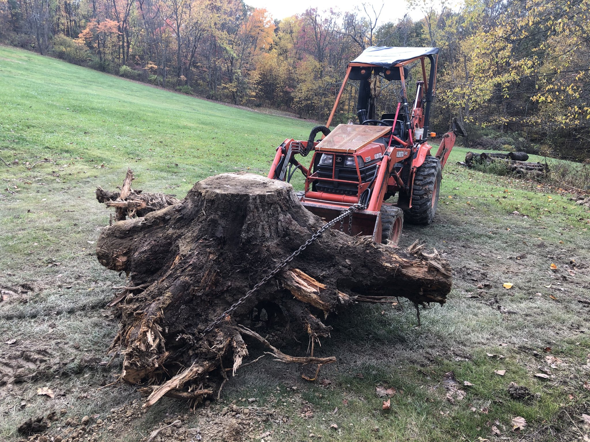

I have a B2910 which is the same size as the B2710, so probably one size larger than your tractor. I have the Kabota BL 4690A backhoe. It can do everything that you say you want to do. I would imagine that the backhoe you are considering will be satisfactory for your needs.
The only thing is, digging stumps takes time. You don’t say how big the stumps you’re talking about are. The stump in the following picture was a 24 inch diameter pine. It took me about four hours to get it out. That included time cutting the large roots with a chainsaw after cleaning the dirt off pretty much.
Hopefully someone more familiar with the specific backhoe you are considering will chime in and give you more specific answers.
edit: might have been 20”. But you get the point...;)
