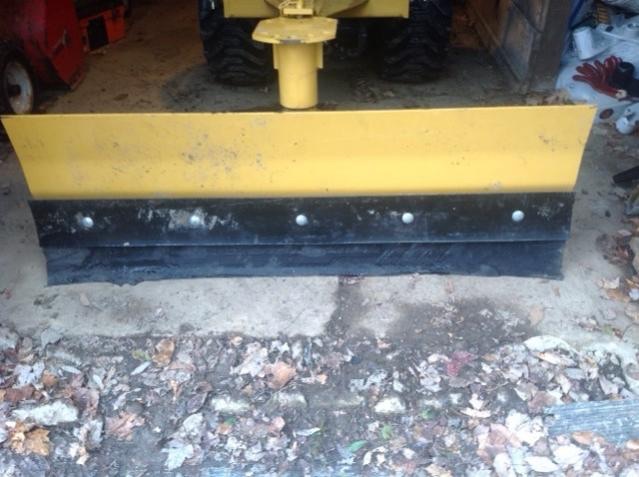

I used a piece of 1 inch thick rubber belting. I bought a roll of it years ago and used the circular saw with a wood blade to cut it. It was a rough and smelly job. The roll is 3 feet wide and about 15 feet long so I should have a lifetime supply.
Sounds like you have a perfect solution! :)
