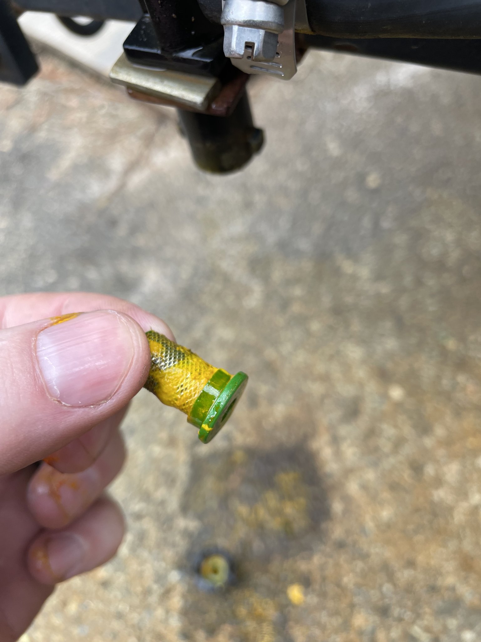

Took a second and pulled the nozzles on our JD sprayer. Here is what the filters look like.
As you can see, pre emerge is gunky. This unit has agitation while spraying, but hasn’t been used in a while, so stuff probably settled.
