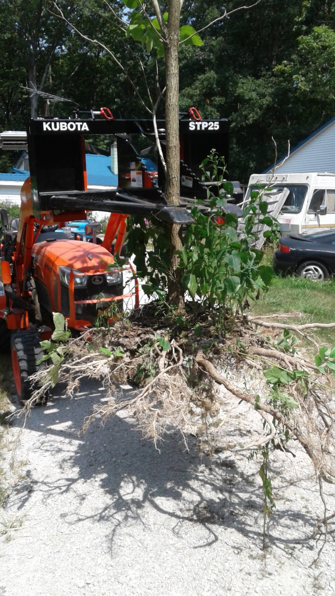

Small B2650, If I had an MX, would have bought this. Better protection of cylinder for digging.
If grapevines are small a root grapple may be the better tool. Saplings smaller than 1/2" diameter the tree puller crushes it and snaps off rather than pulling
