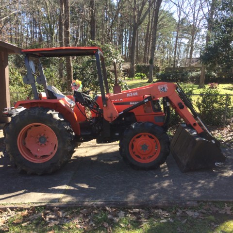

I "chased" the holes on mine which really didn't remove anything other than the slightly out of alignment edges. But of course that doesn't matter now because mine is now a 4 post.
I love that lid over my head. (y)
