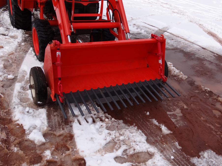

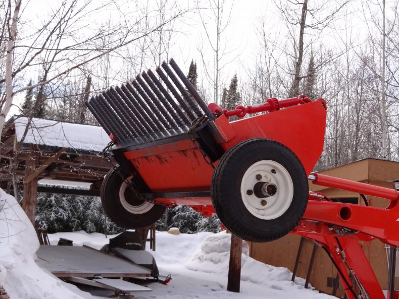

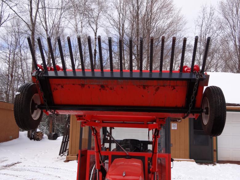

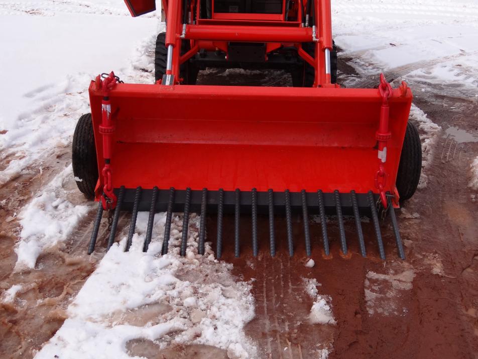

In the spring when I grade my long driveway large rocks come to the surface. I built this rake to pick the large rocks up. They should roll into the bucket and then I can dump them without handling them. The wheels are there to keep from digging to deep. I will let you know how it works. Unfortunately the snow keeps falling!!
