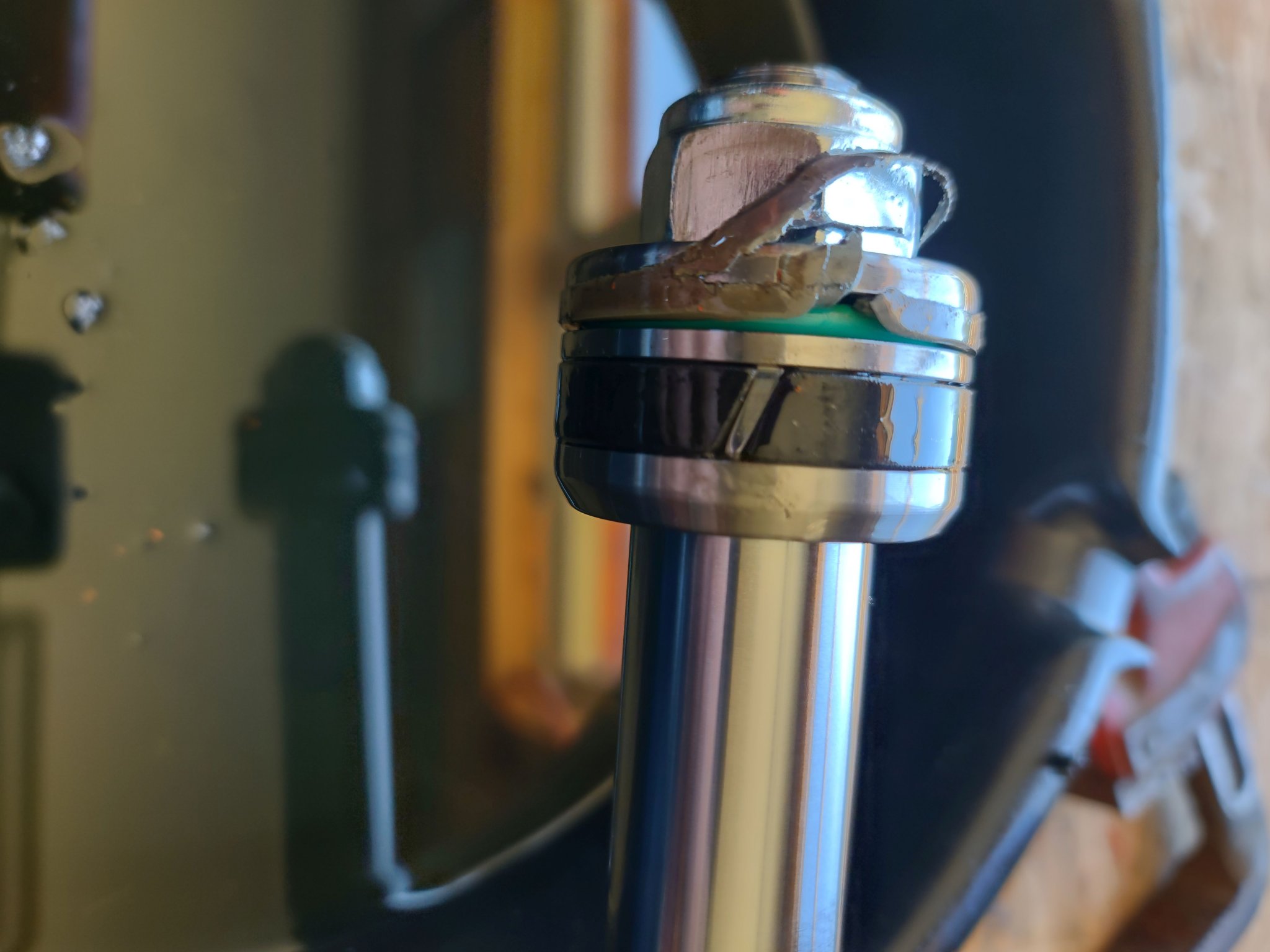

Ouch! You got hit pretty hard. Here's my post from a year ago.
Jun 12, 2020
Your best bet is to disassemble it and carry the piston and gland into your local hydraulic shop. Have them put the seals on for you. Check the rod for straightness before disassembly by turning it. I did mine right on the machine. My guys up here charged me $30.00 on a Friday at 3:30 for the 3 seals and o-rings.... and installed them!
If you're not able to do that just take them the cylinder.
Clarification on the rod straightening.. the one I resealed I straightened with v-blocks in a press. The other one I unhooked the rod end and rotated it, marked the bent area, put a 4x4 under it, then slowly curled the bucket until I got it straight. Also note the bent rods were caused by broken dump stops... always check them.
P.S. I thought the $30 price tag was very unreasonable so I also gave him a $20 tip. Just having him roll the internal seal in the gland was worth that!

bent rams bind while in operation. The spec on bend is something like .015", so basically "not much" is allowed. That's one of many things I always checked (bend) when I was doing a bunch of cylinders. As long as they came apart easily, it was an inexpensive repair, typically labor under $100 + whatever parts cost. On average $175 roughly.
With that said if I had a bent ram, I replaced it or gave it back to the customer whichever he wanted. The ram shafts are plated and case hardened. When they bend, the "shell" becomes damaged and a lot of times would flake off with no warning whatsoever, even when they looked fine. When that happens the rod is junk, and it usually takes out both the dust seal and the main gland oil seal then you're back to square one. Real common on backhoes and loader tilt cylinders.
