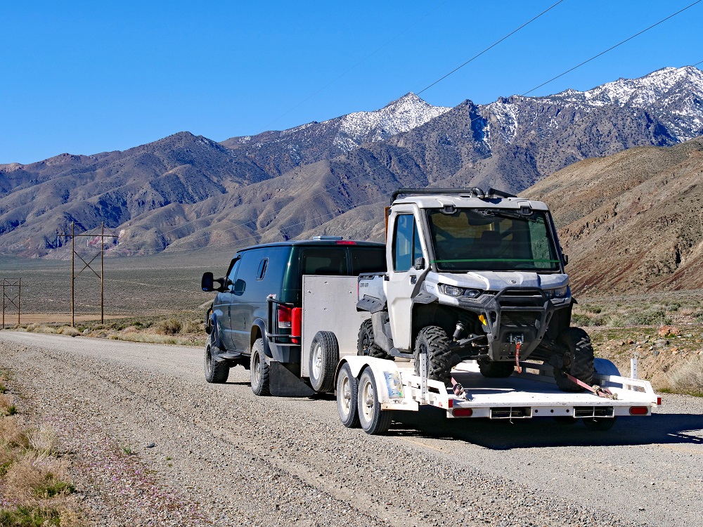

Fwiw, I recently trailered my Polaris Ranger a few days. I found ratchet straps loosened up. Not completely, but a click or two. These were two inch straps.
Biggest mistake I see when strapping down side by sides or Jeeps is attaching the straps to the body or frame of the vehicle, then cinching the suspension down. Straps should ALWAYS be attached to axles or the wheels themselves.
I've many thousands of miles towing my Can-am Defender - I bet I've towed at least 1000 miles in the past month alone. I use heavy duty 2" wide "Snappin Turtle" brand ratchet straps attached to axle straps wrapped around a suspension component, as close to the tire/wheel as possible, and never have one loosen after being snugged down. Straps are designed with a bit of "stretch" built in and the straps must be tightened down enough to stretch - that keeps them tight as the vehicle moves around on the trailer. Guys I ride with also use the webbing that goes over the wheel itself and they seem to work very well also.
