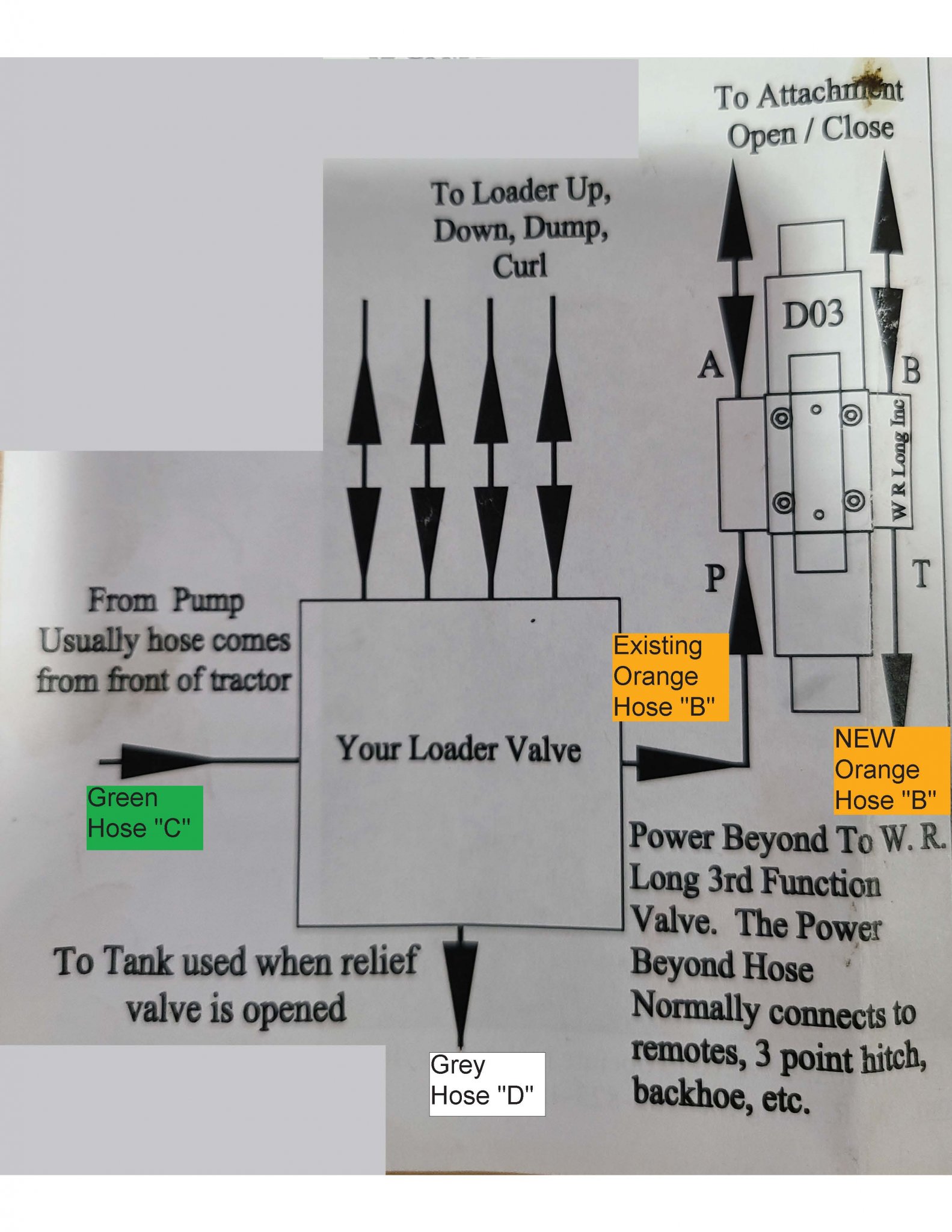

I have installed a 3rd function valve kit to operate a remote valve kit. I believe everything is installed correctly but when i did a test run i blew the gaskets on my bi-rotational pump.
Tractor = Kubota MX5100
Bucket = LA844
3rd Function Kit = W.R. Long
Remote Kit = Tractor Innovations
Can anyone confirm which port (B, C, D) shown in the photo below is the "Power Beyond Port" which is mentioned on the installation video of the 3rd Function Kit. My tractor manual uses different terminology.
Let me know if you need any other information.
Thanks for your help

It looks to me like you are trying to connect to the hydraulic supply, not the loader valve. The PB port will be on the loader valve and feeds the hose to port C on your drawing. If so, I think the hose currently connected to C needs to go to the P port on your 3rd function valve and the T port from the third function valve needs to go to C, according to the drawing at wrlong's website: https://www.wrlonginc.com/_files/ugd/701dd3_4fb5a989c44f4e06964d90dea466d811.pdf
(A and B go to the cylinder being controlled by the third function valve)

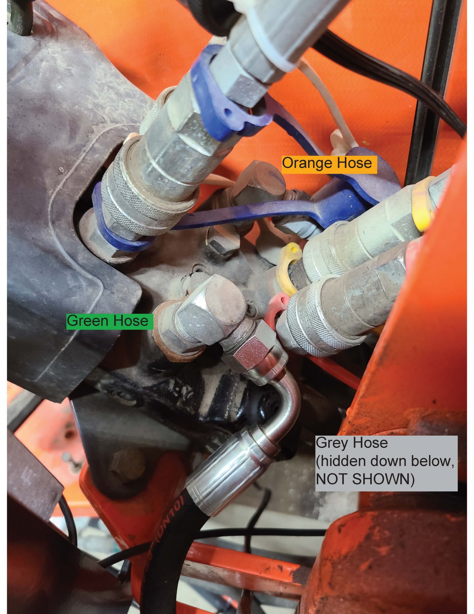

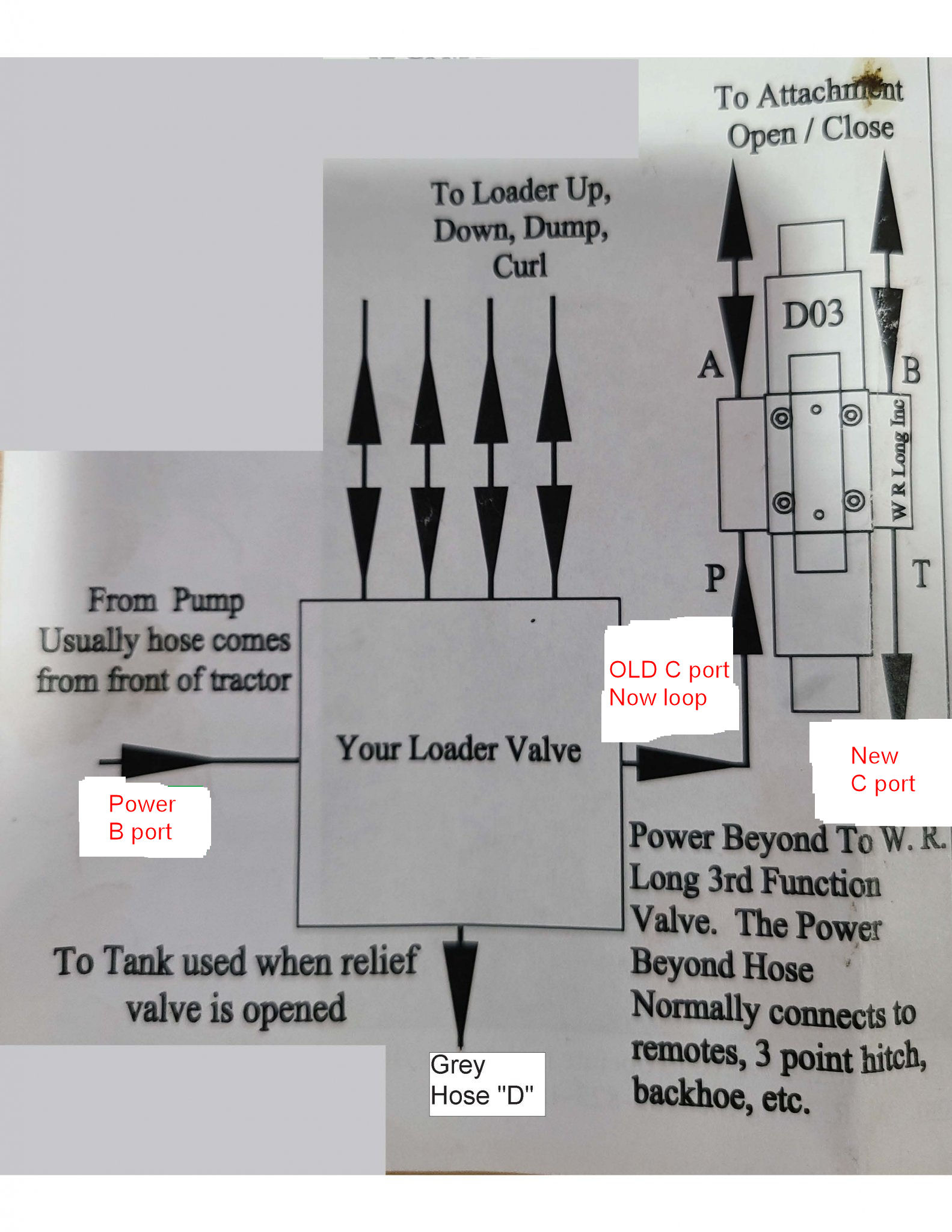

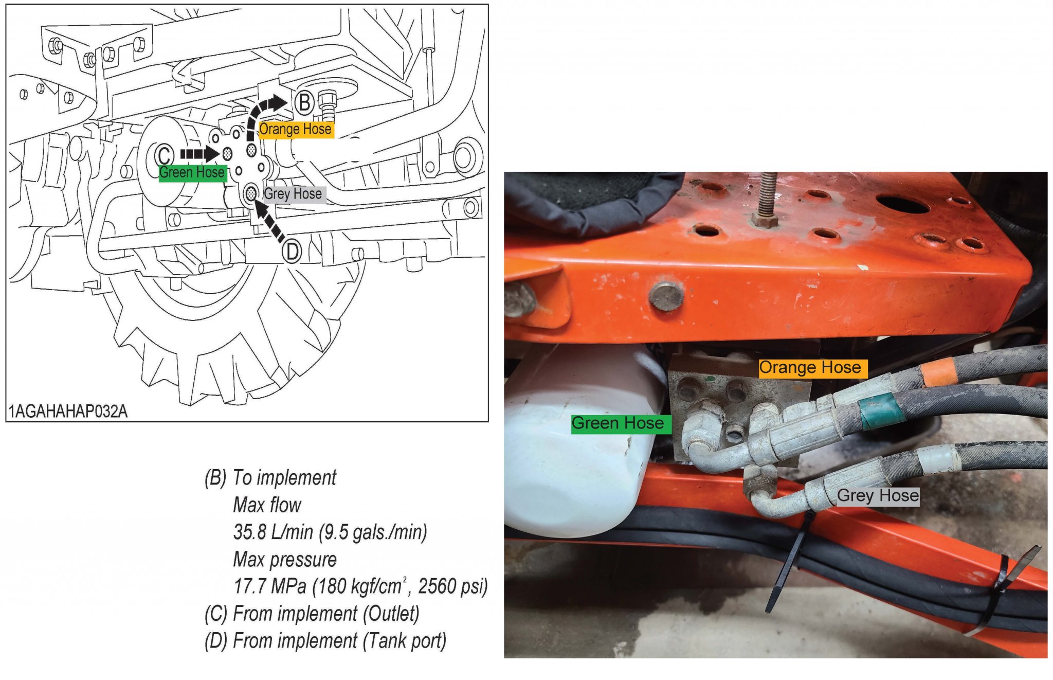

Hey Torch, Thanks for the quick reply. I have limited experience with hydraulics so I appreciate all your help.
You are correct, I am trying to connect to the hydraulic supply; basically insert the 3rd function into the sequence of valves (before or after the existing loader valves, doesn't matter to me).
Please confirm on my third photo: are you saying that the Orange Hose is the Power Beyond Port? (This is "Port B" shown in the manual on photo #1).
Thanks
29,705
5,907
B (top right) is Power
D ( bottom) is Tank
C (top left) is Power Beyond

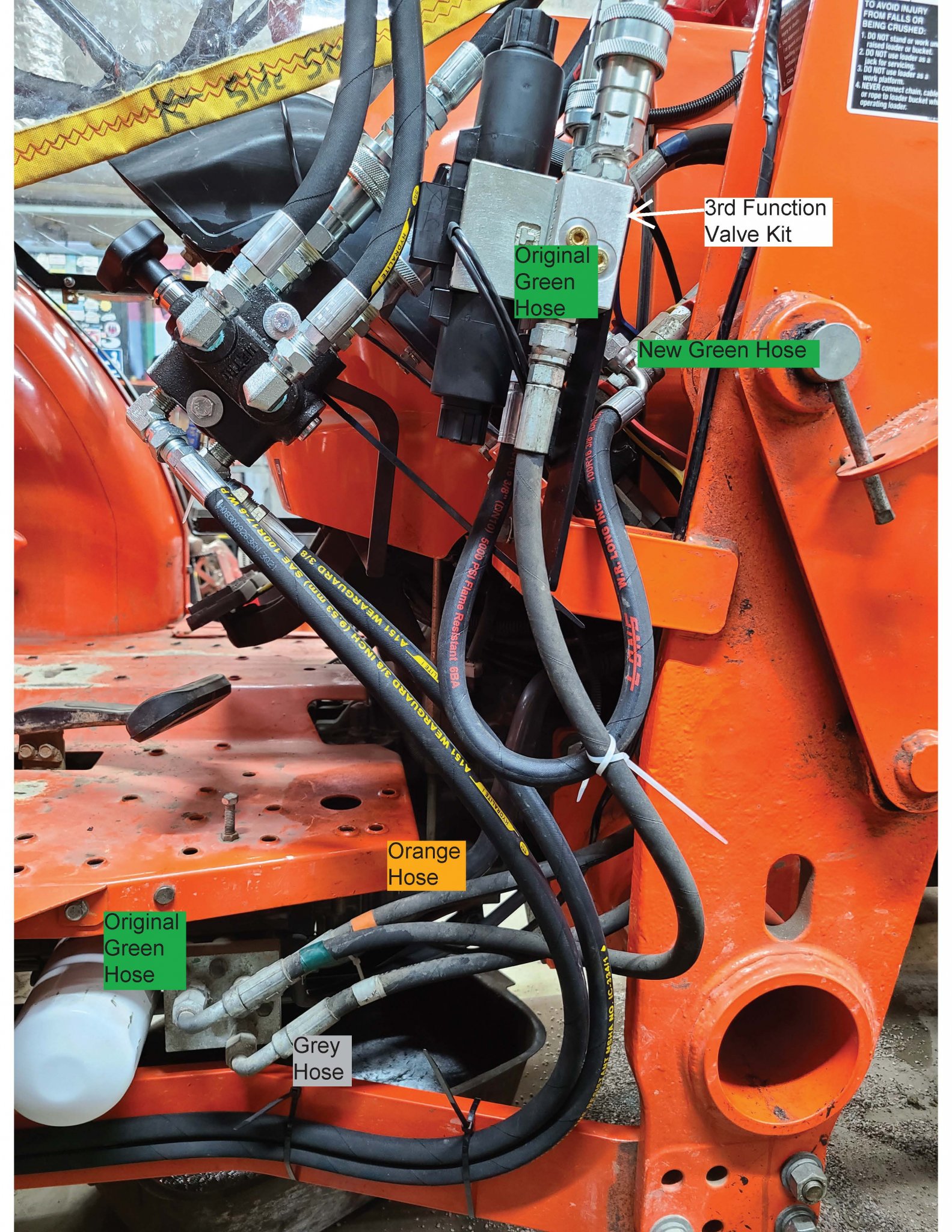

29,705
5,907
Are you running another valve after the WR Long Third function valve?
I'm talking about the valve with the star knob in the first picture.
Is that control part of the Motor control that your working with?
