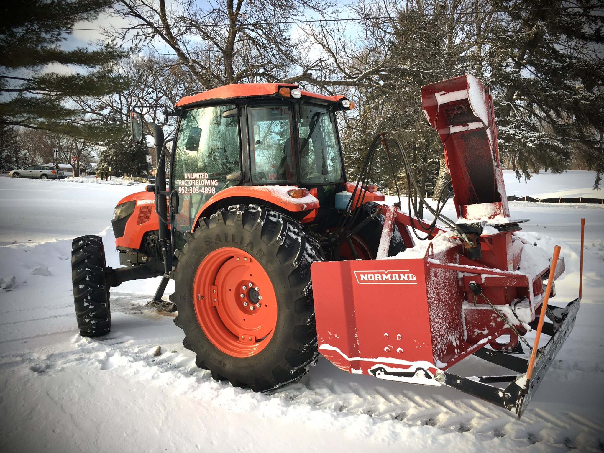

I have the perfect retirement job that pays really good. Driving a Kubota with snow blower, not sure of the term but I drive forward dragging the blower which faces forward too.
I do 63 driveways which takes about 5 hours over some 40 miles.
After my first time out this season my left thigh muscles are sore from all the clutching, backing up, drop the blade/blower drive forward. I am in high gear range number 3 usually lower gears tend to want to wheelie on releasing the clutch. But then the tractor speed is too fast and I have to clutch again to slow down. It has a turtle gear button on the shifter that I understand puts it in crawl mode, or the low range of the tranny? I don't use it but maybe should?
the thing about driving in low revs to go slow not good because the blower needs at least 2k rpm to blow clean when the snow is wettish. i can Get pics of the controls this weekend. What am I doing wrong? whats the most efficient way to use this tranny?

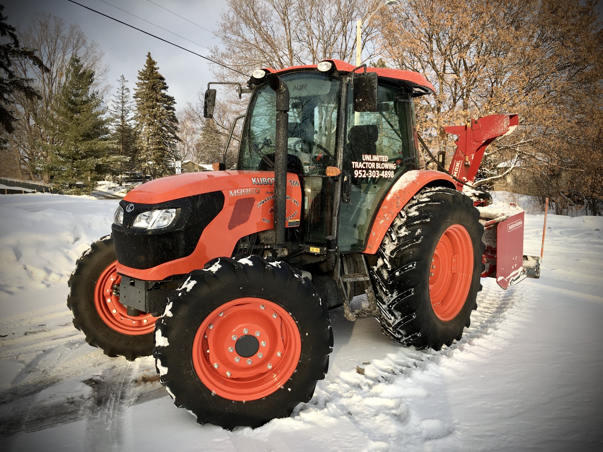

Nice set up!!!!
