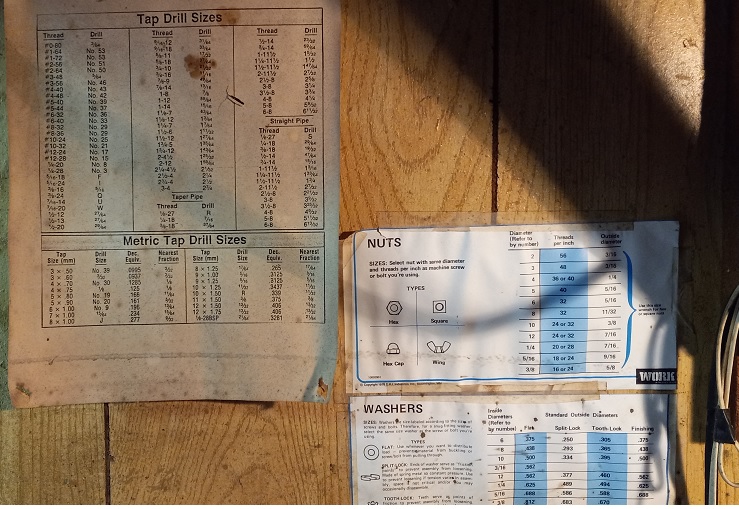

Was in the machine shed and saw these on the wall. It has been a long time. Now you machinist may have all this committed to memory and the young ones have it on their phones. But next to the old rotary wall phone are the sheets.

As many things change, it’s kind of nice to be reminded some things don’t. Still as valid as it ever was.

I have similar charts posted up on the wall beside the lathe and another beside the drill press.

Mine are attached to the lid of my tool box. I still refer to them a few times a year, mostly for fractional to decimal conversion.

Mine are in a book of tables laying atop my taps and dies…. ever since I bought my first set….in 1969.

phone dont work in the shop and yes I have tap/drill charts stapled to the wall near the drill index and drill press. Also have a drill index chart that gives actual sizes of each bit.

Easier and more accurate. On my DROs you enter number of holes, starting angle, and diameter. Then just hit next for the X-Y offset from current position to first/next hole.
I have multiple wall charts and Machinists Handbook for things like tap drill sizes but the cell phone is usually closer, much easier for old eyes to read, and faster...

I still refer to my charts occasionally but I have most of the common sizes memorized. Tap drill size for inch taps can be found using this simple formula:
Tap dia - (1/pitch) =tap drill size.
Example for a 1/4”-20: 0.25”-(1/20)=0.200”.
The correct drill is a #7 which is 0.201”. That is the closest size to 0.200”.
Metric taps are easier.
Tap dia - pitch = tap drill.
Example: M8x1.25: 8mm-1.25mm=6.75mm
1”=25.4mm
1mm=0.03937”
