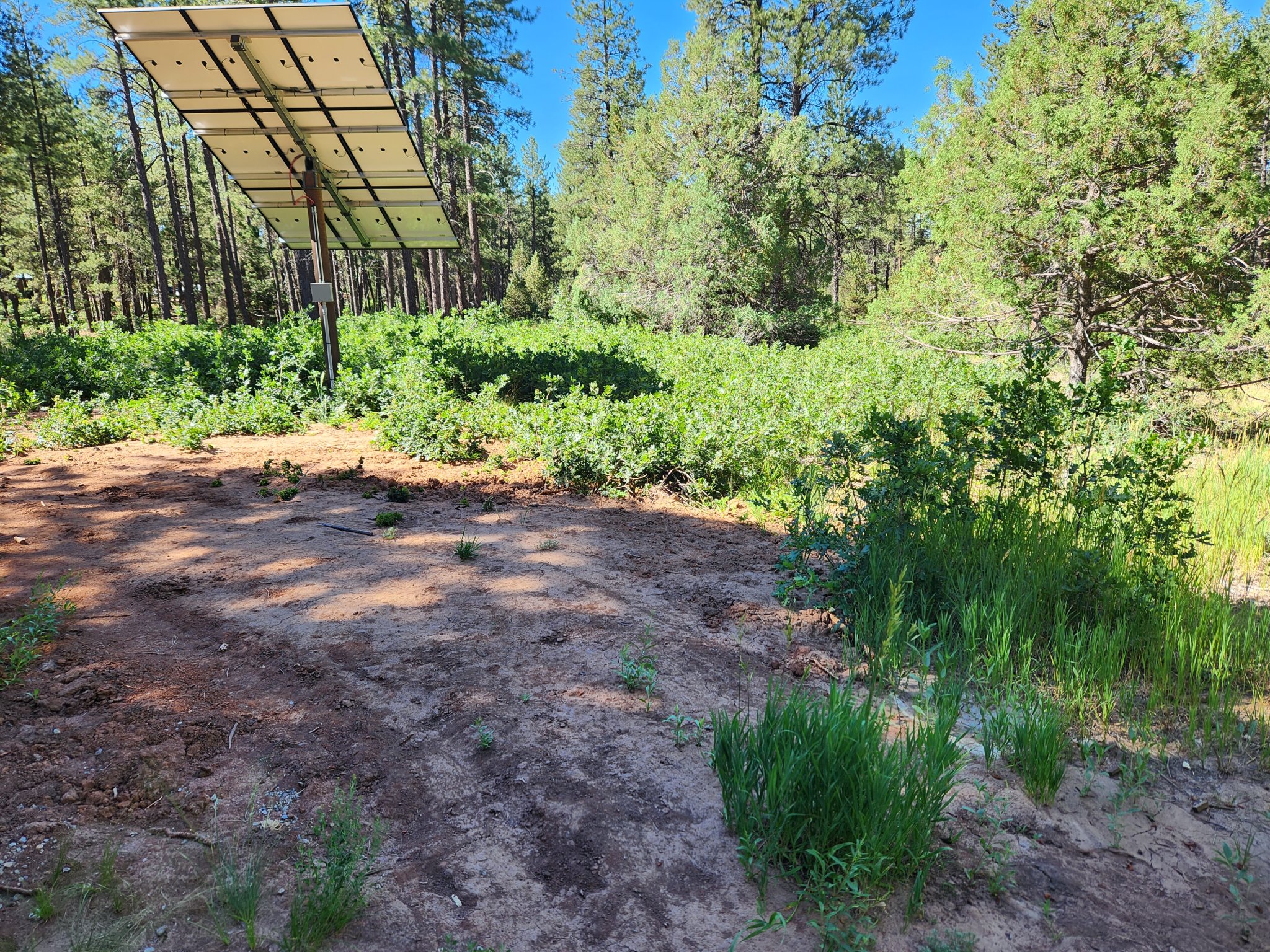

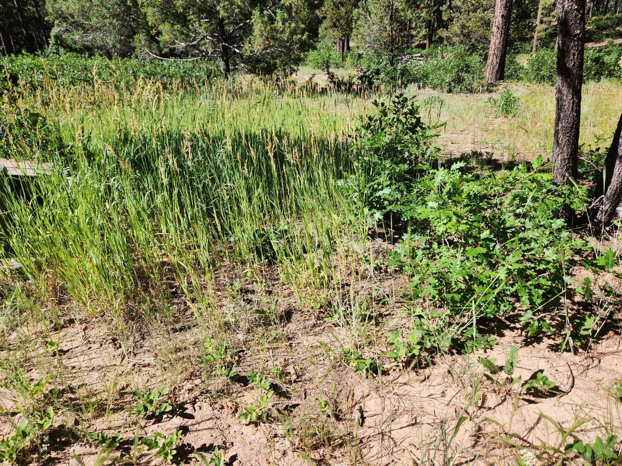

Here is a pic of the scrub oak...this area is more open than most of the land...pretty condensed. I think I would go without the cab...at least as of now.
