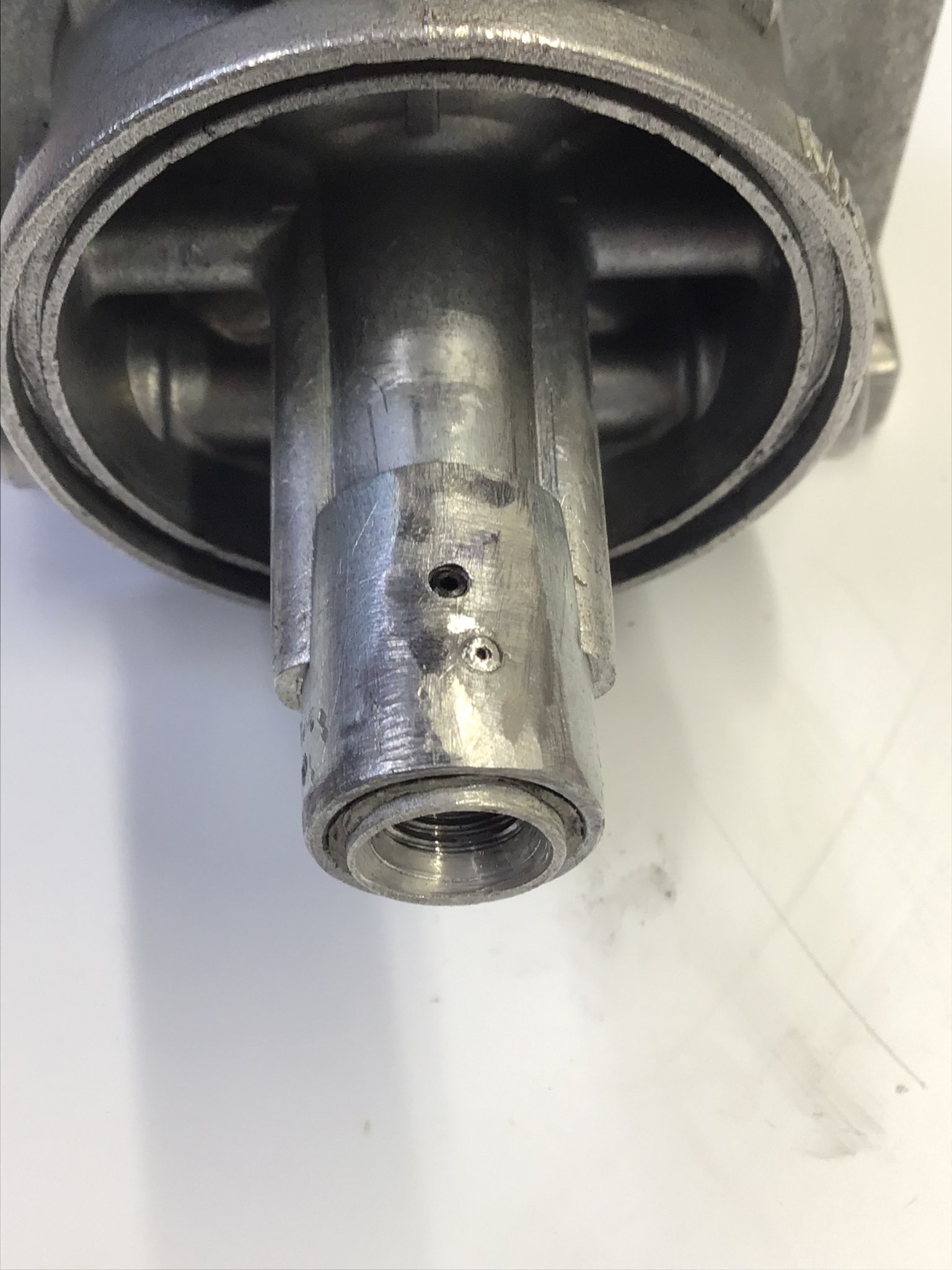

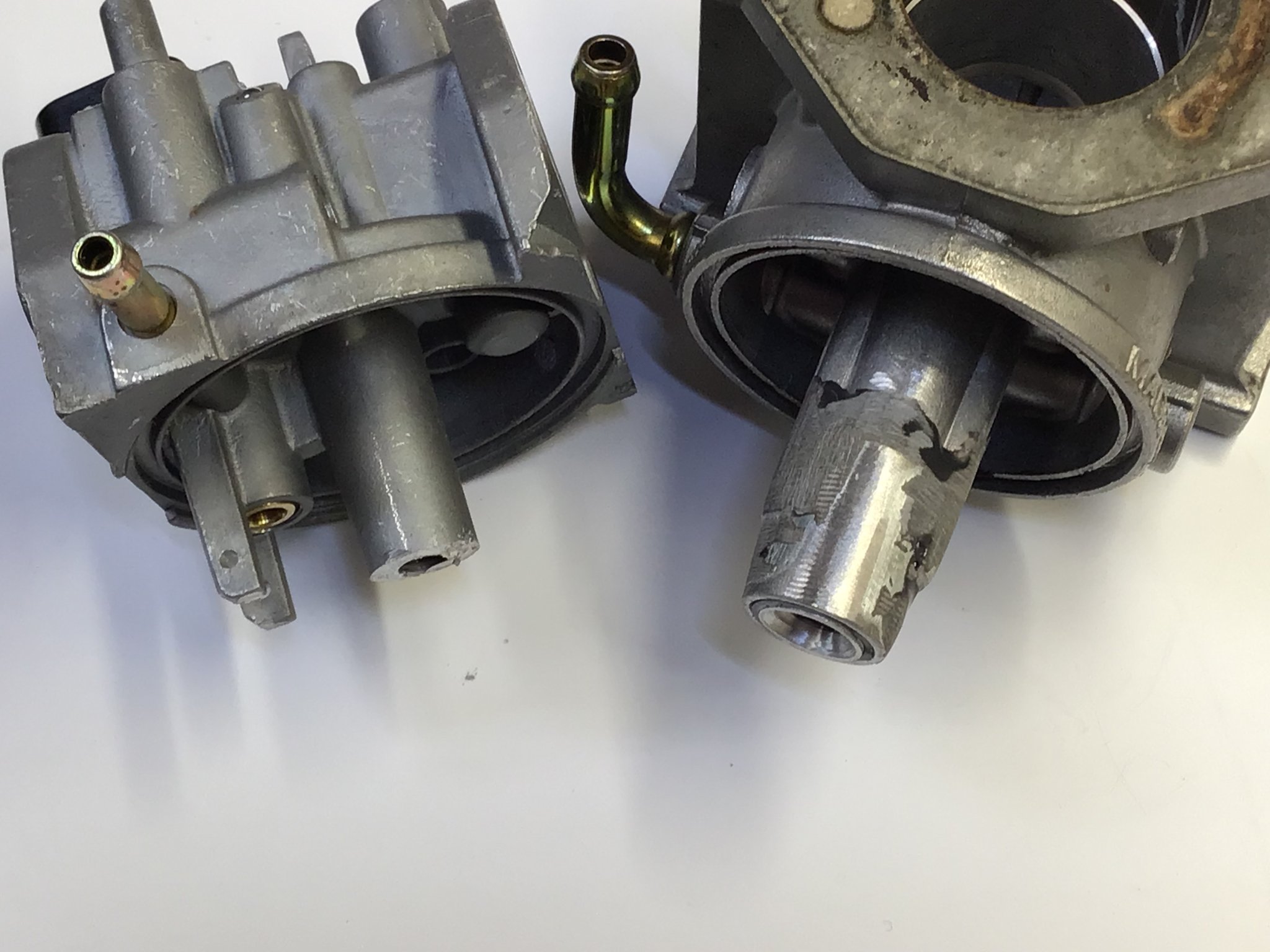

I purchased a used Kubota AV6500-B-USA Generator yesterday, It was listed as, needs carburetor work for $250 I figured how could I go wrong, when I looked at the generator I noticed the float bowl hanging below the carburetor, the F.B. gasket was leaking The previous owner over tightened the the bowl retaining bolt and broke the internal threaded housing in half. its a Mikuni Carb. #12008C below that number is 2 V651 looks like the Kubota P.N. 320400 does anyone know where I can find a used carb or know of any manufactures that used this style of carburetor on their engines? I searched for the Mikuni numbers with no luck, this generator only has 25 hours on it, He told me it was his grandfathers and it was purchased in or around the yr. 2000 if I can find the upper carb housing to match, I can transfer the jets and other carb components I’ll try to post some pics Thanks for any help

You could try shade treeing it.
Find a bolt the size and thread of the bowl bolt.
Clean/sand all around the broken area.
Lightly oil the bolt and place it in the remaining threads.

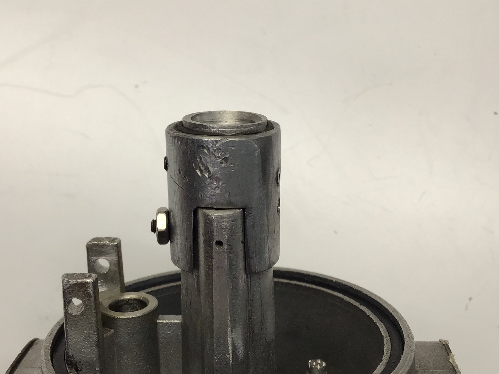

Use J B Weld to replace the missing part. I would find a short piece of metal tube to slide over that area to reinforce it and help mold the epoxy.
When it has hardened, remove the bolt and grind or sand off any excess.
Install the bowl and bolt. Check the bowl level and needle valve first.

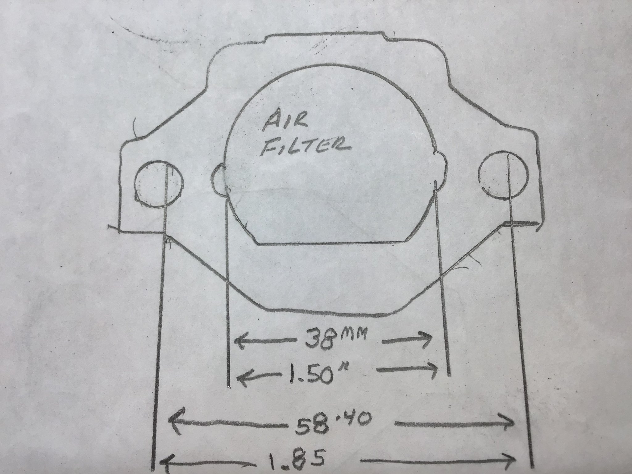

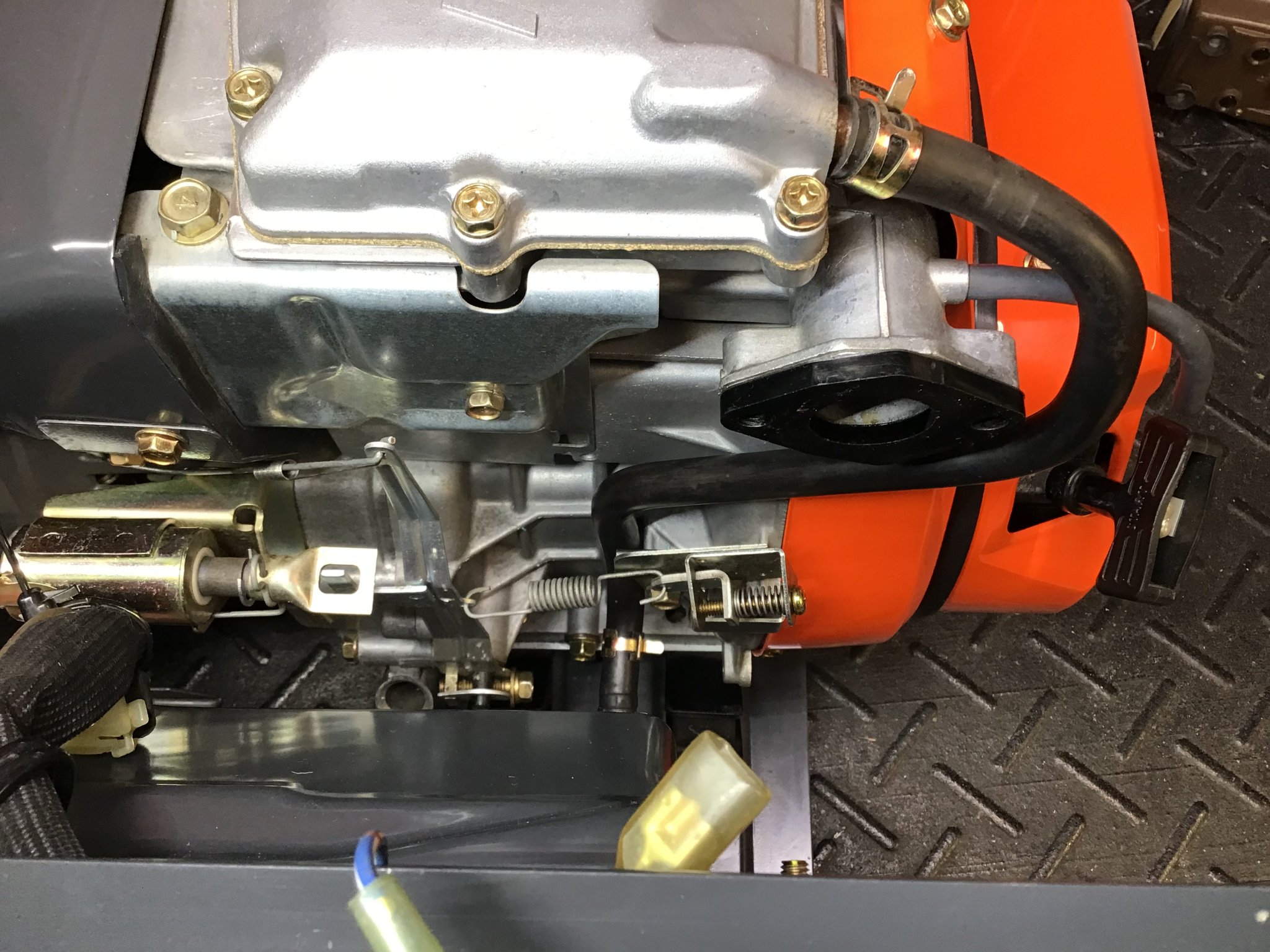

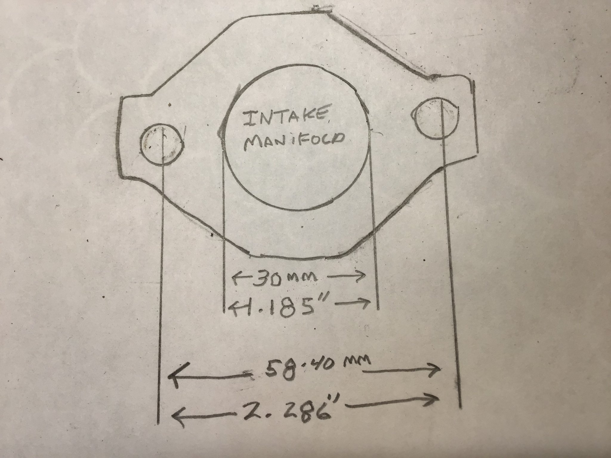

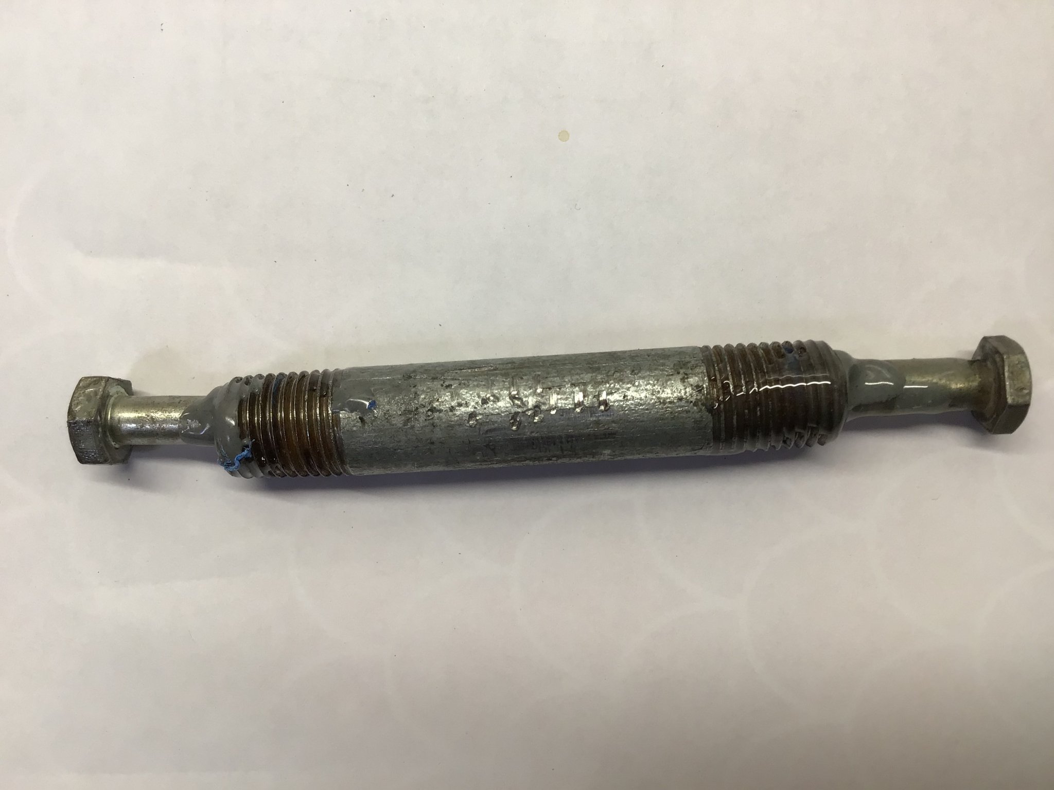

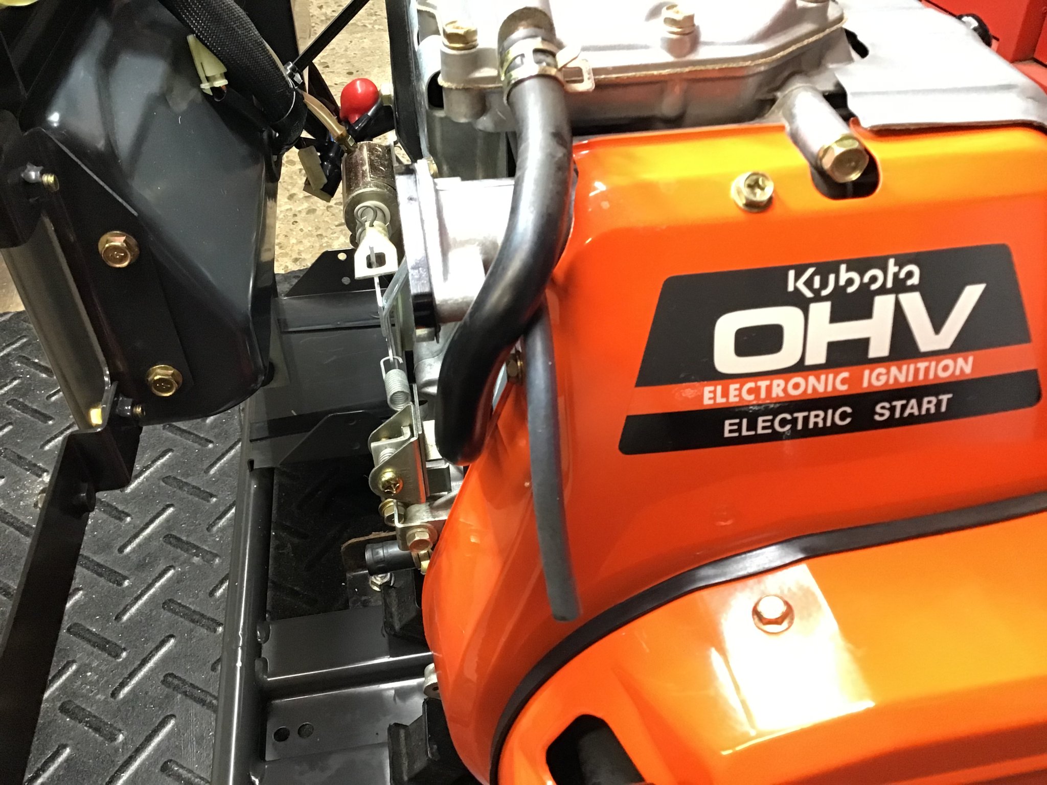

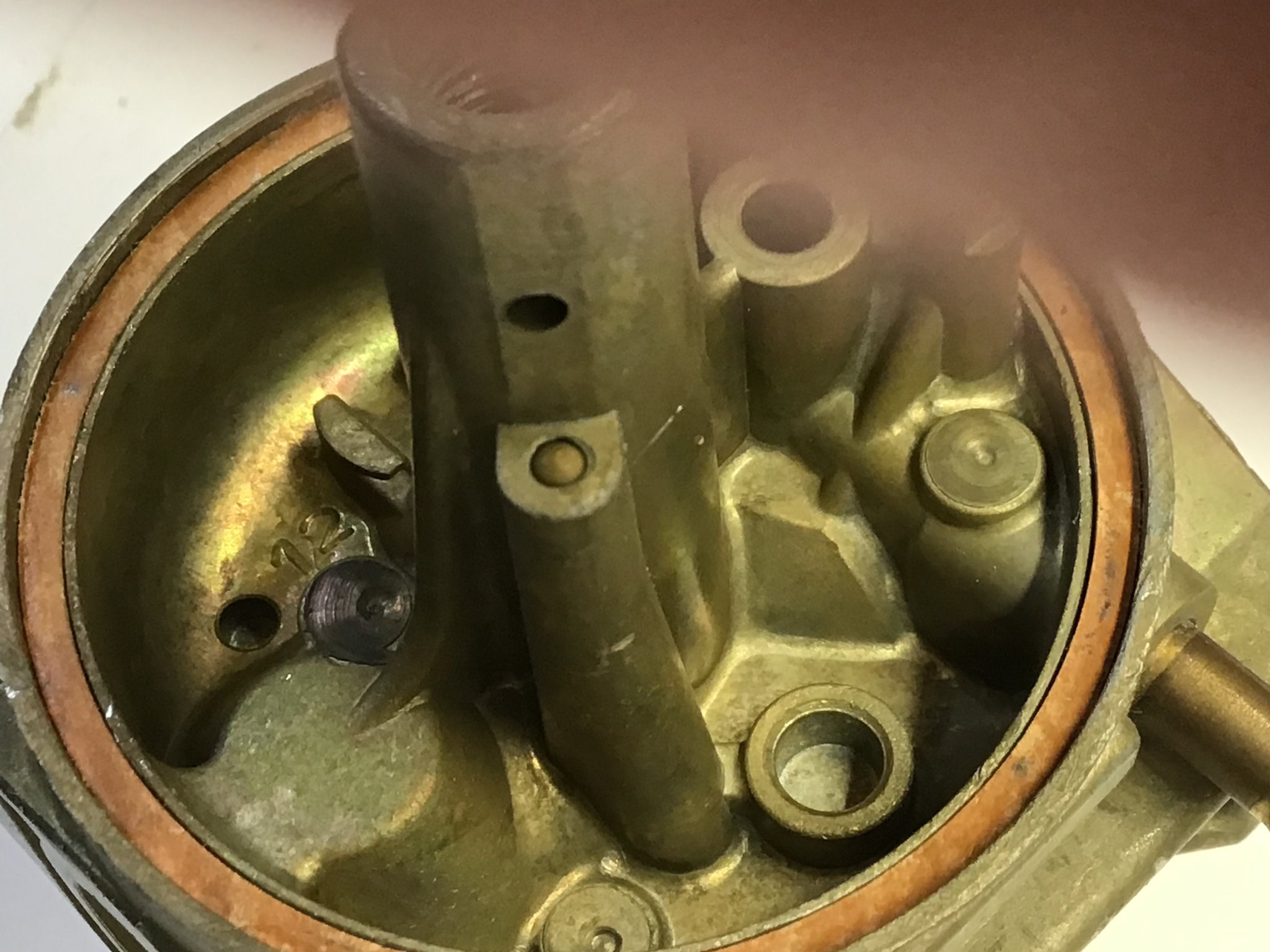

I would like to thank everyone for their input, I‘ll post a few more images I do have a few questions from the responses starting with, Is JB Weld resistant to solvents ie: gasoline? if not can anyone recommend any kind of epoxy that is resistant to solvent? I do have some bushings that I could use as a sleeve, I used a 3/8 piece of pipe and used JW Weld on one end with a lubricated bolt and the same on the other end with some 608 Clear Epoxy patch. I was going to soak it in some gas to see how well the epoxies hold up, my other question is about the propane/natural gas conversion kit, i’m not familiar with these conversion kits, can anyone recommend a company that sells them, would I still need a carburetor? I’ll attach a couple pic’s of the carb’s bolt & bore openings just incase someone might have a carb that they could recommend. And a couple pics of the intake manifold to see how I could add a Multi fuel set up, And thanks Wolfman I did look at the carbs you recommended but they were to small. Maybe I could Ck. To see if theres A Mikuni carb forum, I would probably have better luck finding the stock carb, Thanks for all the suggestions

'JBWeld ' is a mixture of epoxy and steel filings, so 'ok' for gas.
as for replacement carbs... check similar power(HP) gas engines.

Yes......JB Weld is fantastic stuff, and is unaffected by gasoline.

JBW is steel-reinforced epoxy. Should be fuel resistant, their site has a gas tank repair technique. But it uses the putty style which I'm not too keen on.
If the threads don't hold, you might embed an insert.
Century sells dual- or tri-fuel conversion kits. I have no experience with them. You still need the carburetor, maybe not the fuel tube, etc. The auto idle might still work.

5 years ago I repaired the aluminum elbow exit from my Kubota M4700 fuel filter/ water separator which kept leaking because the elbow was only pressed-in to the valve assy. This is a common Kubota type filter. JB Weld fixed it permanently. JB Weld is gas, diesel, oil, fuel-proof.
