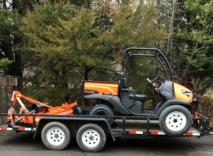

I have the Landpride RCR1884 rotary cutter and have used it for the last couple of summers. Overall it's a good cutter but I wonder if a dual spindle would have been a better choice. I've removed the blades a couple of times to swap them out with a sharper set ( I have two sets) and it's a bit of a hassle with access to the blade bolts via a hole in the deck. Now that I have an M18 impact it should go a lot faster since the IR air impact and IR compressor struggled with those two bolts.
Elliott in GA
Mar 10, 2021
744
726
North Georgia
Very nice. However, the front tire on the RTV seems oversized in your photo. ;)
