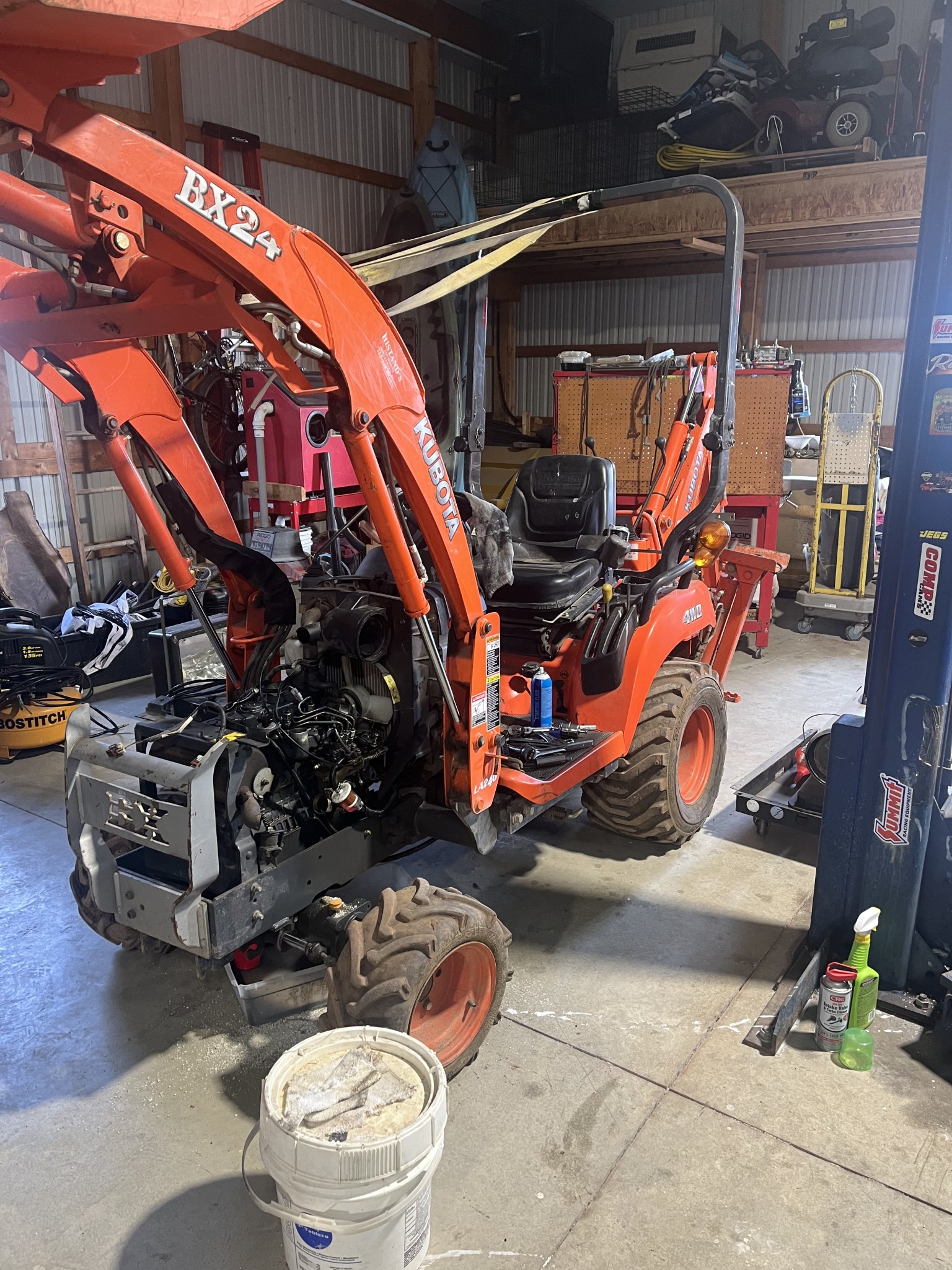

New here and looking for some advice.
Got a line on an 07 BX24D for $4500. LA240 loader, BT604 backhoe and a brush hog included.
“Low hours” but haven’t confirmed what’s actually on the machine since I cant get it started.
Cranks and seems like it wants to start, but just a bit of white smoke.
Shutoff solenoid operating fine, fuel pump seems to be in order. And bled the lines after draining and refilling the fuel and new filters.
The seller wants it gone as is. With the implements i don’t think its a loser for me, but what am I in for?
What else should I check/test before forking over the cash?

If the price is right take it and run, the D902's are easy to work on and easy to get parts for.
Once home do a compression test, that will tell you / us where to go next.
DO NOT use stating fluid on it.

yeah, I copied, zoomed 1st picture... blue can says 'starting fluid' on it !!!!
still, offer $4000 knowing you have to rebuild the engine. pretty sure the loader and BH could be sold for more than that or replace engine for $3K ? and well under 10K you've got a very nice machine !

Thanks for the quick replies here guys, much appreciated. And the starting fluid wasn't me, i swear!
Hopefully I get a deal worked out with the guy and bring it home this weekend.
11,642
5,027
backstory..... from the pictures...
it wouldn't start, he USED starting fluid(ether), engine's kaput, wife's fed up, ie get that junk outta here, 'yes dear', so the low price 'won'tFIRE sale.
if I was within driving distance, I'd buy it, nice 'winter project'..warm garage, nice tunes, no phone, and some orange to work on......
