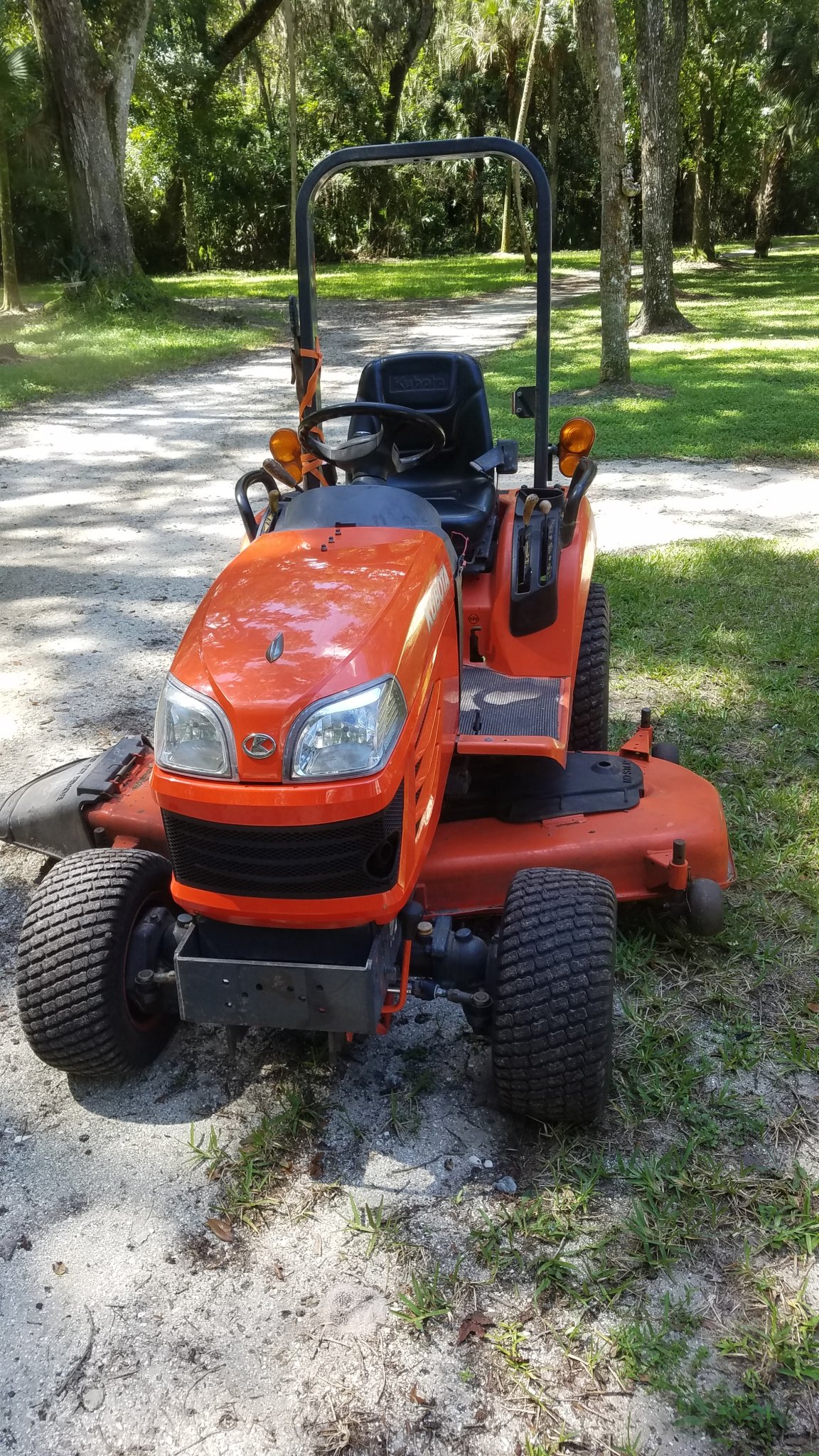

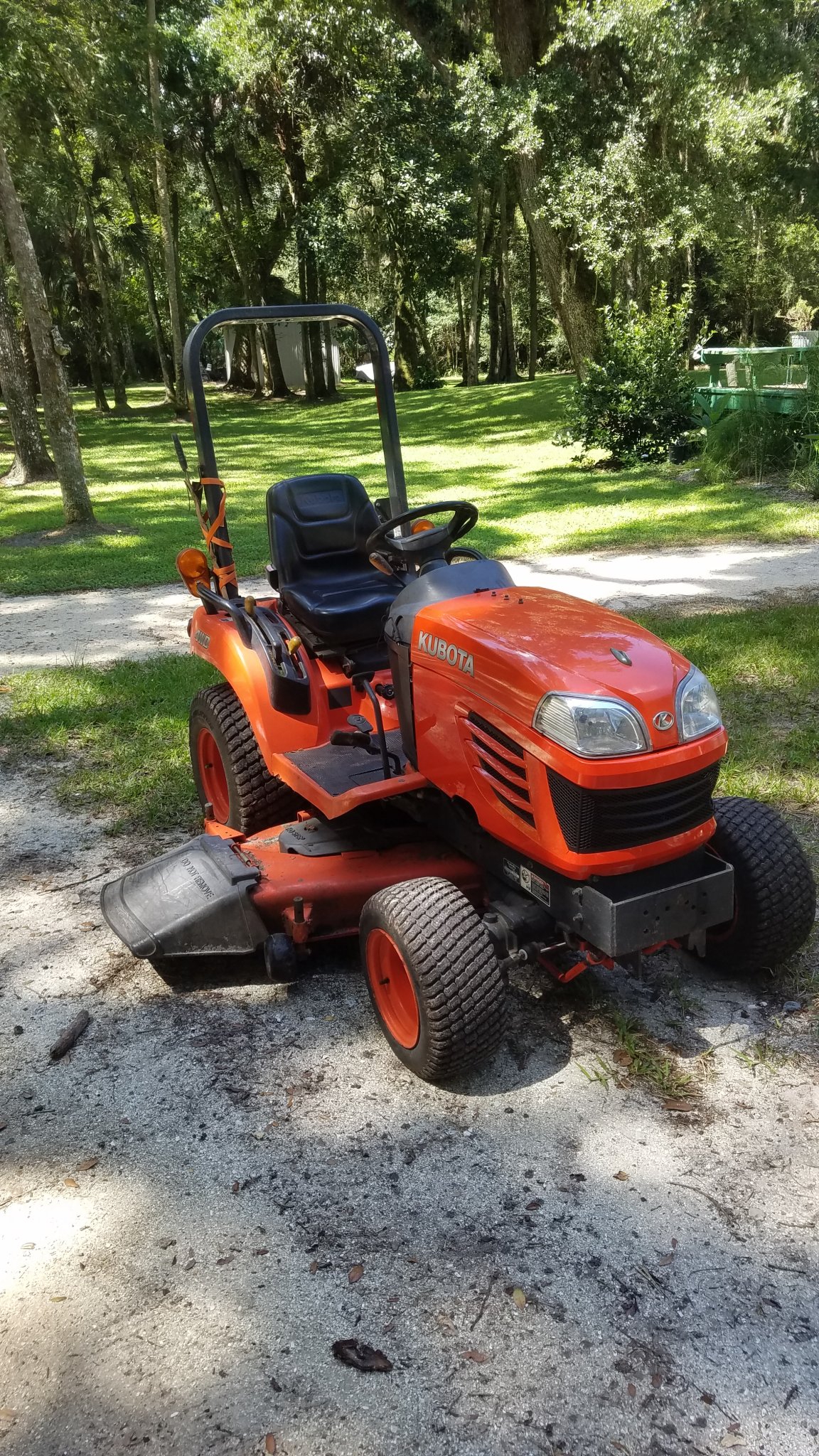

While cutting grass my temperature gauge always used to run at 50%-60% @ 90F outside most of the time.(Year 2008 with 2980 hours) Now it has been running at 90% all of the time and will go into the red if I don't slow my rpms down below 2500 . I always clean the filter screen and blow the radiator with air. Everything I have done recently to fix the problem has been to rebuild the HST shaft bearings, rebuild the 60" belly mower deck, took the radiator out and washed with radiator cleaner, changed thermostat, new upper and lower radiator hoses, cleaned fan blades, new water pump and belt. 50/50 antifreeze. Still runs 90%. What more can I do? It runs and starts perfect! Any ideas welcome...
