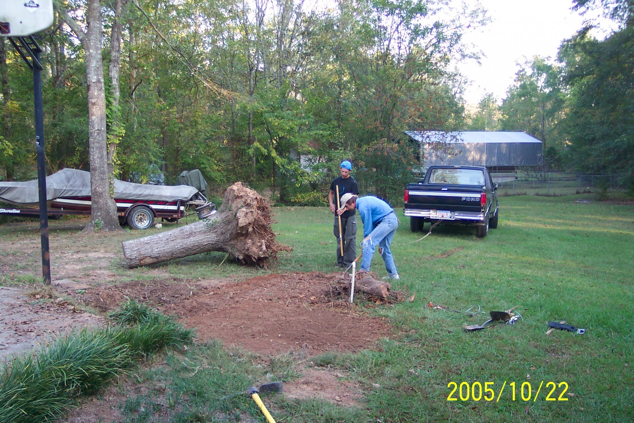

And yes, always leave a long stump if you're gonna dig it up anyway. I try to leave about a foot of height or more for every two inches of diameter at the base of the stump, and I always try to pull with the back (heavy end) of the tractor. Attach the chain to the stump as high as possible, and as low as possible on the tractor. This will decrease rear wheel traction as you pull harder, and let the tractor spin rather than standing it up. Hydrostatic drive is a lot better than burning out a clutch for this fun little activity. Same goes for a loader.
Anything is going to beat doing it this way:

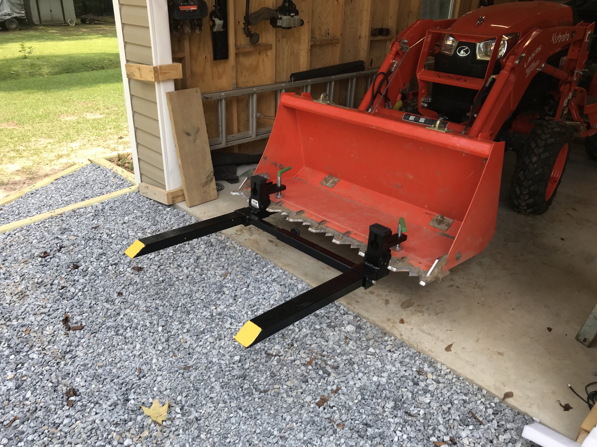

Not quite the fit I would prefer with the tooth bar on, but it’s quite stable with the stabilizer and I don’t plan on trying to pick up anything stoopid heavy with it. I’m a limited on the spacing of the forks with the tooth blade on, but I don’t think it will be much of an issue no more than I lift things that I can’t wrap with a chain.
