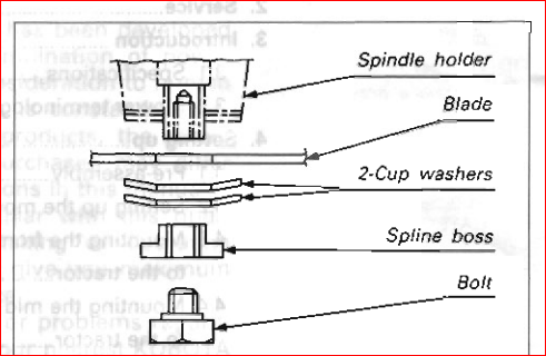

Anything on this picture what you are describing?
If you are talking about the spline "boss" - a good "tap" with a "hammer" on the blades should vibrate it loose.

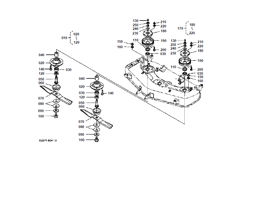

It sounds like he is trying to describe part number 60 on this drawing. Although this is not a picture of the RCK60 MMM it has basically the same parts. If it is part number 60 that you are talking about then grabbing it with a firm grip and shaking it should loosen it.

So the question is, has the blade been removed, or is it still in place?
If in place, then likely it is the spline boss that 85hokie pointed to. If the blade is off...could be item 60 in armylifer's illustration I suppose...

Those dust covers should come off rather easily once the blade, bolt, special washer and u-shaped double washers are removed.
