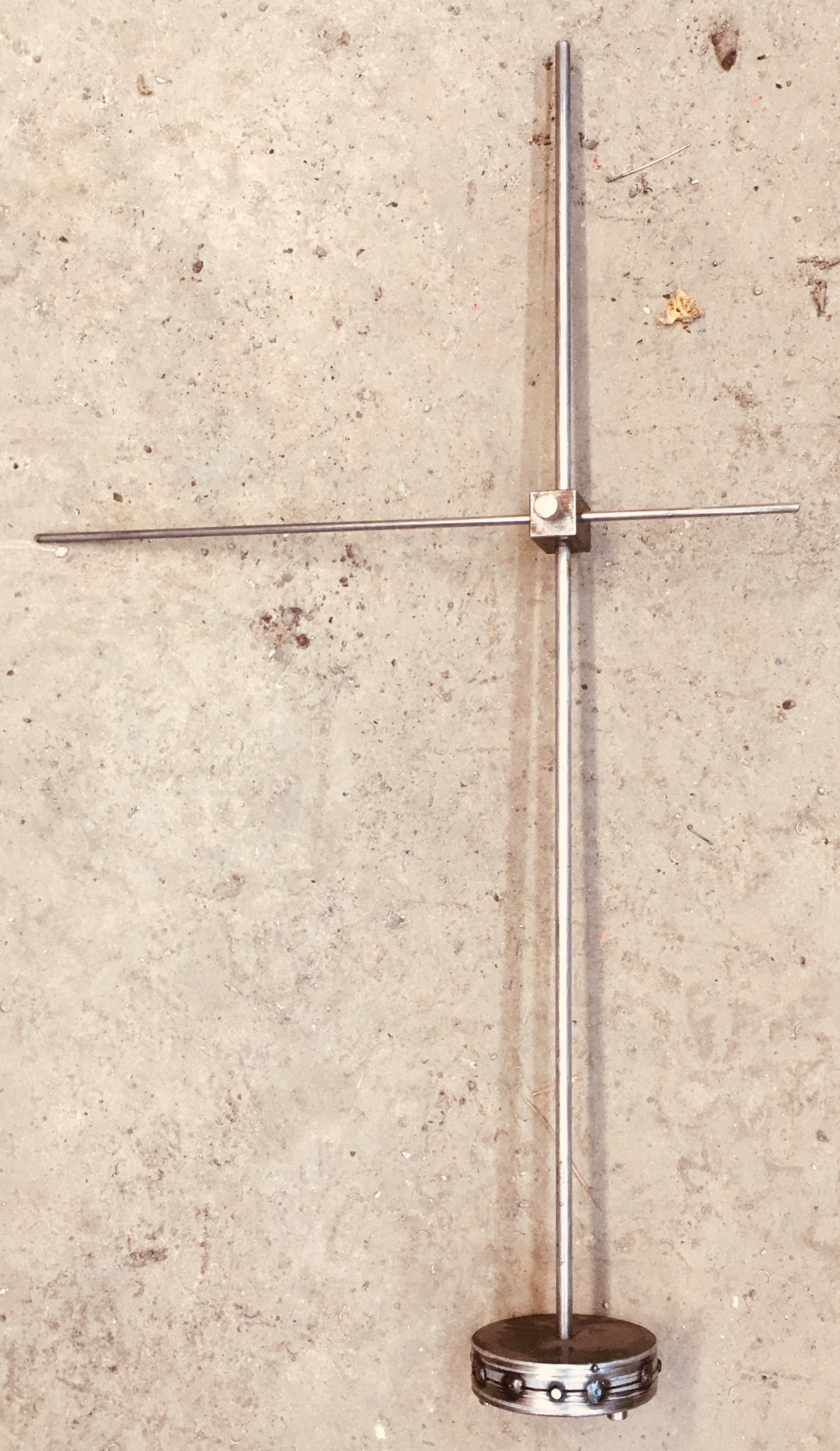

We needed to find a way to start at the very basics and first know that his tractor was sitting level or at least parallel with my concrete shop floor. I quick made a little device to compare the center height of each end of both axles. It consists of two rods (1 vertical and 1 horizontal) with adjustments for the horizontal rod, which fit neatly into the axle’s center index hole. Here’s pics of that device.
Measuring the center height of front axle: With equal pressure in both tires, we found one side was a half inch higher than the other at the center point! How could that be? He remembered having a bad tire replaced at some point and even with the same type tire and equal air pressure the replacement’s diameter was nearly an inch larger.
Measuring the rear axle height: Equal pressure in both tires resulted in one side being quite higher than the other and it happened to be on the same side as that front problem tire. That explained the odd cuts and scalping from mowing on the sloped areas of his lawn in one direction!
With the tool and using different air pressures in all the tires we were able to level the tractor axles with the concrete floor. But now the mower deck was again totally out of adjustment. I noticed one of his deck hangar rods was different than the other side. Asked about that, he said one had been bent so he replaced it and used the threaded portion as a guide to set it the same as the old one. Asked if he had noticed that the threaded portion on the new rod was much longer than the old one……..he of course hadn’t taken that into account. :LOL:
After adjusting the hangar rods to spec, front to back cutting height, and calibrating the height adjustment knob, he reported that the mower cut so nice that even his wife was happy! :ROFLMAO: But now he still has to use my device every so often to level the tractor as each tire requires a different amount of air pressure to accomplish that.

My understanding is that front tires do not change the level (side to side angle) of the tractor, just the height of the front of the tractor with respect to the rear of the tractor. This is because of the center pivot.
"Measuring the rear axle height: Equal pressure in both tires resulted in one side being quite higher than the other and it happened to be on the same side as that front problem tire. "
Rear tire differences will change the level (side to side angle) of the tractor, and perhaps that is the root cause of your neighbor's problem. It sounds like there is a difference between the rear tires as far as diameter goes. The permanent solution may be to do whatever is necessary to get two equal sized tires on the rear of his tractor...
Of course, if the neighbor is fine with the current work around, why spend the money? :)

Wolfman educated me on this topic a while back. If you put a 2x4 board under one of your front tires and lower your bucket to the ground it will still be level. If you do the same to one of the rear tires, it will not be level. Moral of the story, any time something doesn't seem exactly level, check the center height of the rear axle on both sides first as suggested above.
