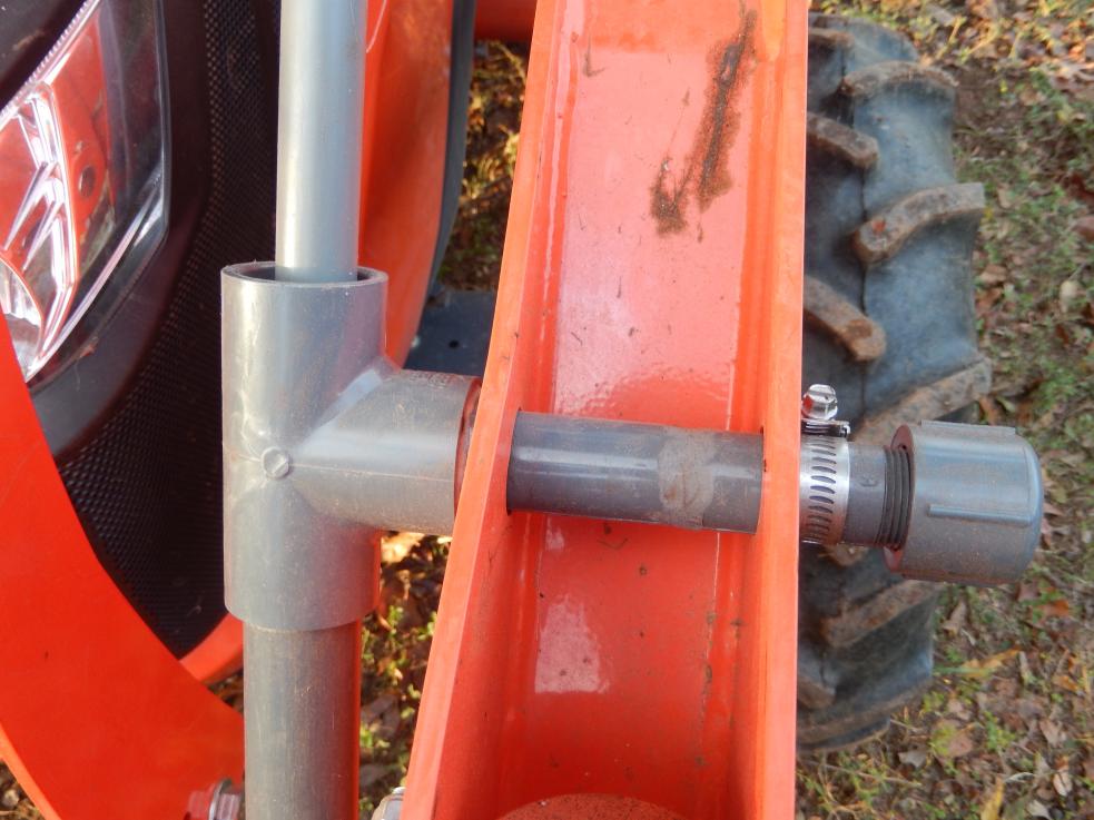

made a simple level indicator for B2601

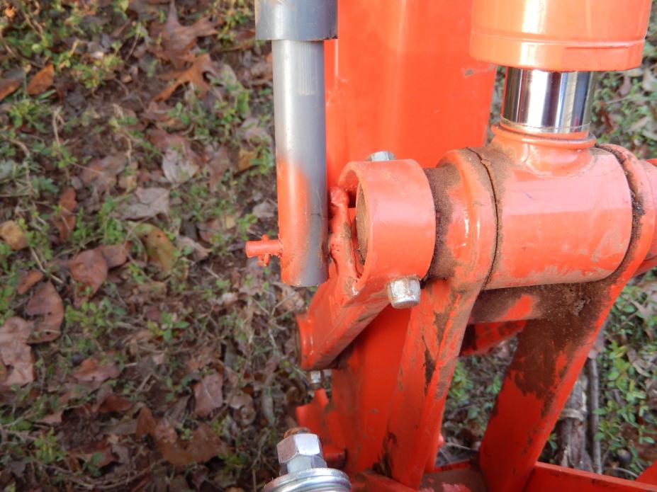

Take a closer picture of the pivot point on the lower cylinder - like to see how you attached to the ram.

Is there a reason that you put it on the outside of the lift arm and not on the inside? I have seen something like that somewhere else using PVC pipe, but yours seems to be a cleaner look. Very nice job, I'll have to look at doing something like that. A lot better than $75 for the one that Kubota sells. Thanks for sharing!

inside has all the hoses.. I have the 3rd function hoses there, too.
had to be on the outside

Haven't used a FEL with a level indicators, so excuse my ignorance:
Does the indicator indicate level only when the bucket is close to the bottom position?

I made a couple marks on the rod.. one when down on the ground.. and another one when higher off the ground.

Just now logging in where I can see photobucket. Very similar to mine except I did it on the other side inside the arm. I didn't think to attach it to the cylinder rod though, that certainly would have been easier, but looking at my pictures now I don't have enough room to do that.
