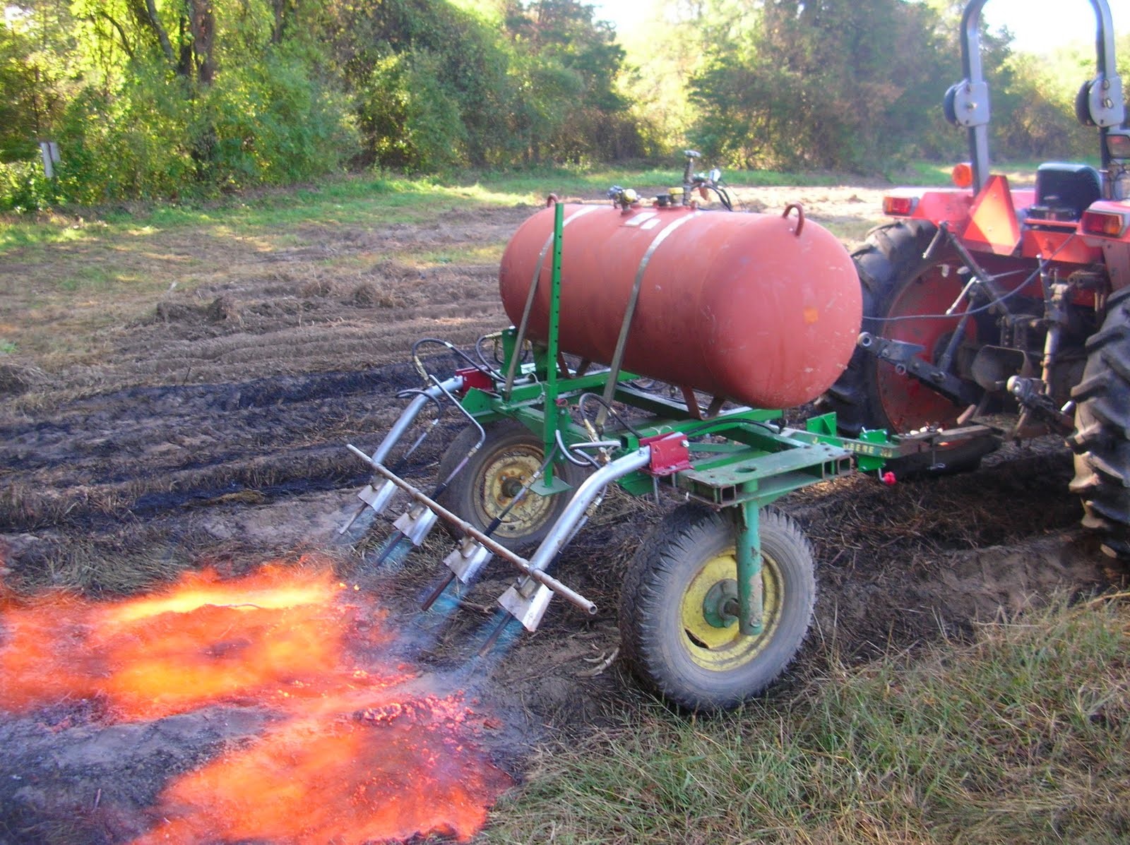

Might be time for a small agricultural flamer. Don’t know what they cost and not an immediate solution, but if it’s an ongoing issue…
Started to post as a joke, but actually when I was a kid one of my winter chores occasionally was removing ice from around the foot traffic areas by the house (people safety) and hoof traffic areas by the barn (livestock safety). I used a flamethrower to melt the ice and it pretty much vaporized the resulting water too. It was kind of enjoyable at the time because it was infrequent and what normal boy doesn’t enjoy using a flamethrower.
