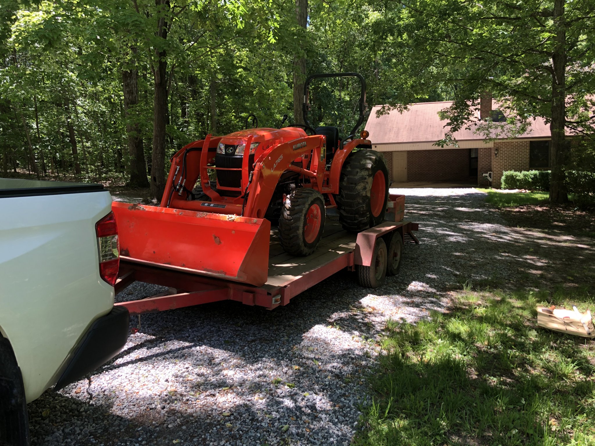

I have a 16’ with a pair of 7200lb axles. It looks big until the tractor is on it. With the loader and anything on the 3 point, it barely fits. I’d say 20’ is a minimum. Attached a few pics on the 16’. I think you can see why I think it’s a bit small lengthwise.
From a weight standpoint, with box scrape, grapple, loaded R4’s, loader, etc. the tractor is running around 6,000lb. The trailer weighs something. A pair of 3200lb axles ain’t going to cut it. Make sure the payload capacity (gross weight less trailer weight) is at least 7,000lb, preferably a bit more, if you have loaded tires or wheel weights. That’s going to put you with a 10K trailer as a minimum.
Will a F-150 pull it safely? Some will, some won’t. Depends on the drivetrain and suspension on your specific truck. My Tundra is rated for 9,999lb. It pulls the tractor quite nicely. Some F-150’s are rated well over 10K; some are rated 5K. Check the specs on your truck and don’t exceed them.
You obviously need good trailer brakes. Both axles. Being able to go is good. Being able to stop is necessary for survival.
Also, at the risk of insulting your intelligence which is not my intent, make sure you always have positive tongue weight. Around 10% of load is allegedly ideal. You can measure hitch height before loading and make sure it drops a couple inches after loading or get a hitch ball carrier for the truck that has a scale built in. Too much tongue weight, the front of your truck will be floating and hard to control. To little you’ll be getting the trailer sway of death.
